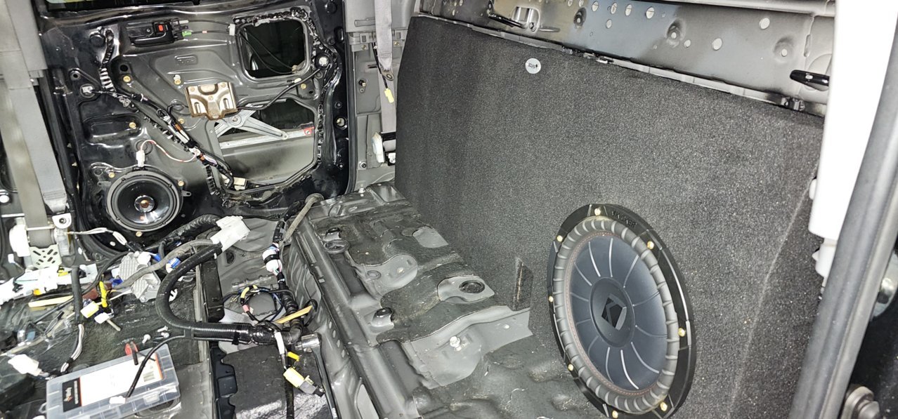

    Are you going to put any sound deading? Wondering if those modules will rattle against the back wall behind that sub.

    If I have any left over from the doors which I bought in excess, it'll go on there. The sub box profile clears the modules so we'll see if anything rattles.

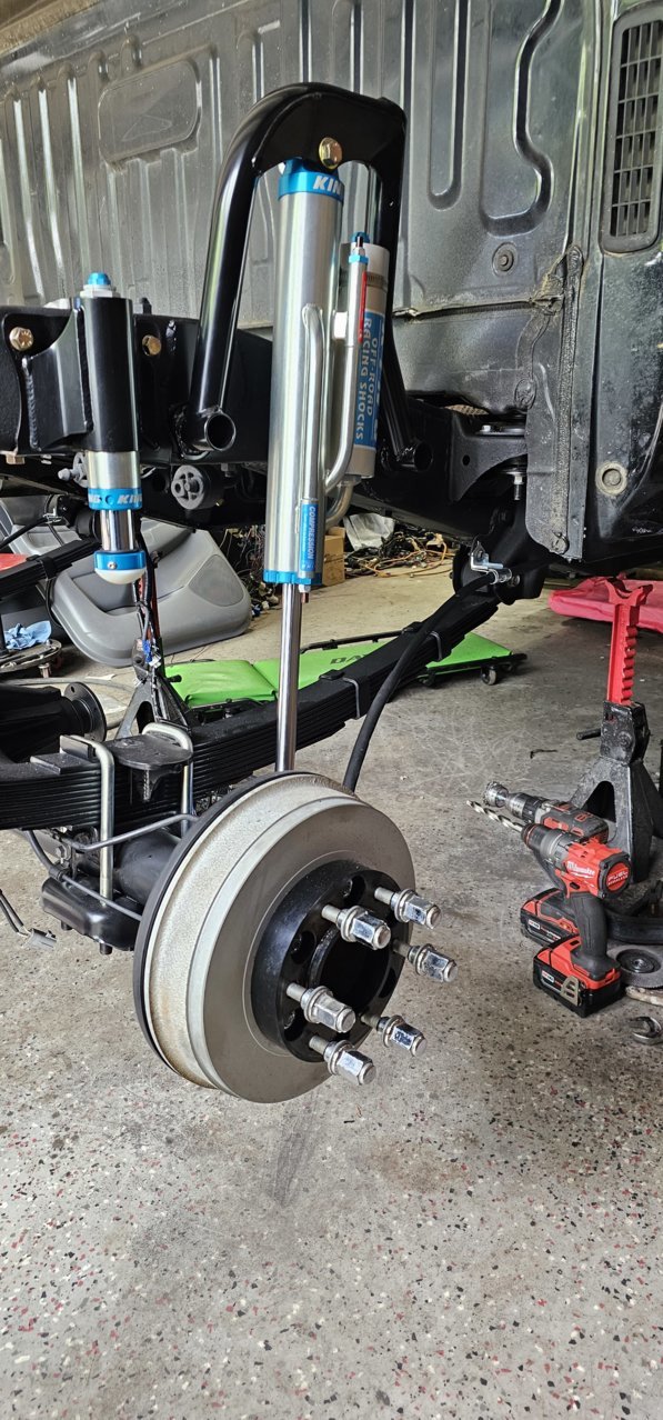

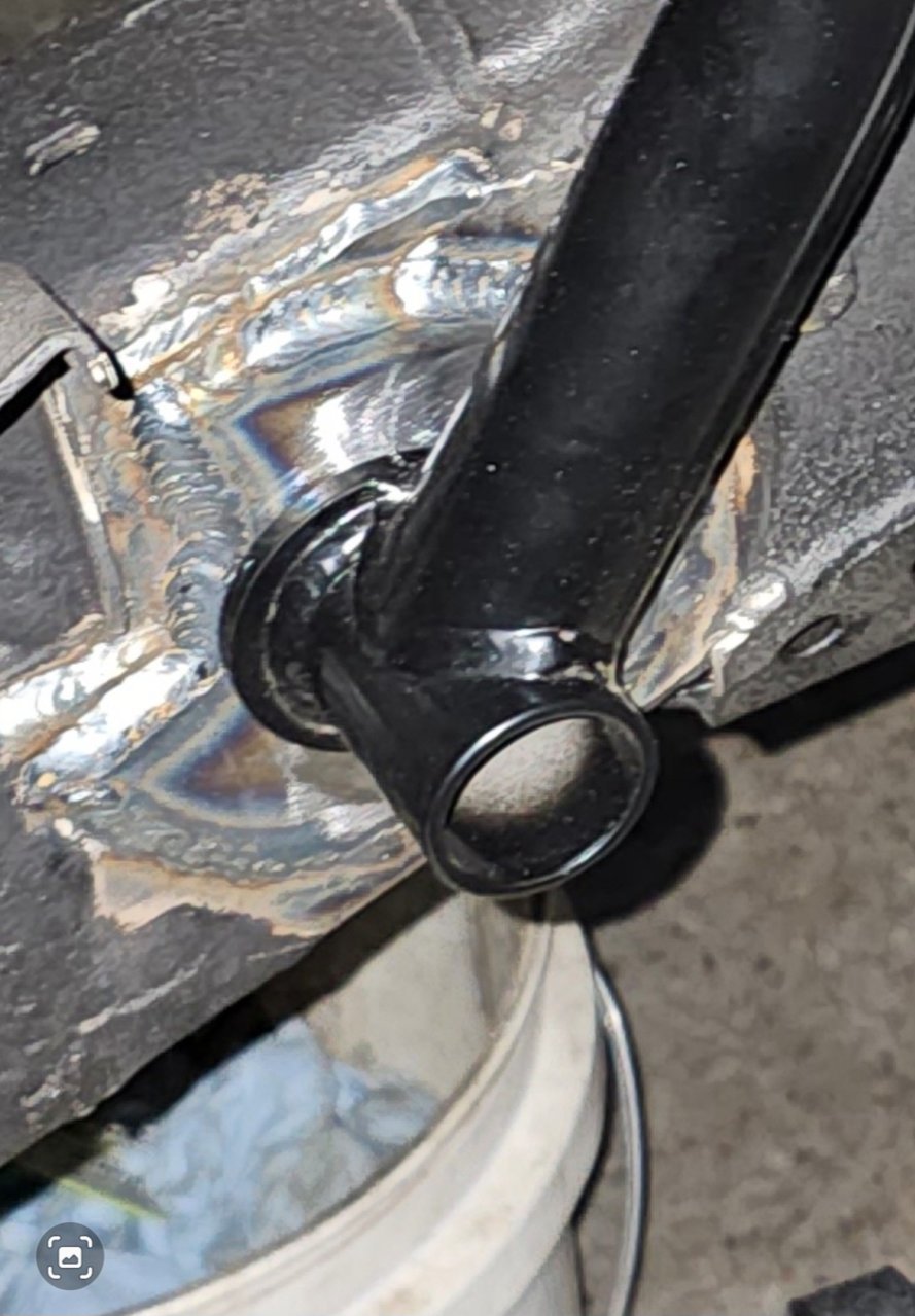

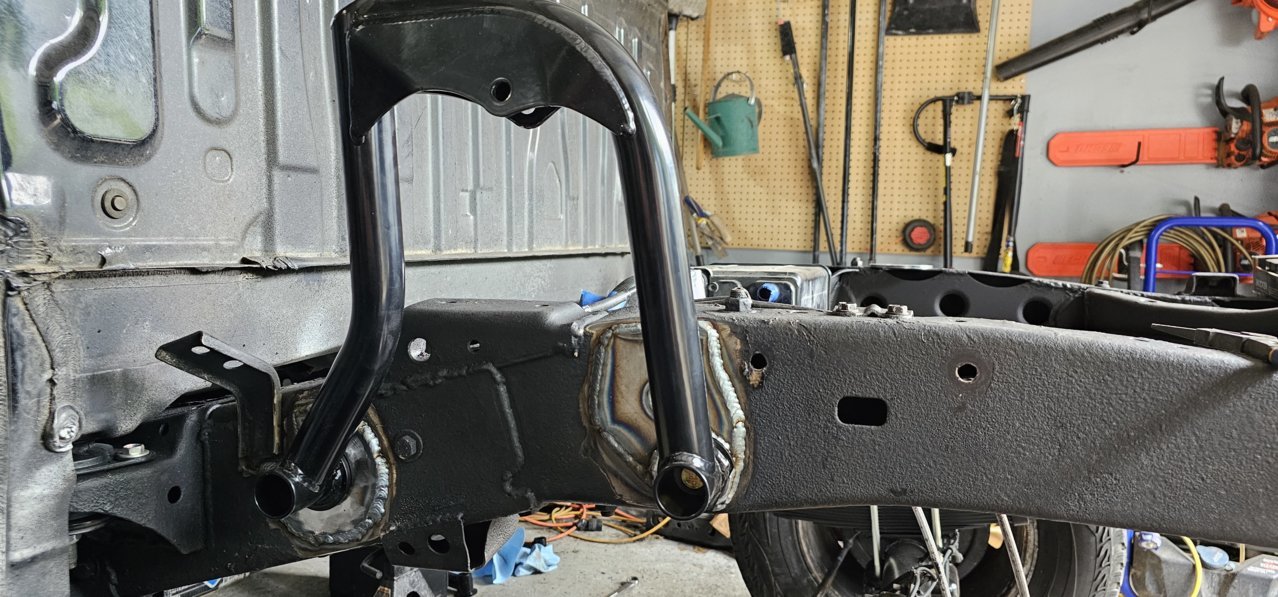

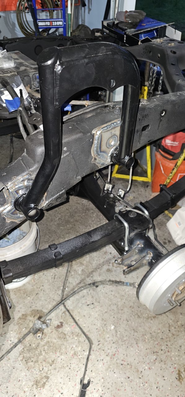

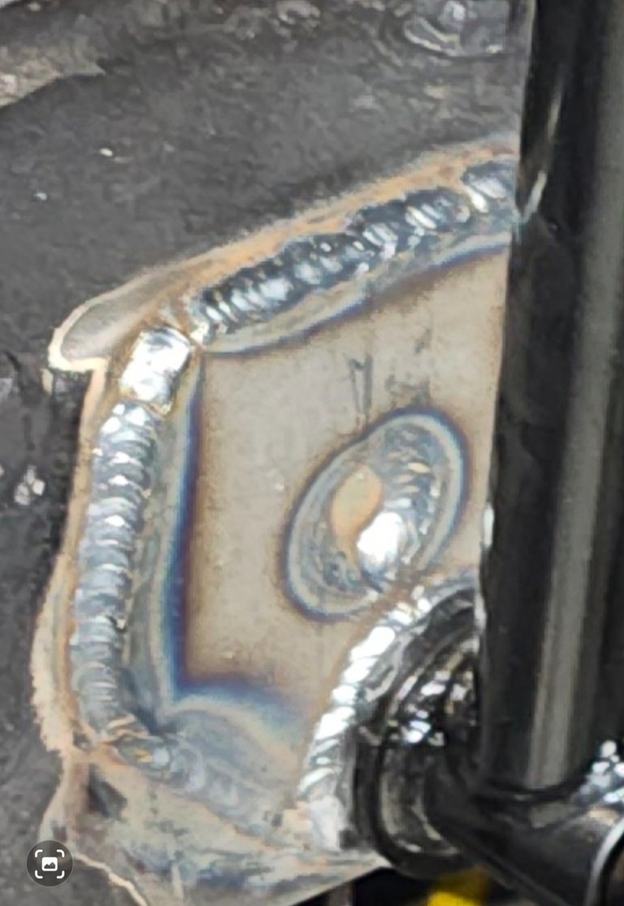

    Well boys I was busy last weekend. I assembled everything, took apart her drums, hooked new parking brake cables and mounted the cables. Can't wait to dial this setup in.

    Any plans for a rear disk conversion?

    Only if I have issues with the Lexus brake booster actuating drum brakes. The drums work pretty good in my opinion.

    The Lexus booster is an electronic booster no? I believe it would be proportioned to actuate the factory discs on all 4 corners. I’d imagine they’re going to work TOO good and lock them up with the current proportioning valve.
    discs aren’t a horrible idea. You have them from the GX don’t you?

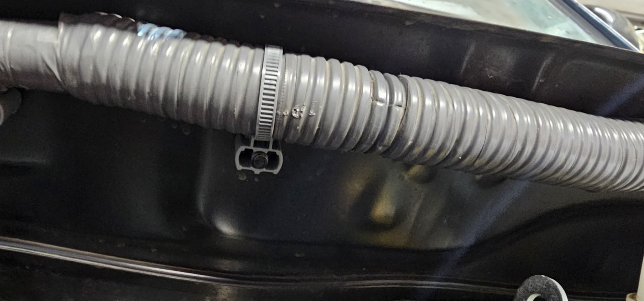

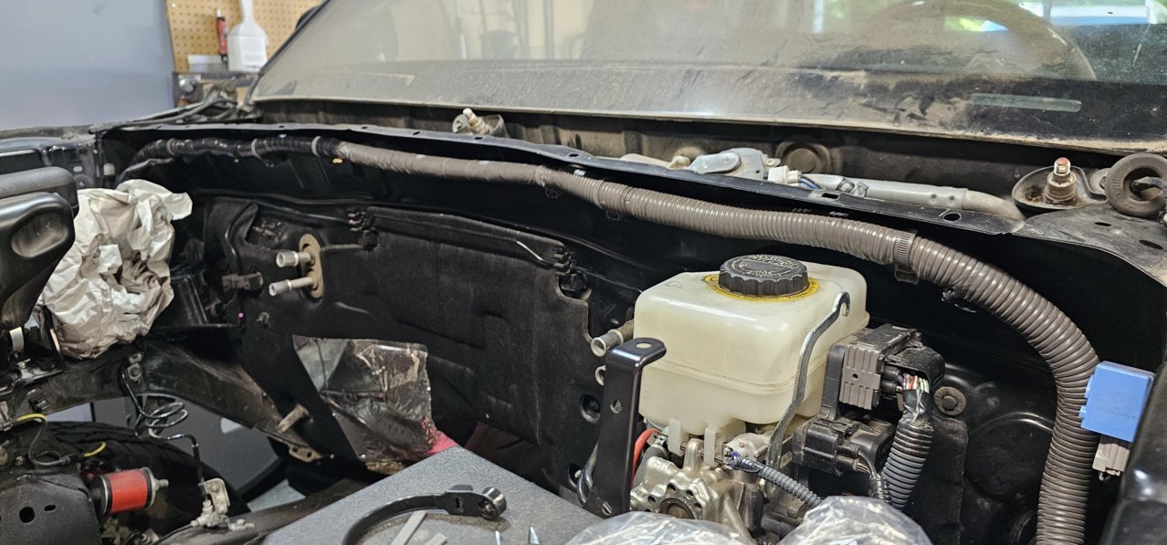

    Well I installed the stud mount zip ties from japan and man they are nice! The snapped on to the stud nicely. The only thing is that they are not as wide as the lexus ones but still feel very solid.

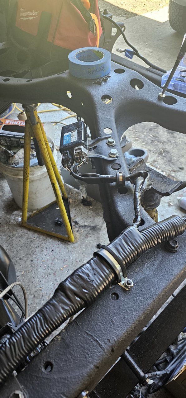

  19. May 16, 2023 at 1:40 PM
    #599
    dpanibratets
    dpanibratets [OP] Well-Known Member
    Sep 18, 2013
    #112778
    571
    Denis
    Vancouver, WA
    2005 DCSB soon to be with V8 1UR-FE

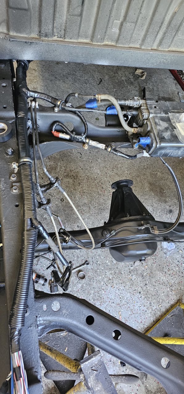

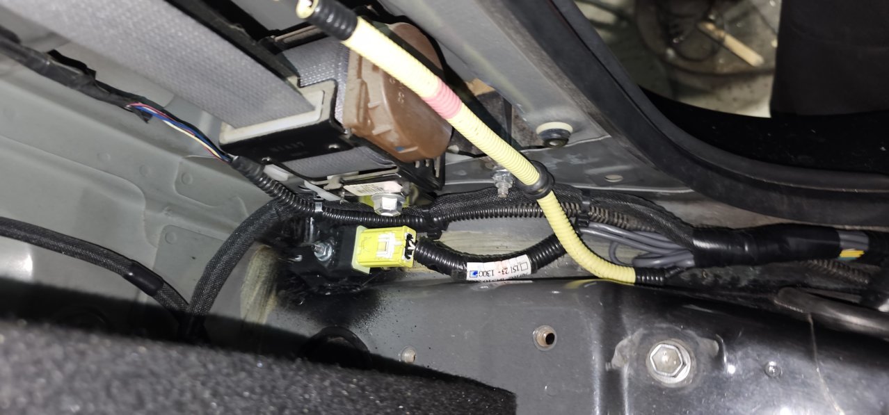

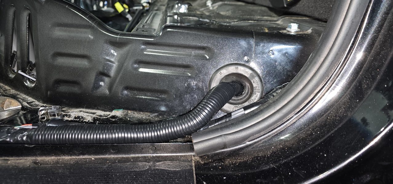

    Evap line, fuel pump, charcoal canister and wheel speed sensor wiring sqaured away.

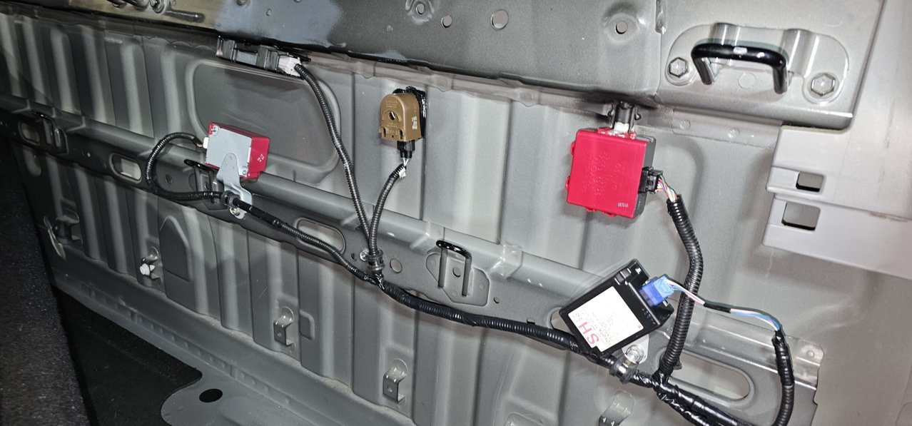

    Fuel pump ecu installed.
