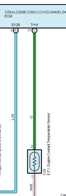

    I looked and the coolant temp sensor from the GX only supplies the ECU with voltage (THW), not a waveform. Could you use the A/C amplifier out of the GX?

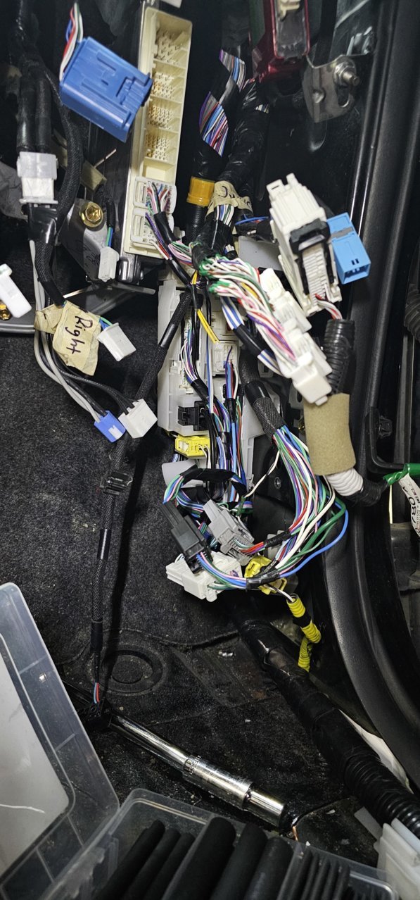

    Got to work on hooking up the 5 channel, this was kind of the only good spot to put it to clear the gx seat when I drop it down about 1.5 inches. I started doing some continuity testing on the speaker wires and found out that the rear right (red and white wires) speaker didn't have continuity. The media harness runs up to where the cluster connects. I checked up there to see if I jacked something up only to find all the speaker wires except right rear "No. 2" speaker lol. Turns out they decided to run this speaker wire to the tailgate on the left side harness, connect it to the right side at the right rear quarter panel. I connected the plug on in the last picture and it has continuity now lol. What a cluster that was.

    Also I started to work on organizing this mess, still lots to do.

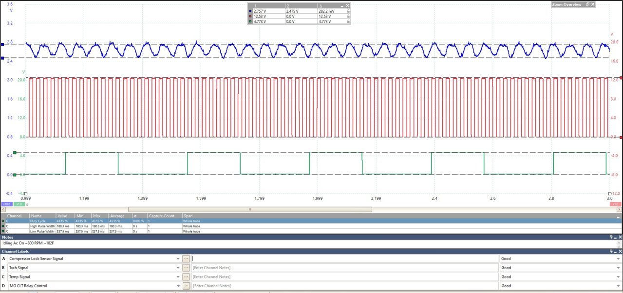

    I put the scope on my A/C Amplifier signals today, here's what they look like. Note the Lock Sensor signal is scaled x10 as it's a very small signal (~300 mV peak to peak).

    What do you think the potential consequences are of just getting a pulse wave generator to generate that pulse for coolant temp? This would be without actually having any coolant temp input.

    If you generate the correct signal I don't see why it wouldn't work, I'm pretty sure all it's there for is to disable the A/C in the event of the engine overheating.
    That signal shown is with the engine temp at about 182F

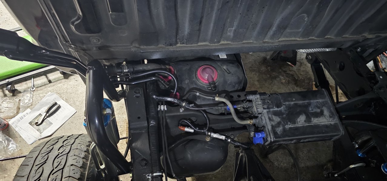

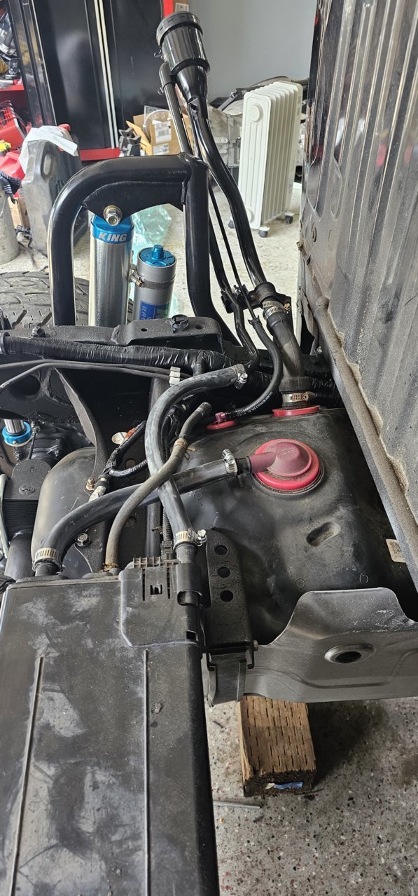

    Here's the gas tank all hooked up.

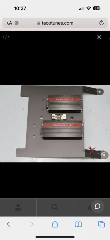

    You concerned about blasting the HVAC vent directly at the amp? On colder days with the heat on it seems like that would get quite warm if the floor vents were active

    I use this Amp Rack from *********.com and it allows the floor vent to work well for the back seat and doesn’t seem to impact my amp temperature….as an idea…
    See picture header for where… it’s in the Tacoma, then Amp section of their online store.

    My amp has been sitting over the vent for about 5-6 years, play my music loud daily without any issues.
