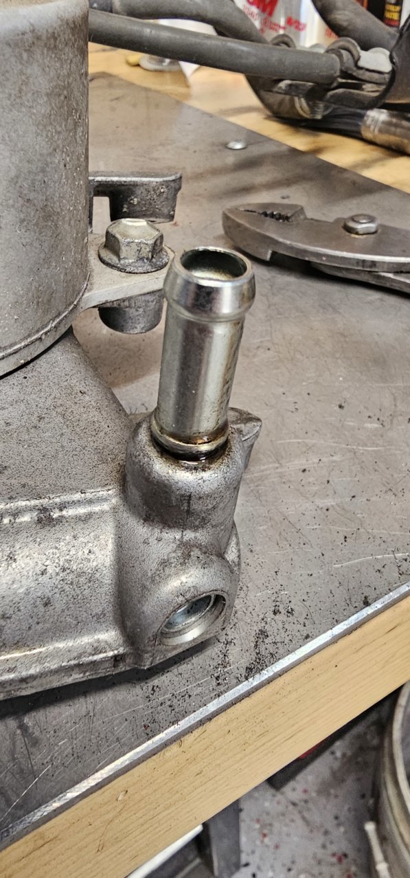

    You could tap it as with the piece facing down so gravity could help a little.

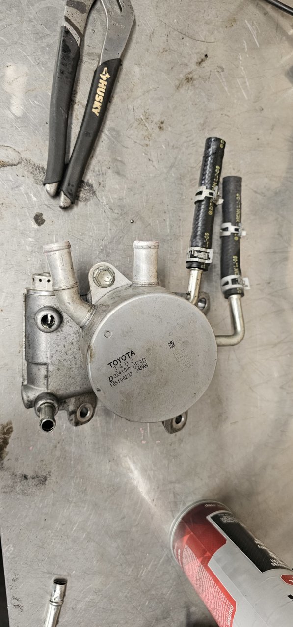

    Is it a thermostat? (i have no idea here) Or is it just a transmission cooler like things say? If the latter, just install a normal trans cooler at the front - probably be better off.

    Looks like a 12mm press-in hose barb.

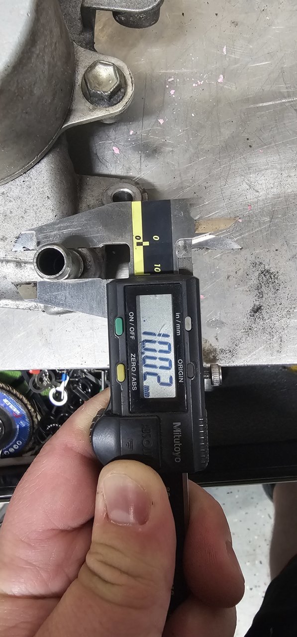

    It is a 10mm OD and 8mm but yes I am just trying to find where to buy one now.

    This is a transmission cooler and warmer assembly. The thermostat allows atf fluid to flow to the radiator assembly for cooling. I think thats how it works.

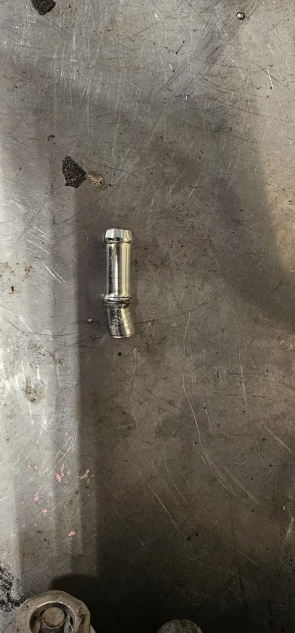

    JB weld? Or is that bend not supposed to be in it?

    Yeah it was bent by forks from the forklift.

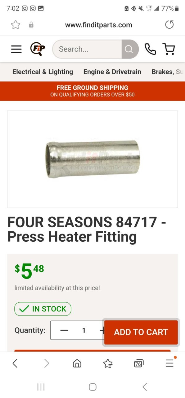

    Almost found it, just need to find the right size. Their catalog is not very user friendly.

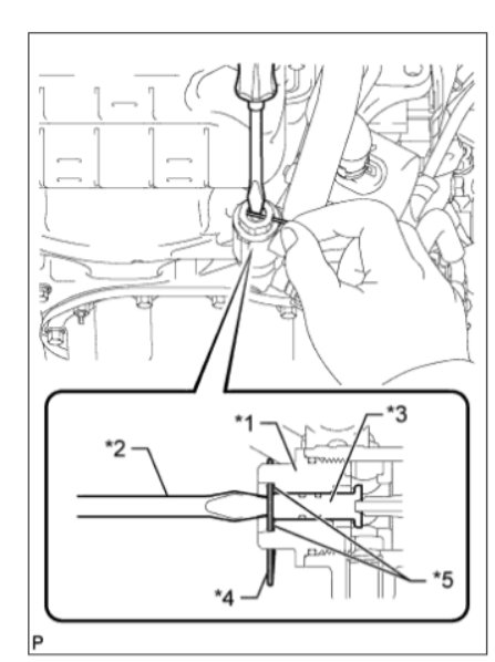

    Unless there is a sensor in the thing telling the ECU something, it seems like deleting it would be just fine. From what I browsed the thing may not let your trans fluid to the cooler until its around 200 degrees. I think thats terrible. Heat kills trans fluid over time.
    found here: https://www.clublexus.com/forums/gx...transmission-cooler-install.html#post10761642
    I guess a lot of guys keep them pinned open so itll flow below 200 degrees by pushing the valve in and inserting a paper clip or pin.

    Nice work. Interesting thought too, some transmissions don’t open certain passages until they are at or above temperatures. @gearcruncher might have some insight too.

    I had added a Hayden 679 to my 4.0 and it dropped temps by 40-50 degrees. Now, if that keep the fluid a little on the thicker side and I am not "Consequently, reducing my friction losses for better MPG", then thats definitely the lesser of two evils.
    Just thinking out loud as i have been thinking of adding a GX to the stable some day....Will probably see if this gizmo is more harm than good just to get better MPG scores. I appreciate this thread for bringing it to attention.

    On a build like this , i dont think the op will be concerned about fuel mileage . As others have mentioned , the transmission will work fine if you file the thermostat under " G " , then throw a huge cooler up front .
    Thats what I would do
