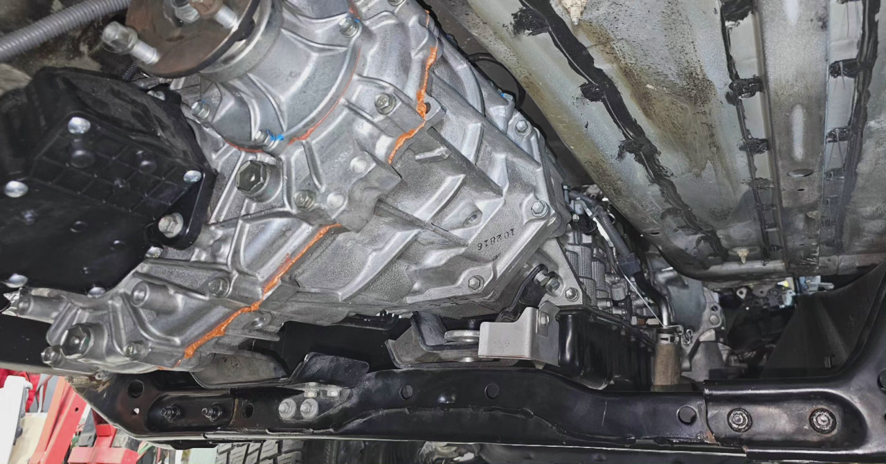

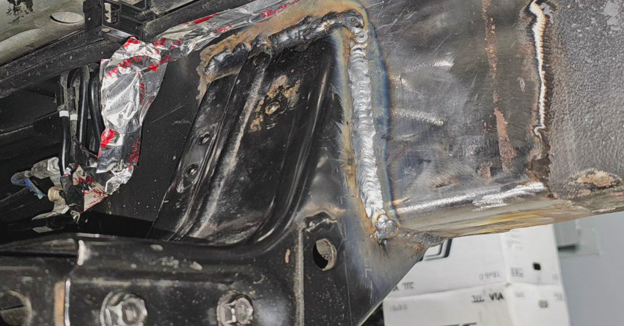

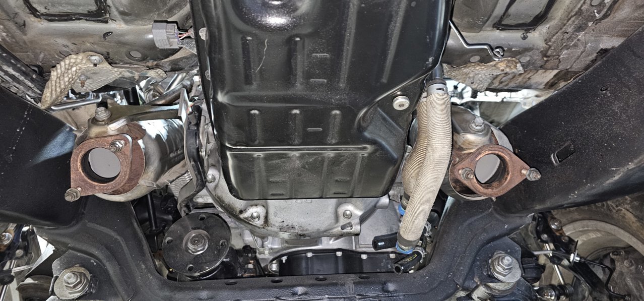

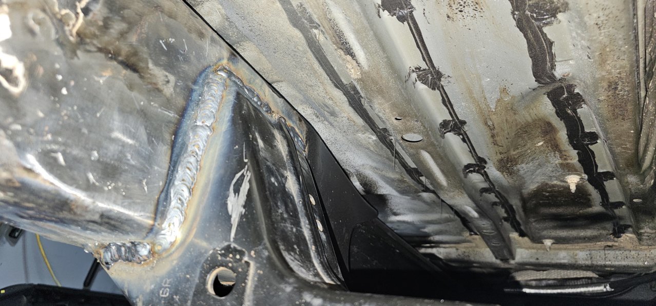

    Well I certainly appreciate the words of encouragement. I have been busy on the project certainly. I got the transmission crossmember welded in last weekend.

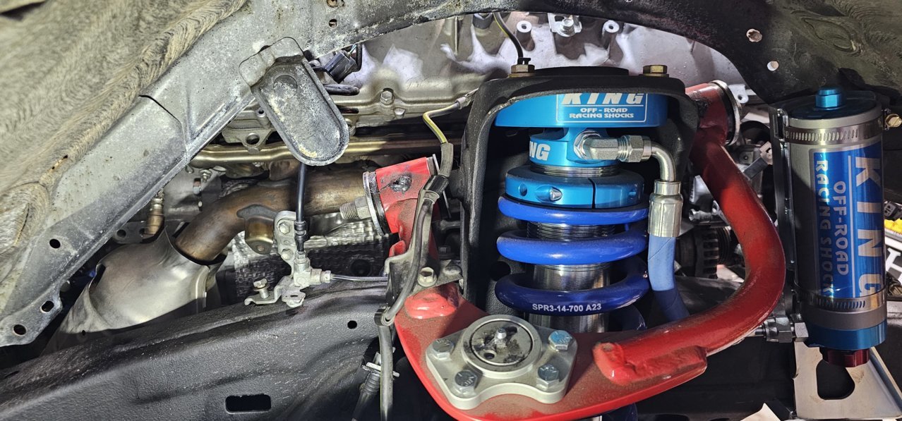

    I got the starter installed and connected. I literally just got done installing the right side exhaust manifold and put the shields on. Currently I have to finish installing the exhaust, button up the top of the engine and give her some juice! I hope it will recognize the wireless key.

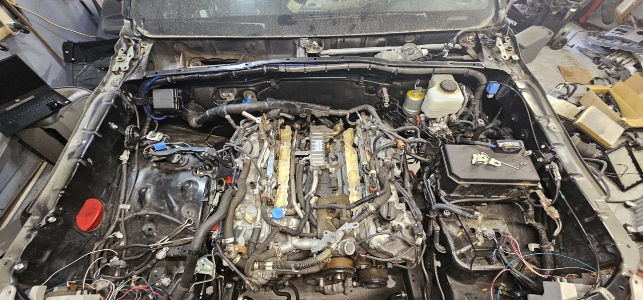

    I got the spark plugs and ignition coils installed. Here is the current state of the top of the engine. 20230731_124759.jpg

    Have you mounted the ECU yet? And repinned the body side plugs for it?

    Yes I have mounted the ecu. And no repinning required because I just rewired the whole body with lexus wires.

    Did the ECU bolt in to the factory location tho?

    No I had to modify the gx460 ecu brackets but basically I put it in the same spot so all the wires line up nicely.

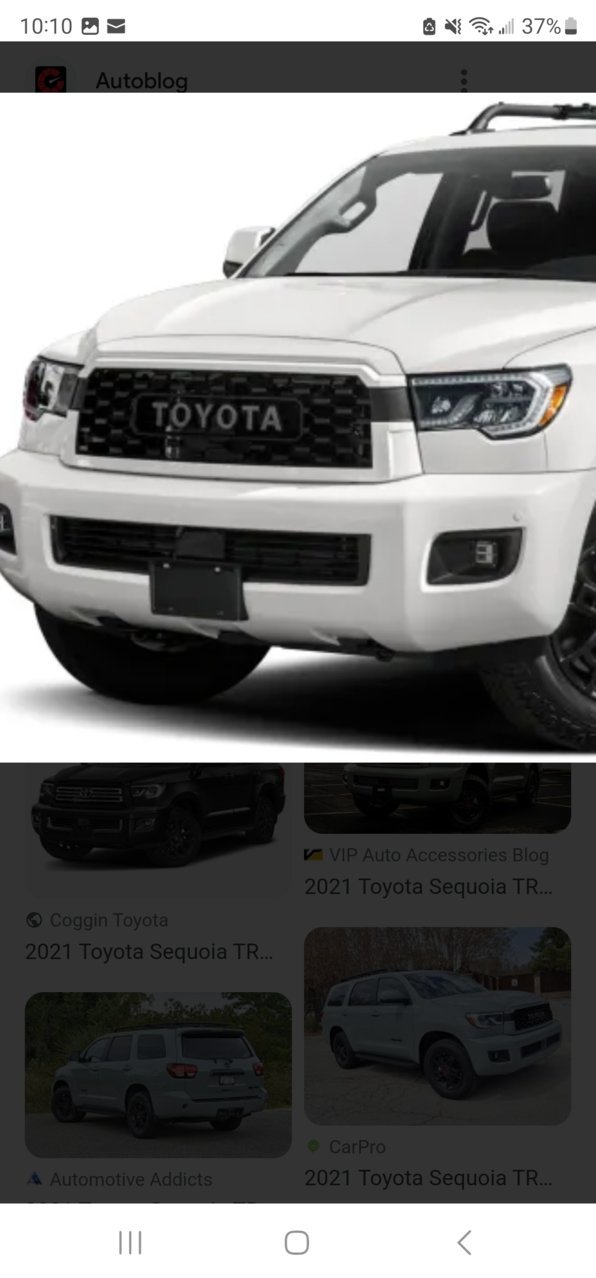

    2015 Limited, 5.7 3UR, 68k miles, clean title. I am going to do all the service on it including entire transmission fluid change and will be upgrading to 2018+ front lights and pro grille. I picked up forged trd wheels wheels made by bbs for $1300 on marketplace which was a great deal.

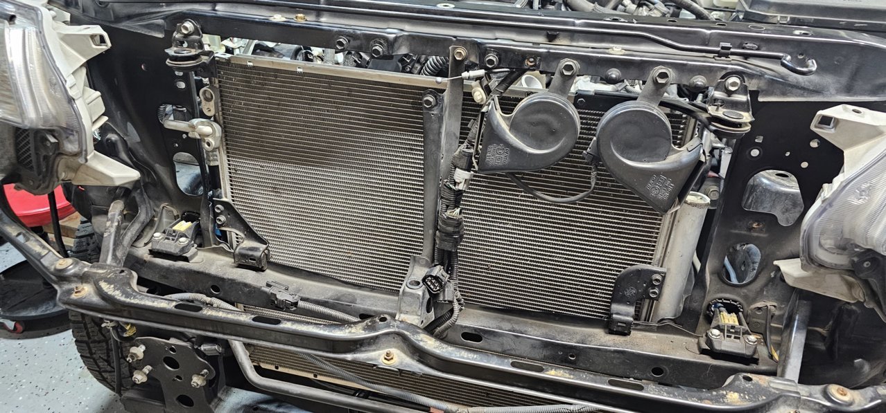

    Hey guys,
    As you can see here the AC condenser bolts right in also but it appears that it is about 1 inch too high. The ac line will not hook up to it. The name of the game is saving money anyway I can and I can modify the tabs to lower the condenser with my welder rather than make new lines. I'll be doing that today. Also I could've done myself a favor by moving the engine back about 1/2 inch because of the CSF radiator. Now in order to mount the fan, the serpentine belt has to go on, the fan goes on with shroud and then the radiator goes in. Otherwise there's not enough room to get the fan flange over the studs. An oversight on my part but there's a workaround.
