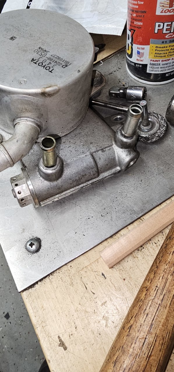

    By the way this worked! It measured 10.02mm also and pressed in tightly. The only thing is that the "barb" on it is not quite wide enough for the factory hose clamp to grab on to. I'll grab a couple of stainless clamps at the hardware store and that shouldn't be a problem.

    Good to know.

    glad i could help!
    material procurement was my position at my last job. :thumbsup:

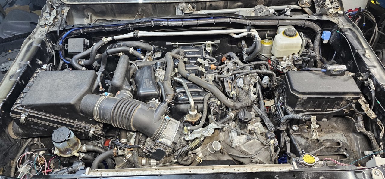

    I started putting fluids in today! We are very close. I am hoping to check all grounds tomorrow and put the battery in. It'll be exciting to see if it unlocks/locks the doors.

    Sweet! Can’t wait to see it! Roll your windows down. Don’t accidentally lock a key in the car, lol.
