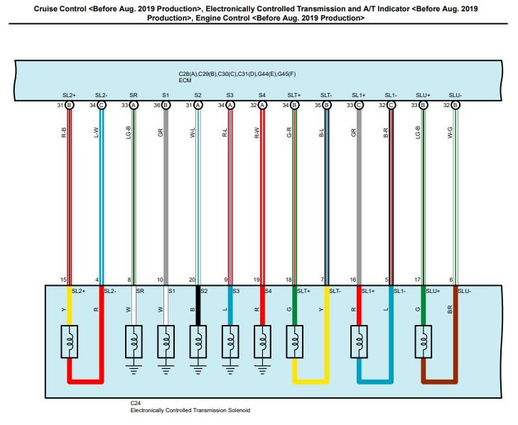

    I am trying to sort out these codes, I am a bit suspicious of the of a bad connection if all of them come on at once.

    There doesn't appear to be any other connections between the PCM and transmission so you must either have some broken wires or pins not making contact.

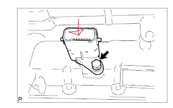

    Yeah, 1 step in the diagnosis is to check the transmission wiring harness inside the pan. I really hope it's not the main harness.

    It's a long shot but this transmission was laying in my garage all winter long with lots of grinding/scaling and wire wheeling. It is possible that ferrous dust is causing shorting here because I didn't think to tape it up. I will disconnect the plug tomorrow, inspect it and hit it with some compressed air. Check the to see if the DTCs go away. if not, then the pan is coming off. It sucks because I just installed the front drive shaft and this connector is on the left side of the tranny.

    It could be the connectors just not seated all the way either. I guess if you wanted to test the harness without pulling it, you could get some test leads and test continuity between corresponding pins.
