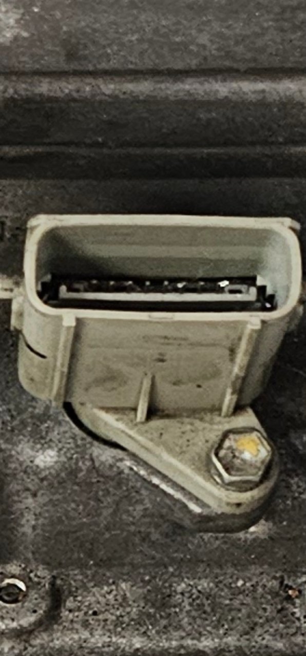

    This is the only pic I have of the plug right now and those pins look off to me.

    I fubar'd the main engine room harness on my old lexus and with how much shielded shit is in there, it made me nervous to repair it, also considering it was 14 hours of labor to change that wouldn't be warrantied if I repaired the harness. It was a scary experience, and a lesson learned the very hard way.
    I dont imagine you fubar'd your harness, I reckon the connector is probably filthy. after you get it cleaned, might be worth it to fill it full of dielectric grease.

    Yeah, a couple look a bit smushed, but hard to tell. But just the fact that all the codes seem to be closely related points to a connector or wire issue. You'll figure it out.

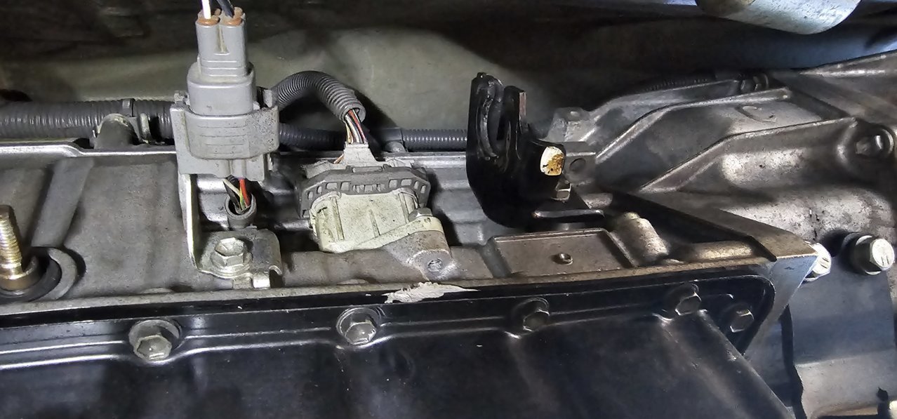

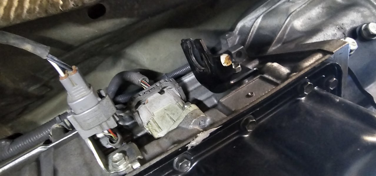

    I think you were on to something again. Dtcs are gone and so is the CEL
    Plugged in
    Not plugged in
    not_nick, mtskibum16, saf023 and 4 others like this.
