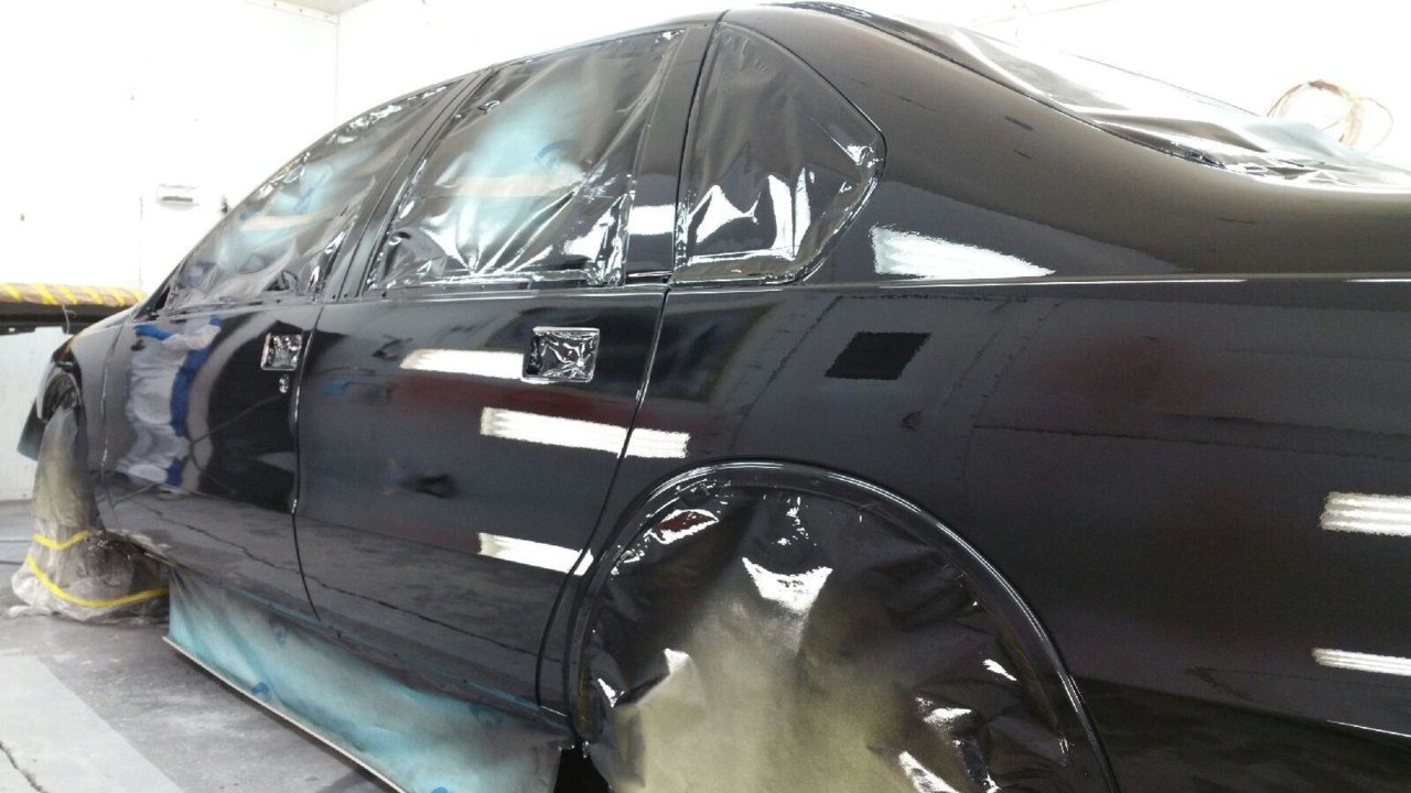

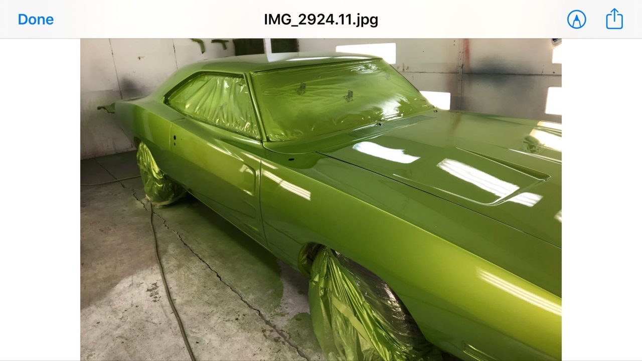

    Yes, I will be painting caviar. I have a friend at work who paints aircraft parts and used to paint aircraft. He said it would be 4-5k depending how much body work he has to and cost of paint. Here is some of his work. He is very meticulous and said that his process will take several months. It is not a turn and burn shop, this is something he is passionate about which is exactly the type of job I am looking for.

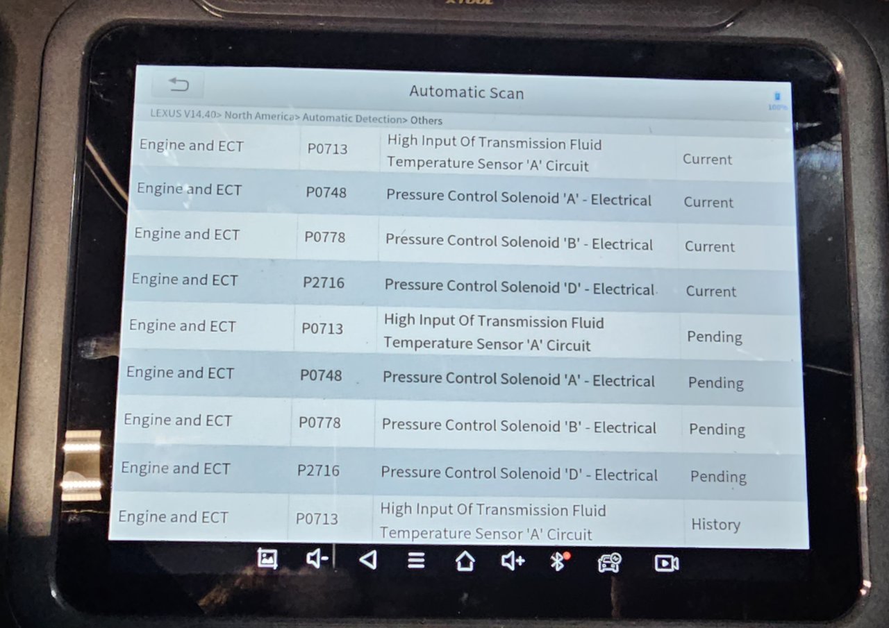

    How do you get your OBD2 in your android radio?. I haven't found any OBD2 app compatible with android auto.

    That's a scanning tool, not the radio.

    It is not my android radio. It is an xtool diagnostic tool tablet.

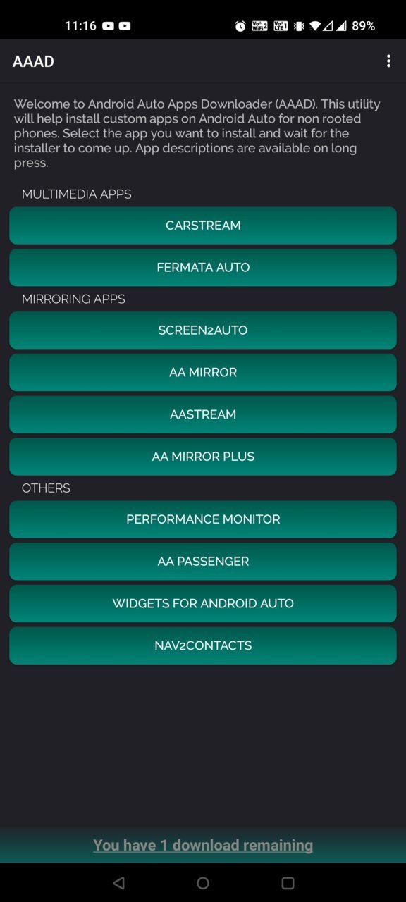

    Look into AAAD.
