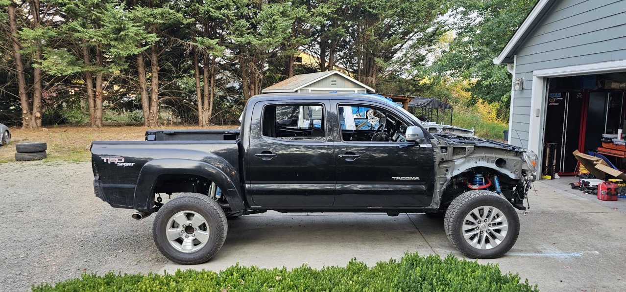

    Starting to look like a truck.

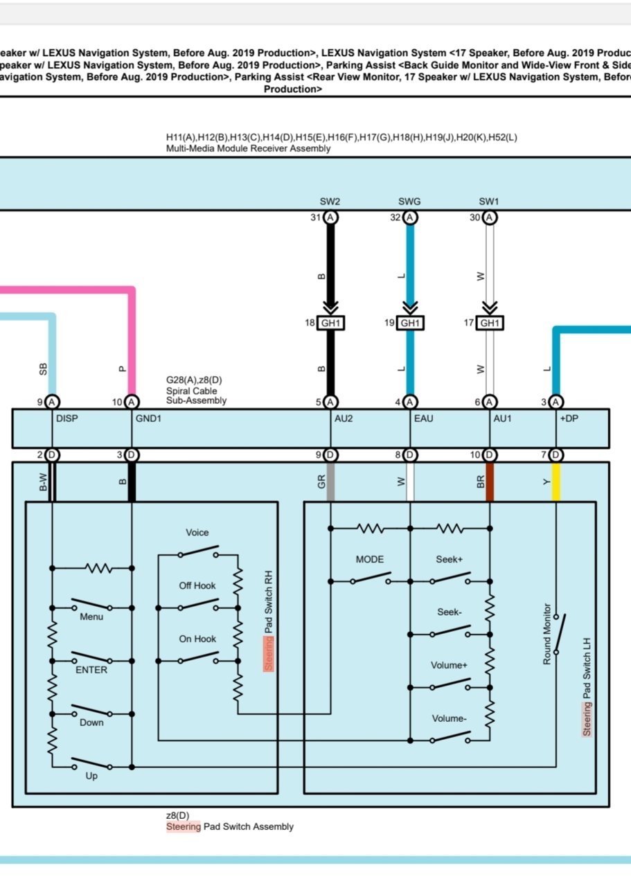

    Today I was trying to wire up a maestro SW module to gain steering wheel controls to my Pioneer deck. I wired up the SW1, SW2 and SWG to the corresponding wires on the maestro. It didn't work. I immediately thought I installed something incorrectly, hours later of trouble shooting I realized that my clock spring spiral cable was torn lol. I found that out by checking continuity on it. I got on car-part and found out that these are cross compatible from a 2016 scion TC. I am definitely not paying 500 for a new lexus one. I will order one up on monday.
