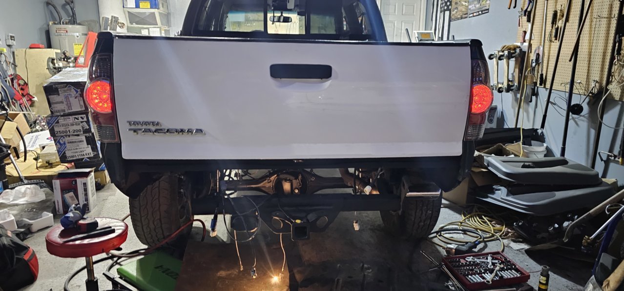

    Well I ordered up a clock spring. Extended the taillight wires and mounted them to the factory locations. Taillights and license plate lights work. Put the taillights on. Right now I am working on getting the dome lights wired up. Along with the auto dimming mirror and rain sensor.

    I got the clock spring installed, from a 2016 TC and it works. My steering wheel controls work. Dome light works, fades on and off. Reading lights work. Auto dimming mirror works. Rain sensor is wired up. Just minor laundry list stuff getting done.

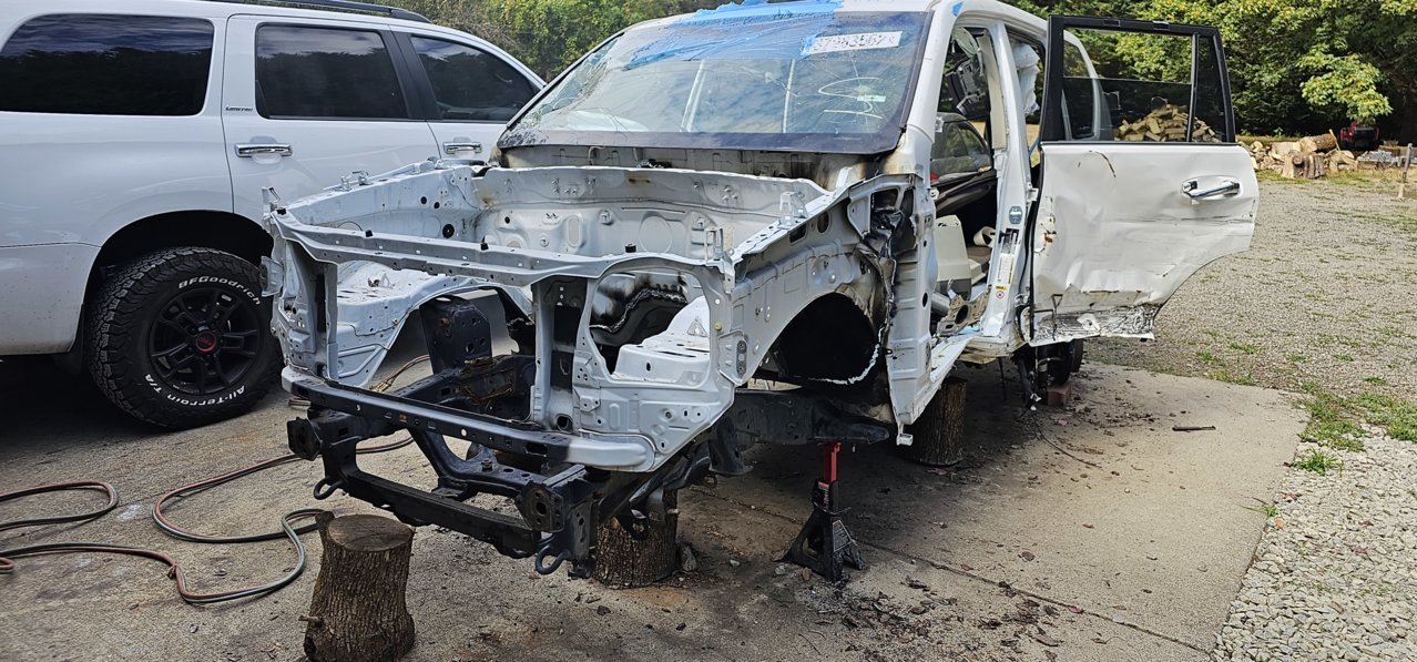

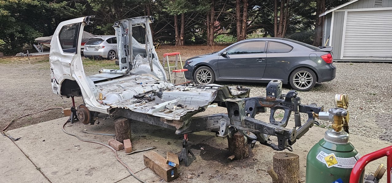

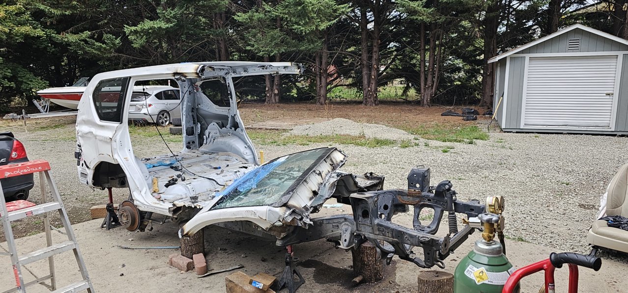

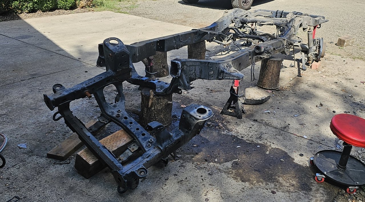

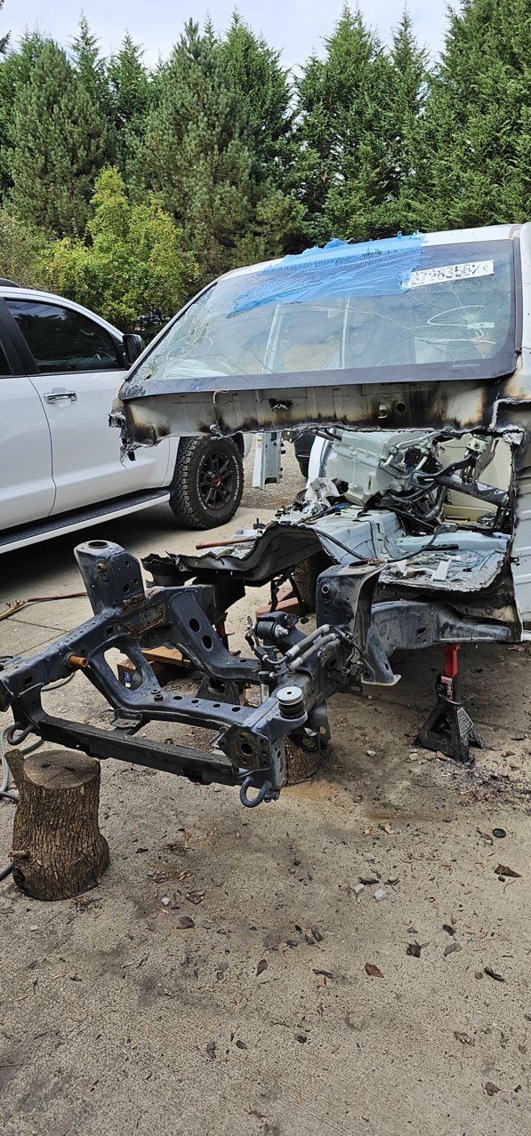

    Started cutting up the Gx yesterday.
    20230912_144428.jpg 20230912_145407.jpg 20230912_175223.jpg 20230912_191938.jpg 20230913_124043.jpg

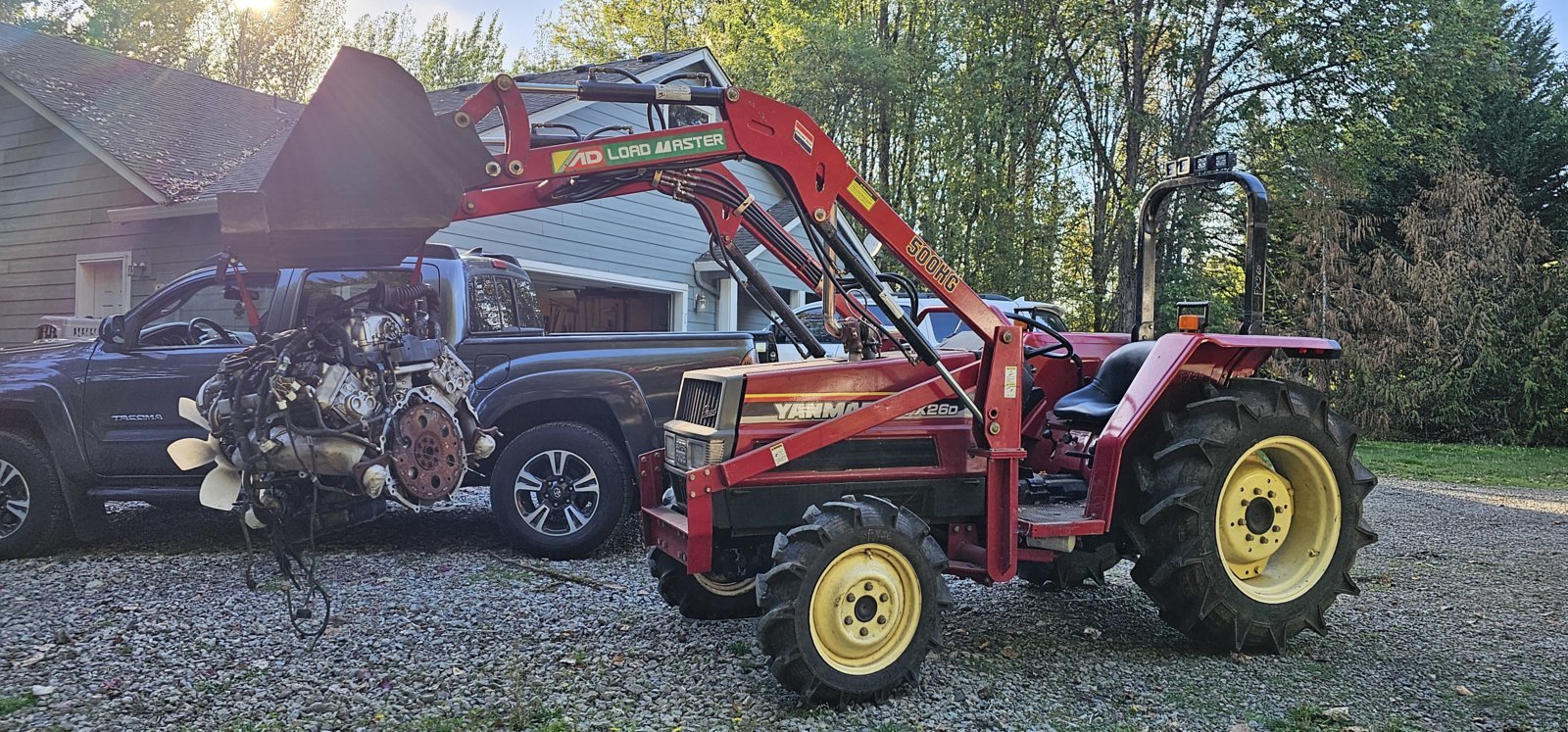

    Not quite there to the painting part. Actually I have been busy getting the house ready for winter. Some of you may have noticed that a Boat has appeared in the background. We picked up a 1999 Toyota Epic 22, I am very pumped about that. It's from Texas and the previous owner didn't winterize it from 2 years ago. It has a cracked block. It came with a 1uz-fe VTT-i. I picked up an engine for it. Now that it started raining, I will have a lot more garage time and things on the truck will move along but I am also constrained with funding now lol. There are plenty of things to do without spending money so I will keep working the laundry list.
    I need to figure out why the DRLs aren't coming on. I think I wired the DRL light to the correct pin on the tacoma bulb.
    HVAC after that...
    And SRS/front seats after that.
    Once those two are done, the interior can get buttoned up.
    20230910_074741.jpg 20231008_164503(0).jpg Screenshot_20230925_140728_Gallery.jpg
