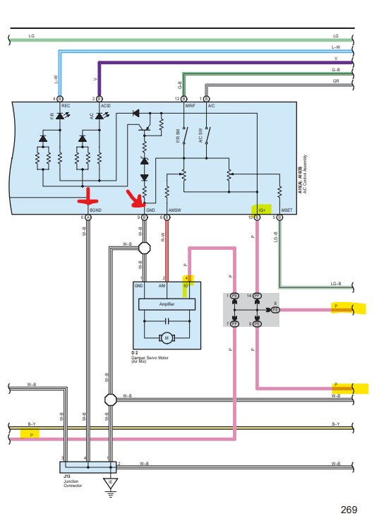

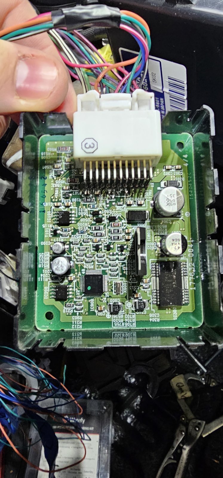

    Well I got the blower motor working, hot/cold blender works. However my air direction selector and recirculation worked for about 5 minutes and now they don't. All of my grounds are connected, I hope I didn't fry anything. I checked fuses from my power sources and I didn't pop any of those. I am kind of puzzled about this.

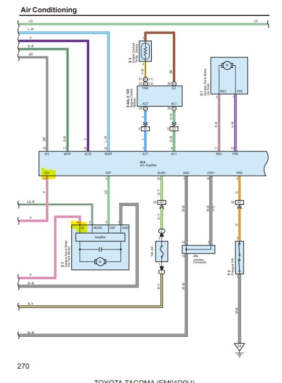

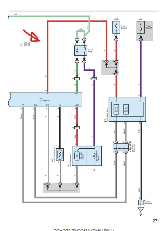

    Yes, soldered all the pink ignition wires on the tacoma ac amp diagram to this blue 10 amp ignition source. Additionally I grounded all grounds and connected the switches. Also I connected the red wire pin 24 on the AC amp to the same source ignition source. It doesn't appear like I fried anything in the AC amp. I am going to double check my grounds. Whats weird is that the temperature control servo works but the other two don't.

    Today I checked continuity on all the grounds in the ac amp diagram and they all check out. I disconnected the power to the ac amp, set the mode selector switch to "face and feet" reconnected the power and everything works. Additionally I observed that last time the servos got stuck on windshield defrost. I suspect it got stuck because I don't have anything hooked up on the AC side yet. It was probably waiting for an ac signal of sorts. I think I read that on @Dm93 page somewhere. Anyway, the mode selector works fine on "Face", "face and feet", "feet" and recirculation works again.

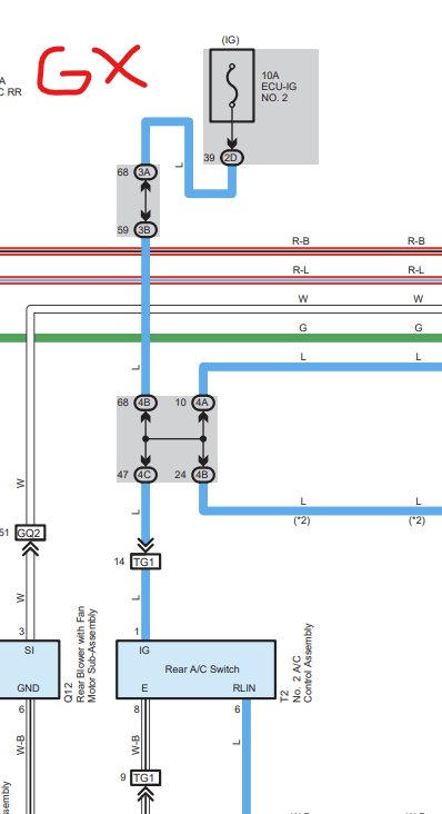

    Working on getting the AC lines sorted out. The lines to the rear gx ac evaporator need to be capped off and the fittings to the tacoma evaporator need to be soldered on the gx lines. Also I noticed the gx AC pressure sensor has 3 pins where the Tacoma just has a simple two pin ground circuit. I am just going to use the tacoma pressure sensor since I am using the tacoma AC Amplifier. I will use existing wires though just so that it's cleaner.
