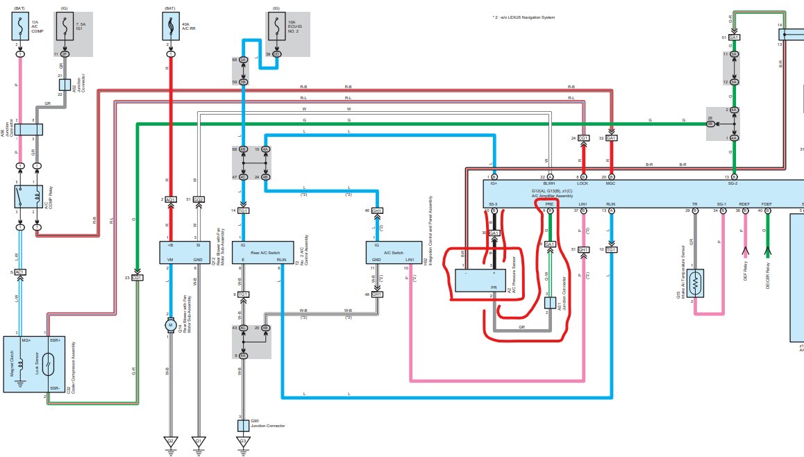

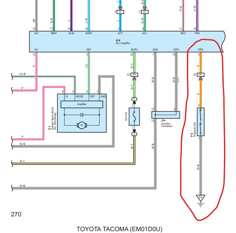

  17. Nov 7, 2023 at 12:36 AM
    #1017
    dpanibratets
    dpanibratets [OP] Well-Known Member
    Sep 18, 2013
    #112778
    571
    Denis
    Vancouver, WA
    2005 DCSB soon to be with V8 1UR-FE
    This is what I am talking about. On the Tacoma it appears it is just a ground that gets connected or disconnected when the pressure meets a specified amount.
    And on the GX you get this mess. (see below)
    What I was thinking is this:
    Green wire pin 9 disconnect from GX ac amp connect to Tacoma AC amp Orange wire Pin 5.
    Black wire pin 10 disconnect from GX ac amp and connect to ground.
    Install two pin pressure switch from Tacoma at the end of both of those wires.
    What do you guys think?
    mit88 likes this.
  18. Nov 7, 2023 at 10:16 AM
    #1018
    Jeff Lange
    Jeff Lange Well-Known Member
    May 19, 2015
    #155616
    2,269
    Calgary, Canada
    '86 AE86, '05 NCP13, '11 GSE21
    This sounds like a good plan.
    Jeff

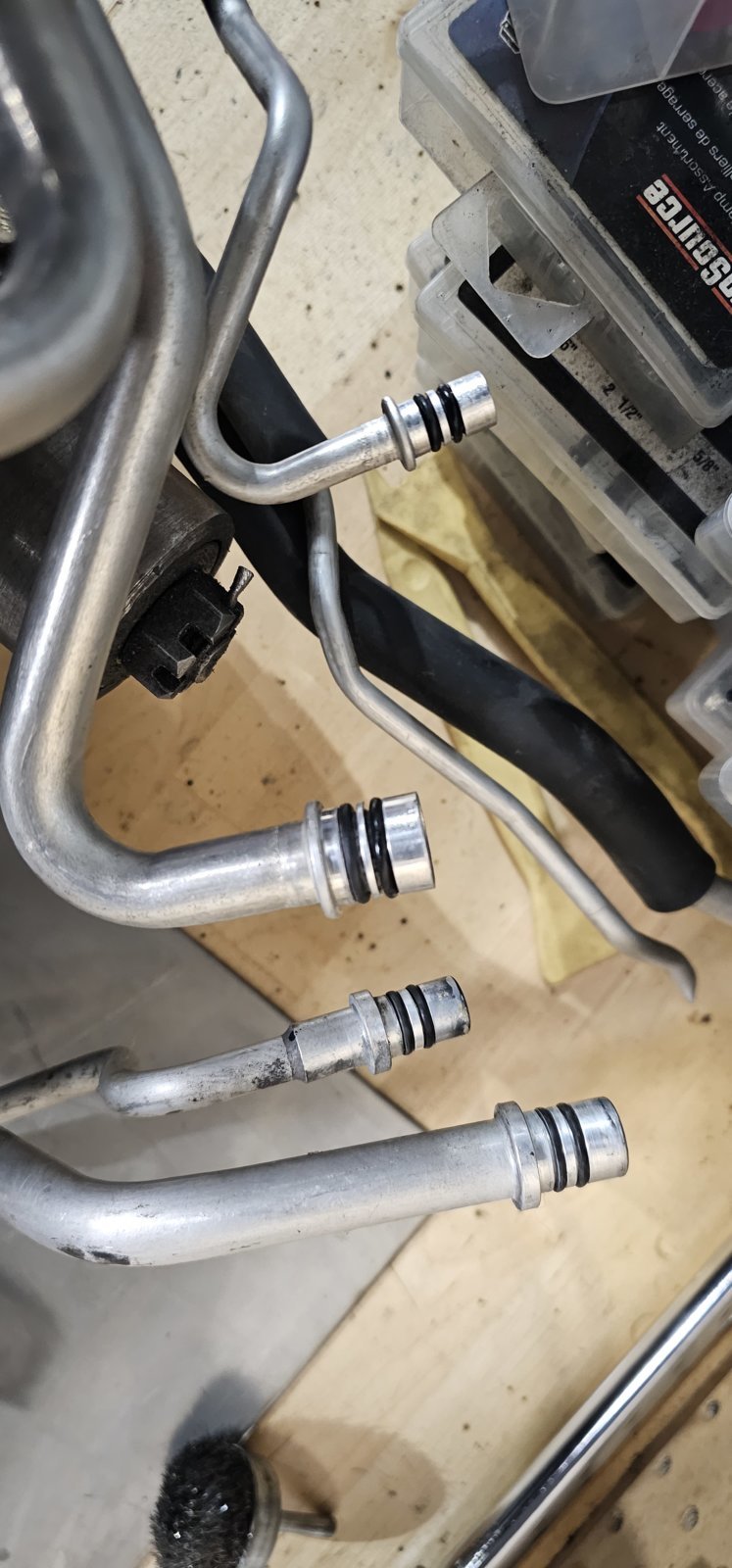

    Fuck those fittings. Works fine in your case, but I looked and looked and looked for a fitting that connects up to the evaporator. Couldn’t find anything short of $200 used oem lines. Had some AN connections soldered to the evap bungs. Once my engines back, my dummy Tacoma ac amp should be able to handle everything.IMG_6377.jpg
