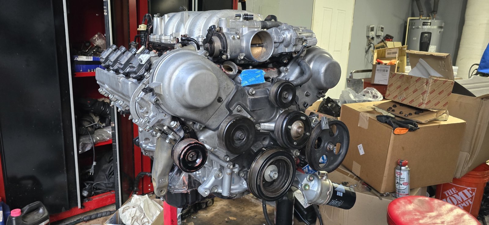

    Hey Guys,
    Sorry for no updates in a long time. I was assigned to a temporary senior manager position at work and had very little time to work on the projects. However, now I am back in to my old job so we are back to working on projects. The current status of the tacoma is I am still needing to test the AC. I am waiting on a plastic clamp for the AC line. This clamp is back ordered so I filled out another corporate complaint. They I ordered this thing in march. They are working it now, they say eta is end of july but we'll see. In the meantime I have been working on my Toybota. This is an Toyota Marine Epic 22 powered by a 1uz VVT-i. It had a broken rod, I am almost ready to install this engine. I wish I had more to update but this is life and thats how it goes sometimes.

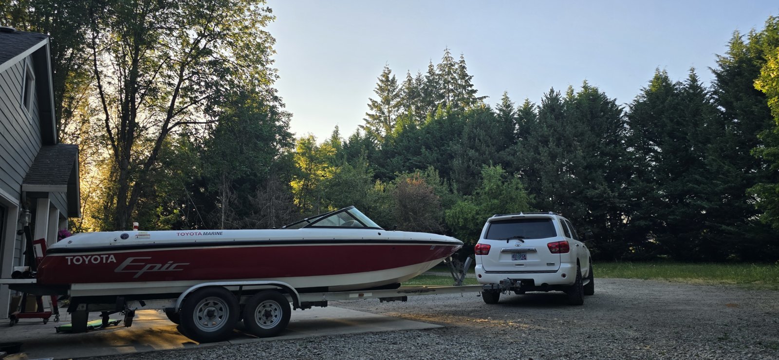

    Hey Guys,
    I am back. I got the Boat project completed and winterized. I also wrapped up my STI project. What a summer it has been! That being said, I have definitely over extended myself by taking on 3 projects at once. 2 out of 3 done so now I can focus on the Tacoma 100%.
