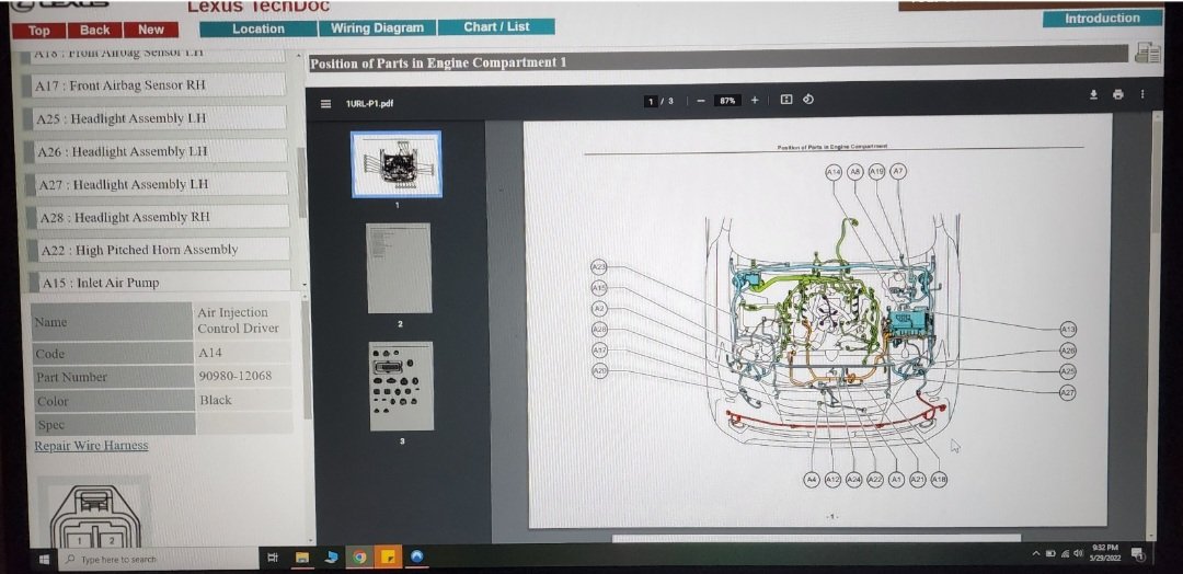

    2005 DCSB soon to be with V8 1UR-FE
    The lexus manual is next level. Here is an example of how well everything is documented. Screenshot_20220826-170001_Gallery.jpg

    Color coded parts locations and all.
    I’m jealous :pout:

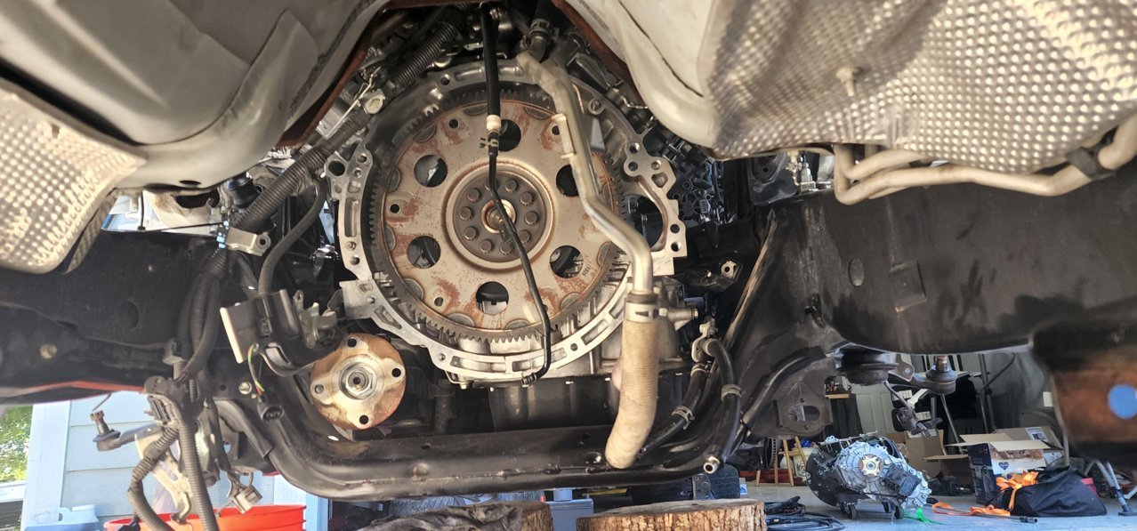

  10. Aug 30, 2022 at 6:15 PM
    #110
    dpanibratets
    dpanibratets [OP] Well-Known Member
    Sep 18, 2013
    #112778
    565
    Denis
    Vancouver, WA

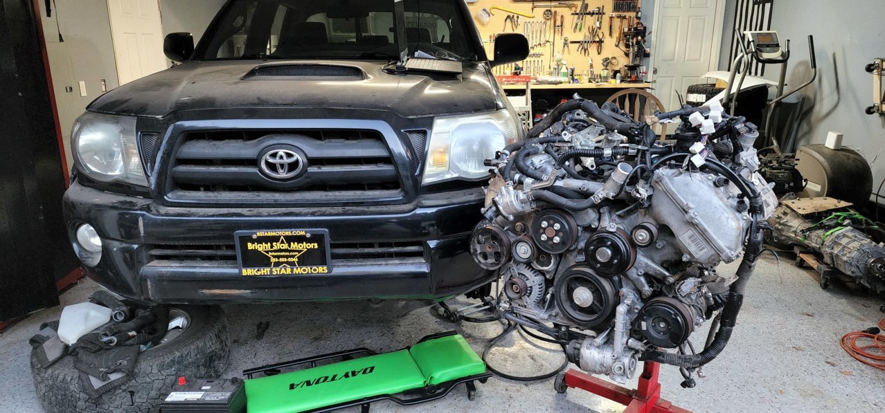

  11. Sep 5, 2022 at 8:44 PM
    #111
    dpanibratets
    Sep 18, 2013
    #112778
    565
    Denis
    Vancouver, WA
    Labor day means you work extra hard. Surprisingly, the wiring harness is pretty easy. The manual says to just unplug at the ecu and pull the engine with all of the wires attached. In general, once you have the headers off, everything else is pretty easy. It does however say that you need to pull the power steering and AC compressor. That didn't make any sense so I didn't and everything worked out.

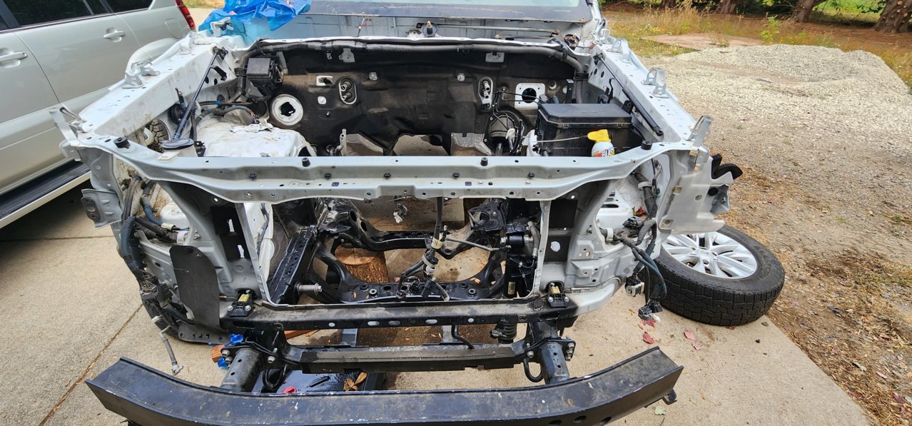

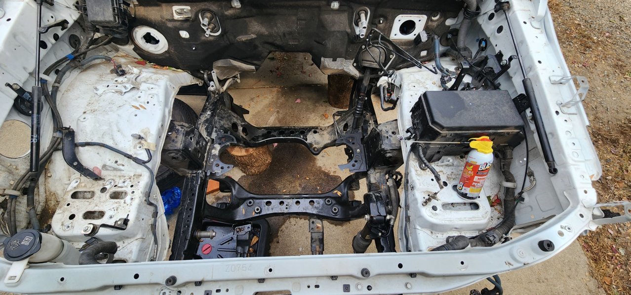

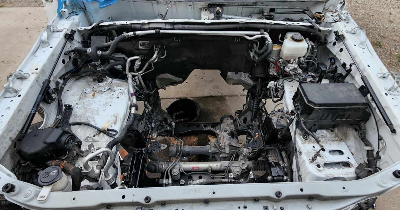

    Well boys, I am getting closer to having this thing fully stripped out. Electrical body harness will be the last to come out and first to go into the Tacoma. It is just easier to manage it that way. 20220913_125121.jpg 20220913_125114.jpg

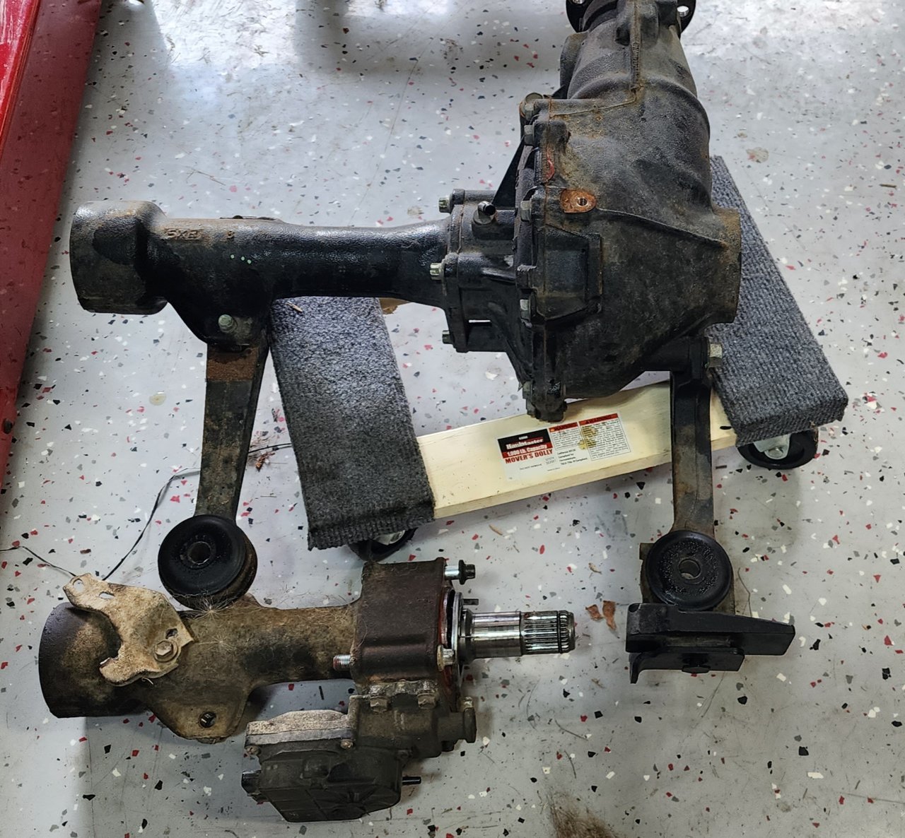

    Denis
    Vancouver, WA
    Here is a comparison shot to the front diff ADD vs Full time 4wd extension housings. I am going to swap the extension housing on to my rebuilt Tacoma front diff. I decided that 4.56 gears would be ideal on this A760F transmission. 20220913_125050.jpg

    2,291
    The idea here is that if you are swapping the engine in a vehicle, you don't need to recover and recharge the ac system, similar idea with the power steering. You just put the pumps off and leave the lines attached without opening either system. Doesn't matter though if you are moving the engine to a new vehicle.
