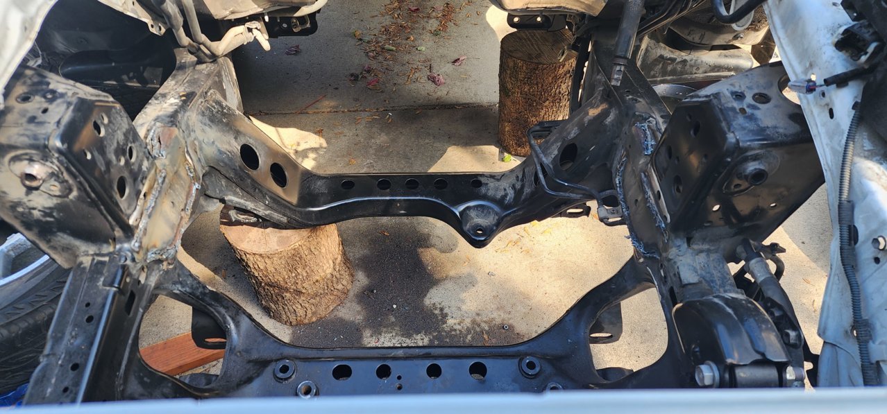

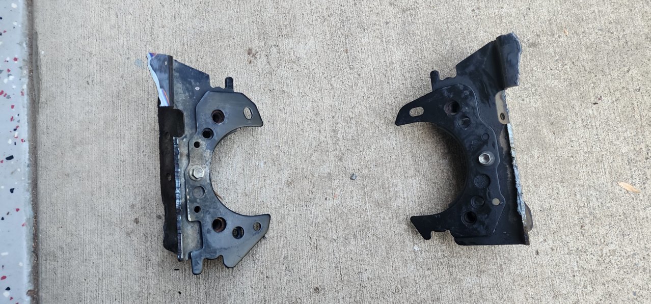

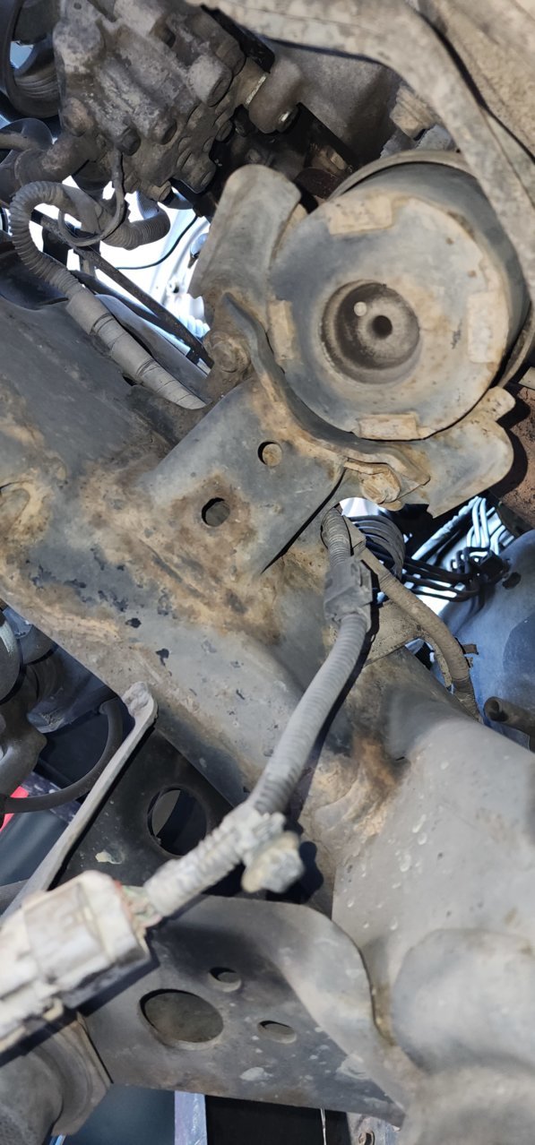

    I went ahead and plamsa cut the engine mounts off of the lexus frame today. After looking that the tacoma engine mounts, you can see in the pics below that the Tacoma mounts resemble a tower with a plate at about 45 degrees. The lexus engine mounts are more flat with stamped contoured frame to support the underside. I think the reason for the tower design in the tacoma is because the 1GR-FE 60 degree V shape whereas the 1UR-FE is a 90 degree V shape. I decided that I am going to take the lexus engine mounts, bolt them to the engine, get the engine into location, tack it in place, remove engine, mig weld the mounts in place. I will rest fit it with the radiator fan in place to make sure everything up front clears. Also import things to consider:
    -Engine location relative to the fire wall
    -Header clearance of cab
    -AC lines hook up
    Edit: Additionally I roughly measured that both vehicles frame rails at the shock towers are 28 inches which is really good news.

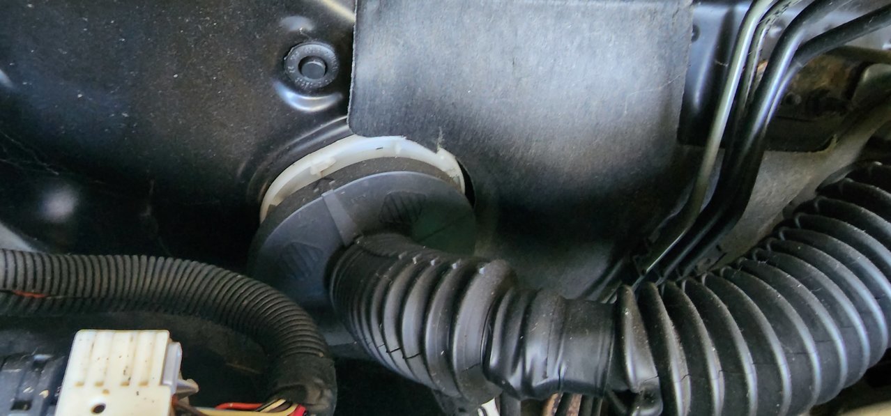

    On a side note, it appears the steering rack bolt locations are the same and the main harness at the ecu fire hole appears to be the same which is also nice.
    Lexus firewall hole:
    Tacoma harness:
