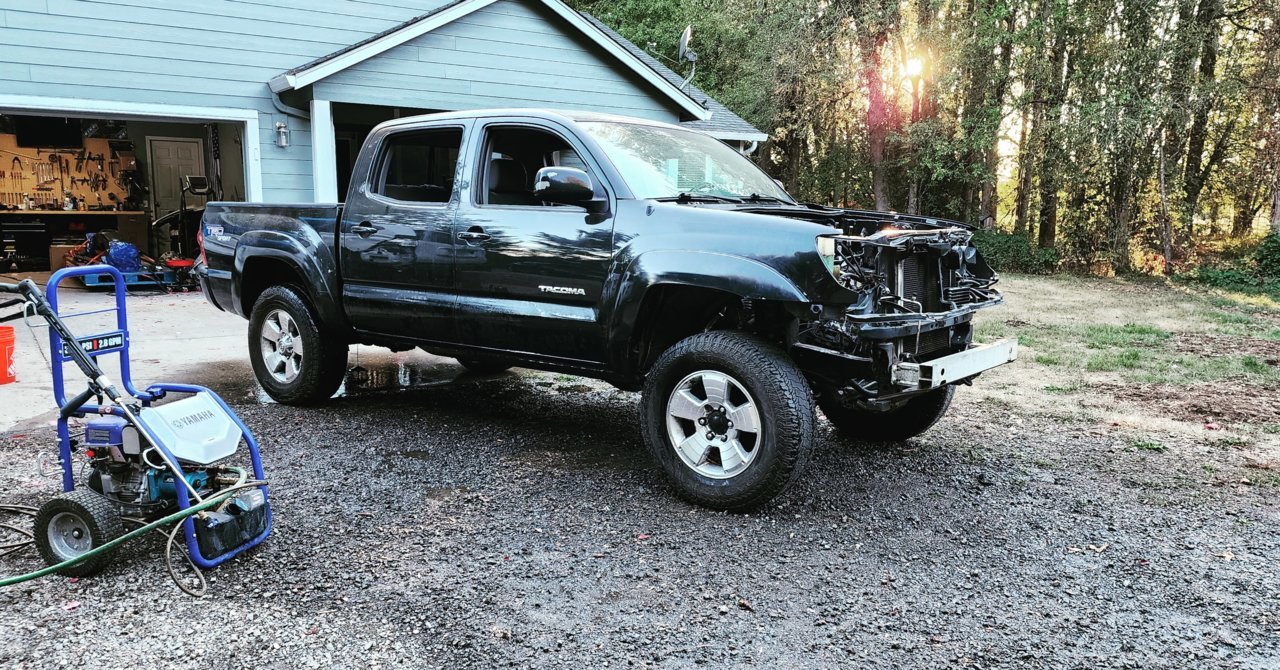

    Got the truck out and pressure washed it this weekend. I washed a lot dirt out that was caked inside the frame. IMG_20221001_185028_380.jpg

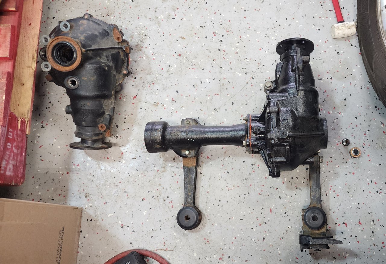

    I got the front differential accessories switched over to the 4.56 diff. Everything from lexus diff switched over. 20221003_094947.jpg

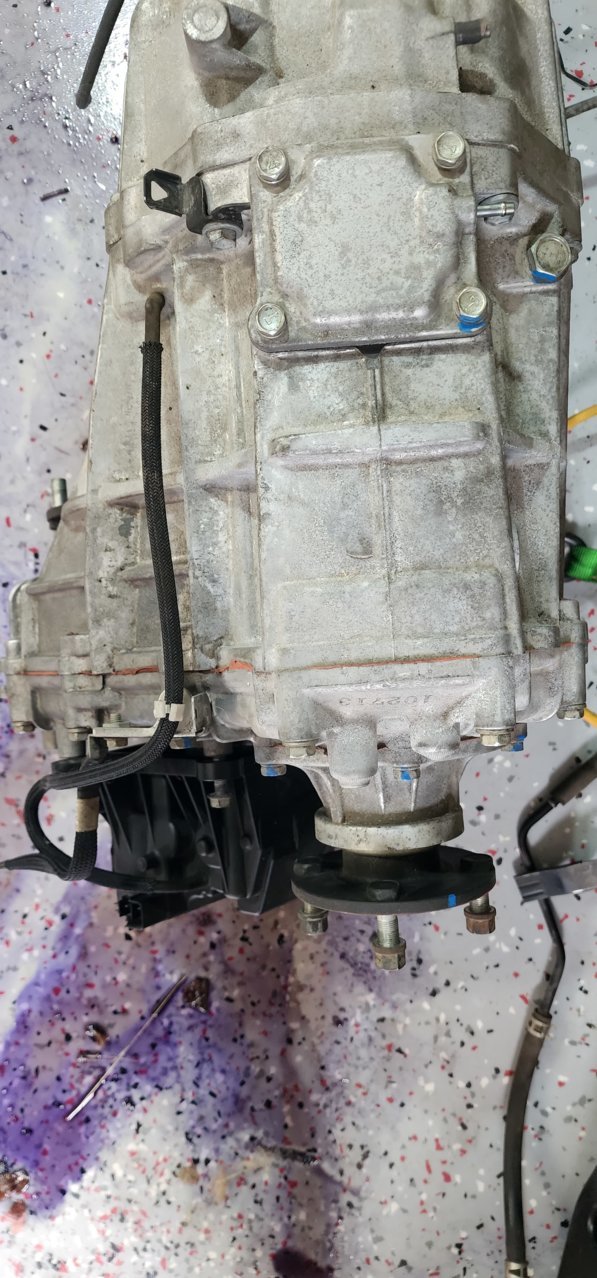

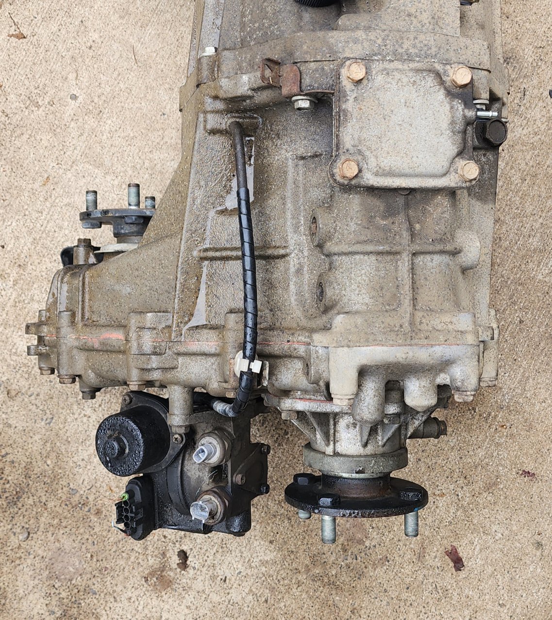

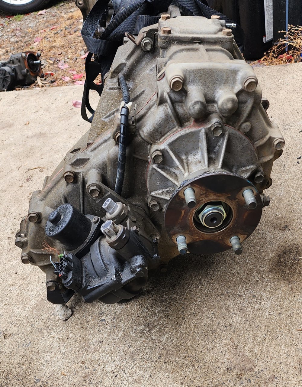

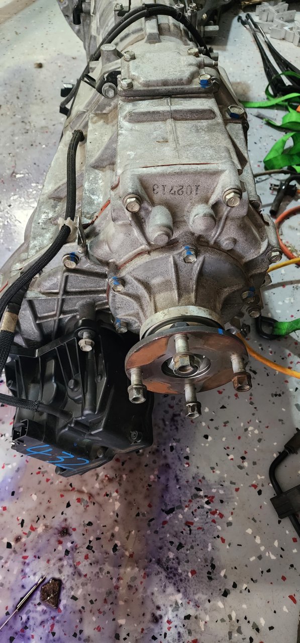

    Tacoma Transfer
    Lexus Transfer:
    CowboyTaco, Maxx, saf023 and 4 others like this.
  9. Oct 4, 2022 at 1:27 PM
    #149
    TireFire
    TireFire Superunknown Member
    Feb 6, 2016
    #177349
    7,667
    Olympic Peninsula
    That looks like it would mate up!

    I would think so because they are basically the same transmission/series.

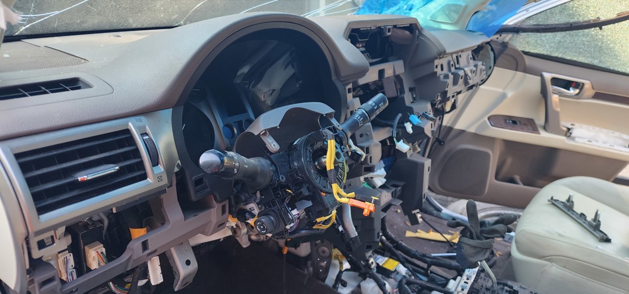

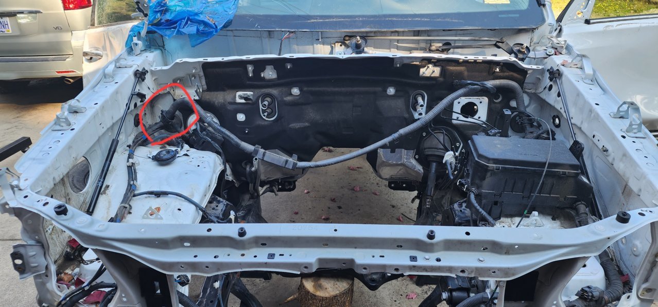

    I started pulling the wires. I realized that I will have to cut a hole where I circled in red on the tacoma. I will also be transferring the steering column because there is a lot of wiring attached to it. A power telescoping steering wheel is nice also. Additionally, it will delete the physical key hole and integrate with the GXs steering wheel lock nicely.
