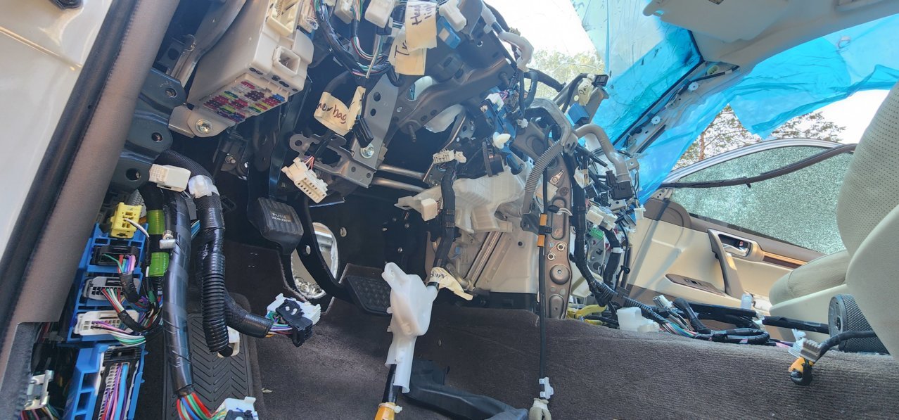

    Now thats what I am talking about! I got the dash off so now I can get a good idea where everything goes. At this point I am thinking it will be easier to fit the tacoma dash and plastics over this crash bar so I am thinking about taking it also. If not I think it will require cutting off brackets and welding them onto the tacoma crash bar. Either way, I am excited!20221008_150228.jpg20221008_150235.jpg20221008_150257.jpg20221008_150235.jpg 20221008_150305.jpg

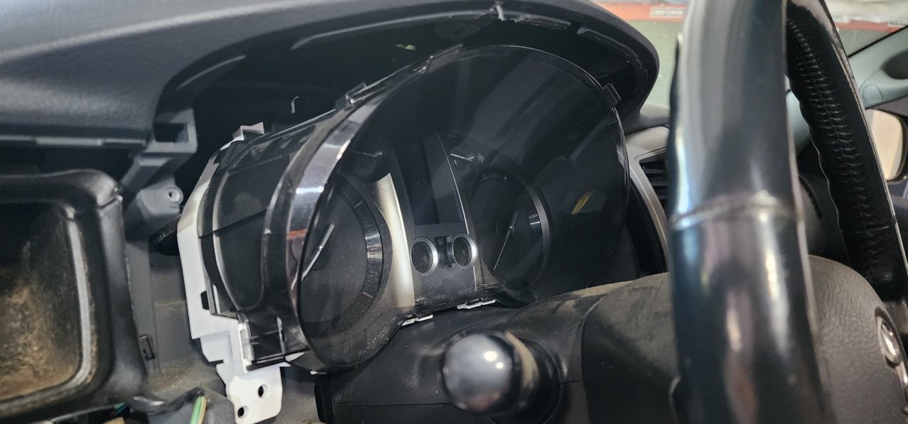

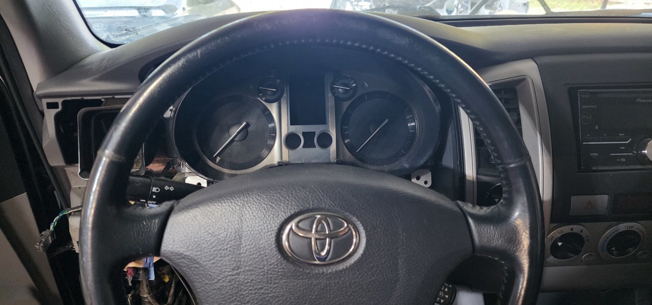

    Just messing around while I tear down the tacoma dash. The cluster fits really nicely but I will have to get creative with the surrounding trim. 20221010_165642.jpg 20221010_165649.jpg

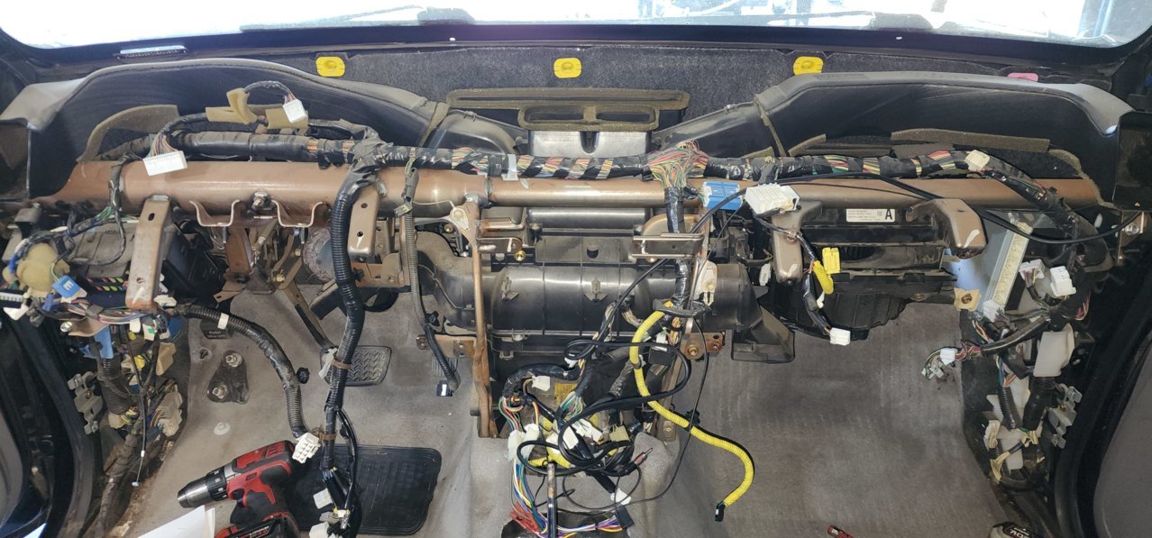

  4. Oct 19, 2022 at 4:00 PM
    #164
    dpanibratets
    dpanibratets [OP] Well-Known Member
    Sep 18, 2013
    #112778
    565
    Denis
    Vancouver, WA
    2005 DCSB soon to be with V8 1UR-FE
    Alright guys, sorry for no updates, I was out of town. I got the dash and steering column out of the way. The tacoma behind the dash components look really simple. My plan going forward is to continue to strip the engine bay completely.

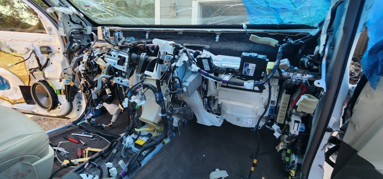

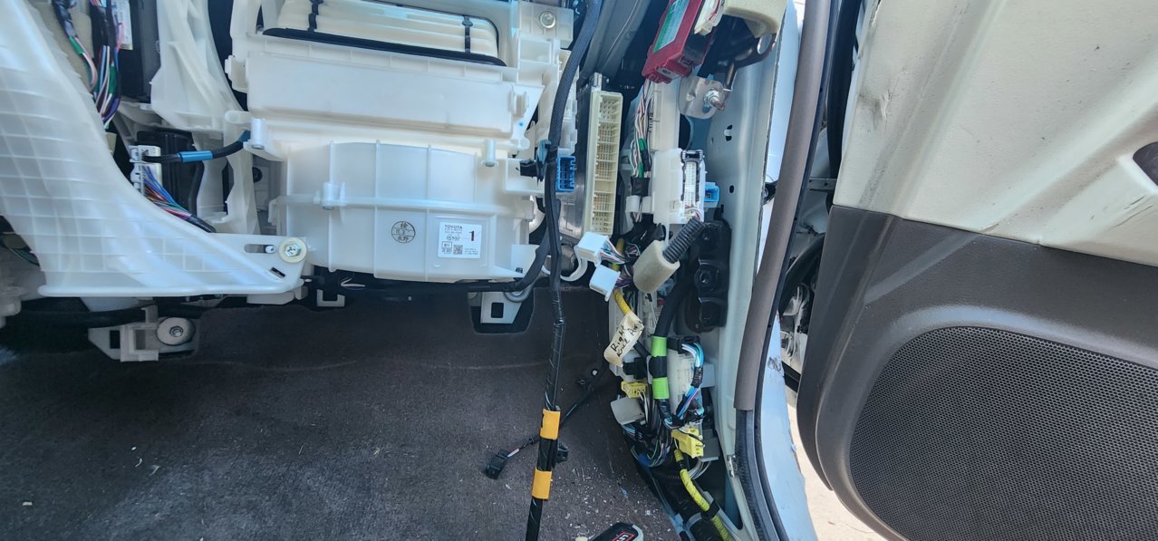

  9. Oct 27, 2022 at 12:34 AM
    #169
    dpanibratets
    Sep 18, 2013
    #112778
    565
    Denis
    Vancouver, WA

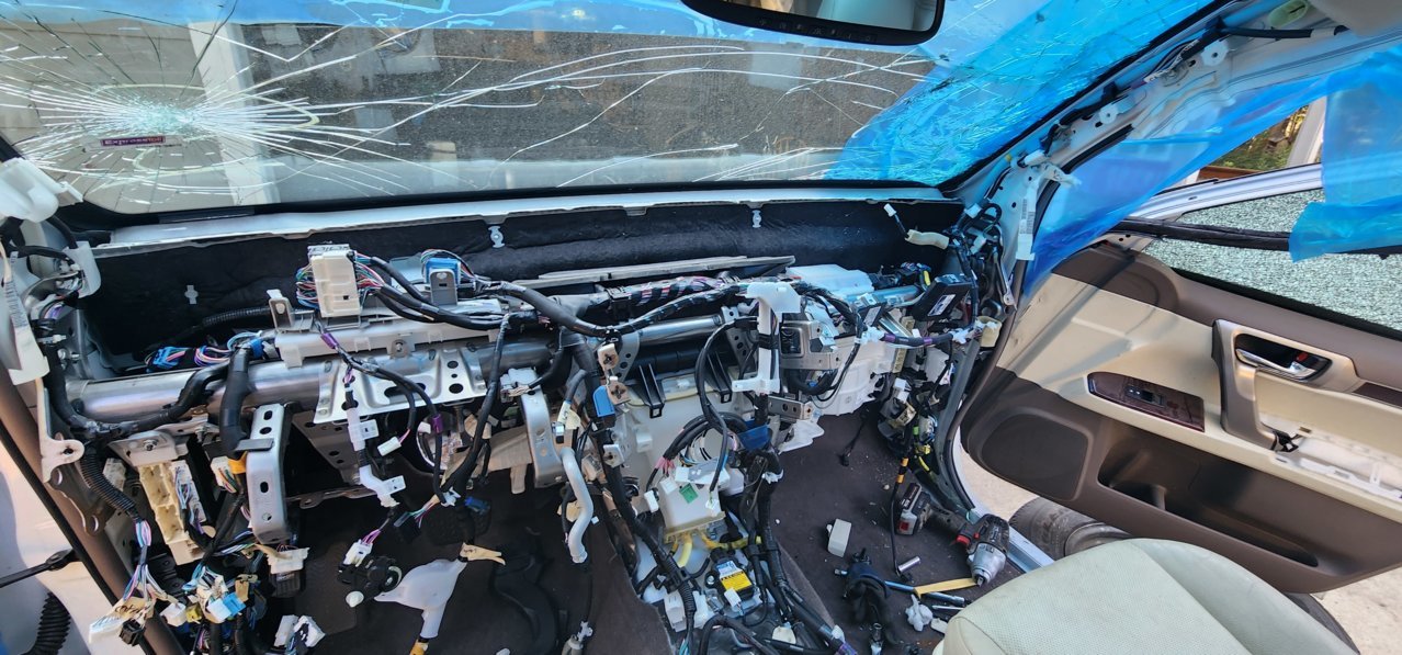

    I got it torn down pretty good! Almost time to start wiring it up!IMG_20221026_161449_975.jpg IMG_20221026_161450_031.jpg

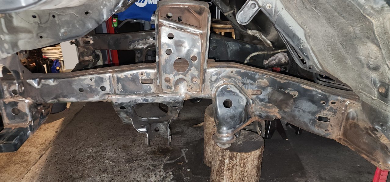

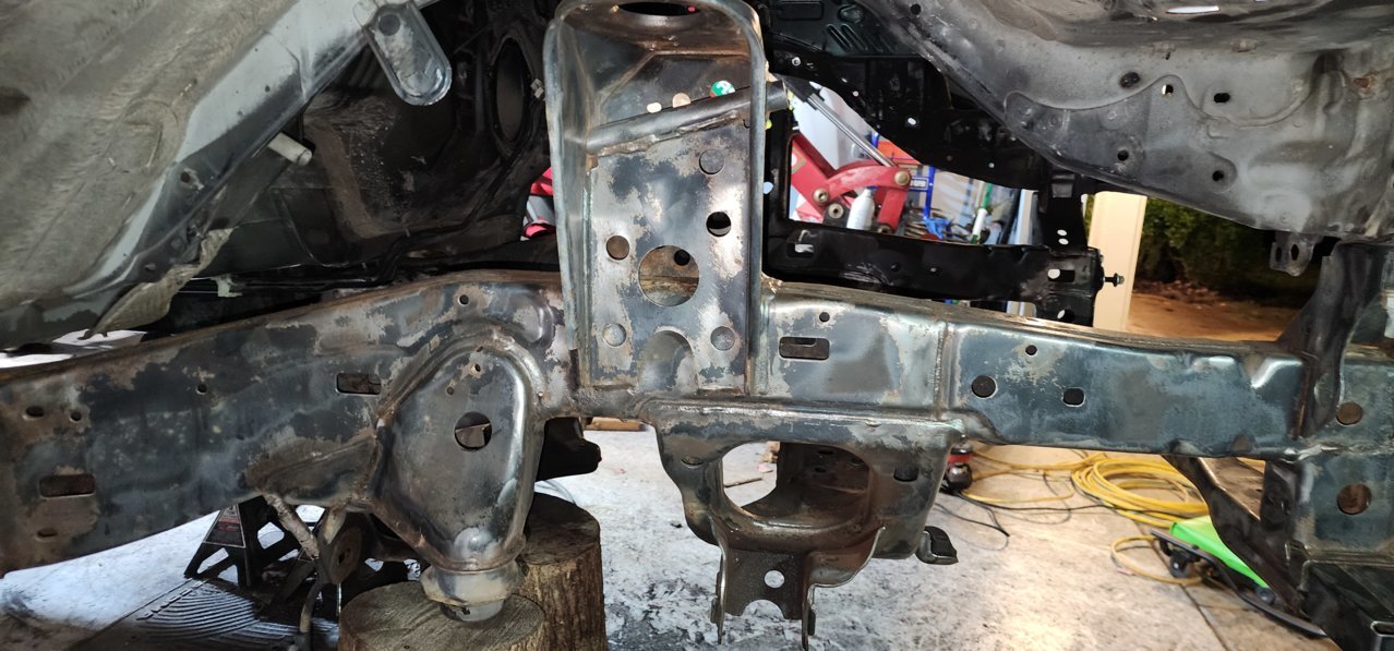

    These 2005s are notorious for frame rot, particularly in this section where water gets in between the two layers. So I spent the weekend cutting and welding in 2 walls off of the lexus frame. My welds aren't pretty but I think I got good enough penetration, certainly better than no frame wall due to frame rot. The frame around this one section is solid and I plan on putting in plastic frame plugs, spraying the inside and outside of the frame with undercoating and fluid film. I noticed on later tacomas they plug the frames.

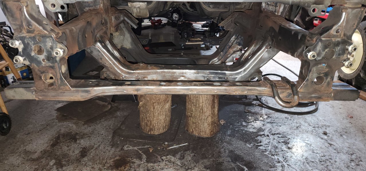

    Got to work on wire wheeling on the engine bay frame.20221030_200043.jpg 20221030_200056.jpg20221030_200009.jpg
