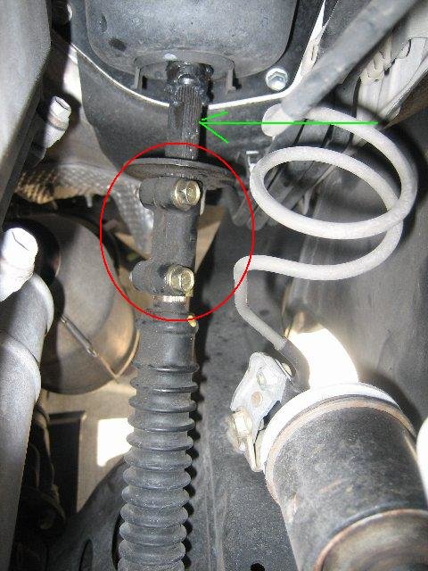

    What is the issue?
    As per Toyota's technical service bulletin (TSB, file attached below), it is claimed that 2005-2010 model year 4x4 and PreRunner Tacomas suffer from a steering U-joint that rapidly wears, causing stiff or binding steering.
    In their TSB, Toyota carefully describes this issue as a "noisy steering shaft" that makes a rattling noise when going over rough roads, and bumps.
    In reality, this is quite the understatement.

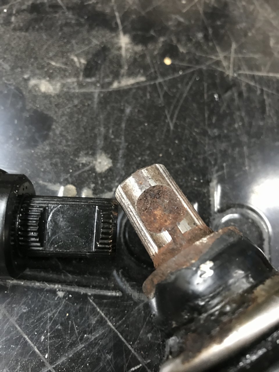

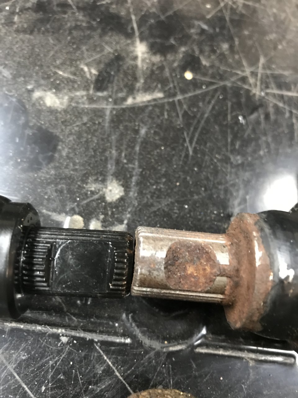

    The root issue is that the U-joint is exposed to road grime, moisture, salt, etc. The joint develops surface rust which creates friction in the steering linkage. Most owners report stiff or binding steering. Most people will fight through it or spray WD-40 on the linkage if they discover the issue.
    Each time this happens, they are grinding the surface rust away, which leaves the U-joint exposed again. The U-joint rusts again, the driver fights through it again. The joint gets worn down in the process.
    Here is an example of nearly a worst-case scenario:
    (I will update this with pictures of my shaft [above] after I removed it from the vehicle)
    As seen in the video, the joint exhibits lots of rust, and has been worn down so much that it has developed a large amount of play, allowing the steering wheel to turn freely for ~30° of rotation.
    I say the video above is 'nearly a worst-case scenario' because the worst-case scenario is that the joint separates and the driver loses steering control while in motion.

    • Struggling to remove the steering shaft on the lower end where it connects to the steering rack due to rust, friction, crud, etc. (single most 'painful' part - added ~1.5-2 hrs.)
    • Difficulty removing the upper steering shaft from the clamp (moderate pain - added 20-30mins)

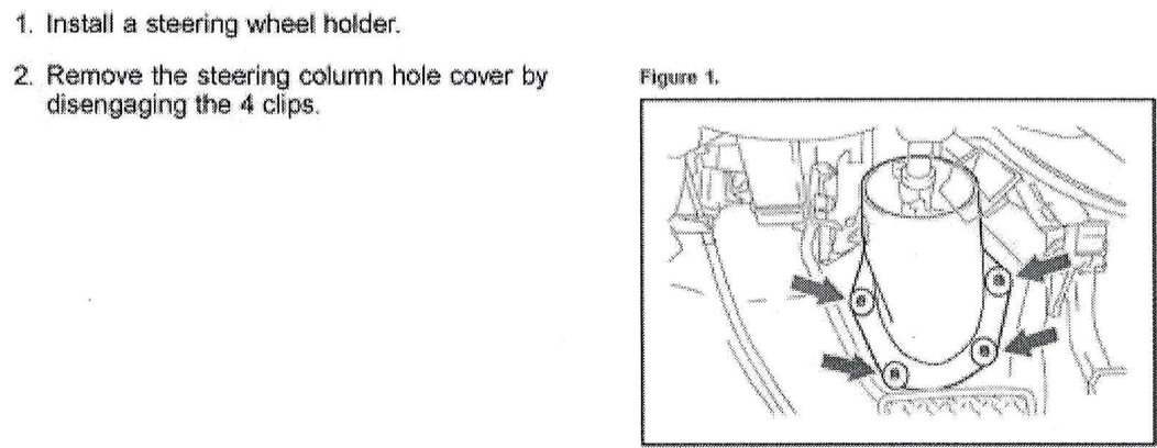

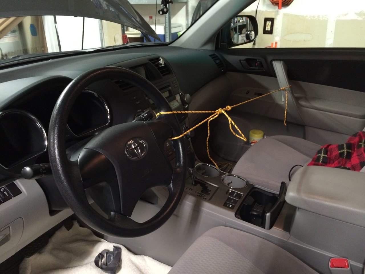

    1. Lock your steering wheel (SW) so that it can not move. Properly secure it in place via straps, or a steering wheel holder. In addition, make sure your front wheels do not move during this procedure.XkeatJd.jpg (borrowed from http://www.toyotanation.com/forum/1...-intermediate-steering-shaft-replacement.html)

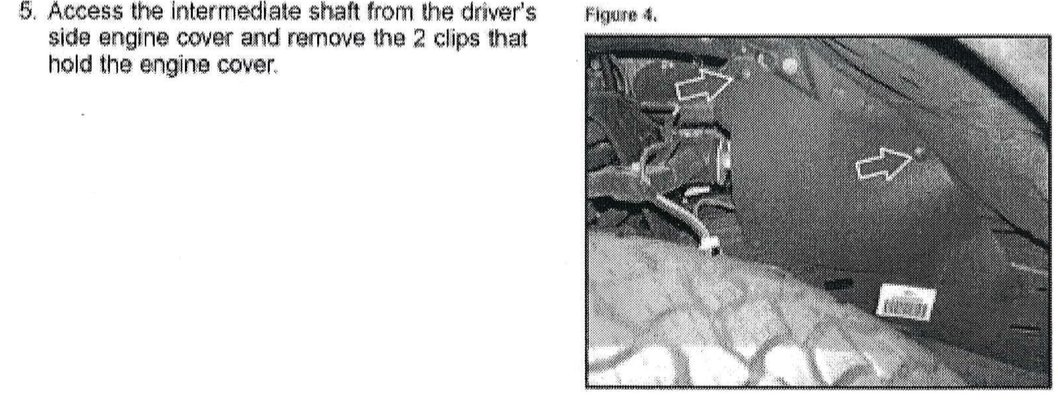

    2. Behind the pedals, remove the dust shield at the bottom of the steering column - fastened by 4 white plastic nuts. Remove by finger. Pull back the carpet to access the 2 hidden nutsScreen Shot 2018-04-17 at 1.58.03 PM.jpg
    3. Pull off the steering column dust cover. It has a cut-through on the back, so it can be pulled off of the shaft.

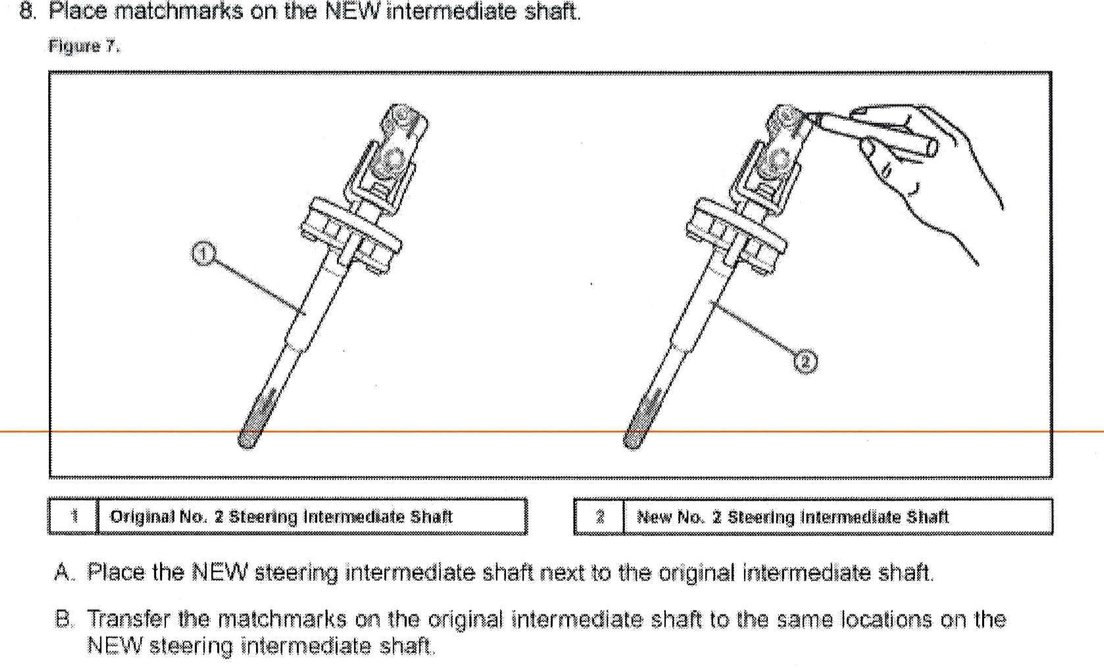

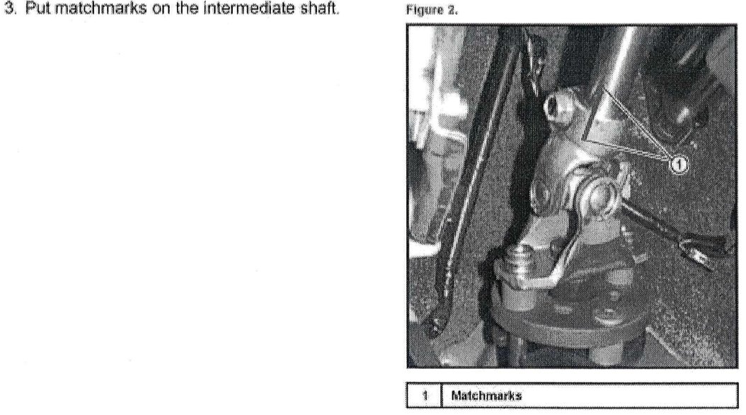

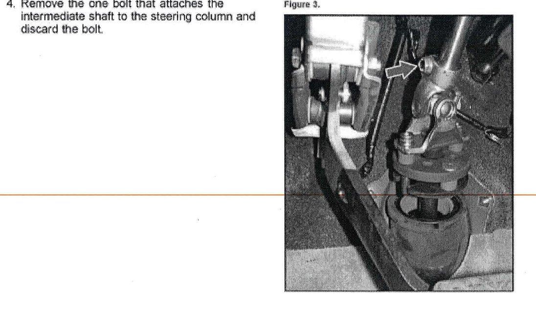

    4. The TSB says to make match marks on the joint and the shaft so that it can be properly re-indexed upon re-assembly. Use a Sharpie to draw a line across both the shaft and the joint, so you have a reference mark to re-align it. Screen Shot 2018-04-17 at 2.02.29 PM.jpg
    5. Remove the bolt holding the steering column to the joint. I am not entirely sure if there is a purpose of removing this bolt other than to replace it with the updated part (listed below). This bolt is 12mm as are the 3 other bolts in this procedure.Screen Shot 2018-04-17 at 2.02.43 PM.jpg

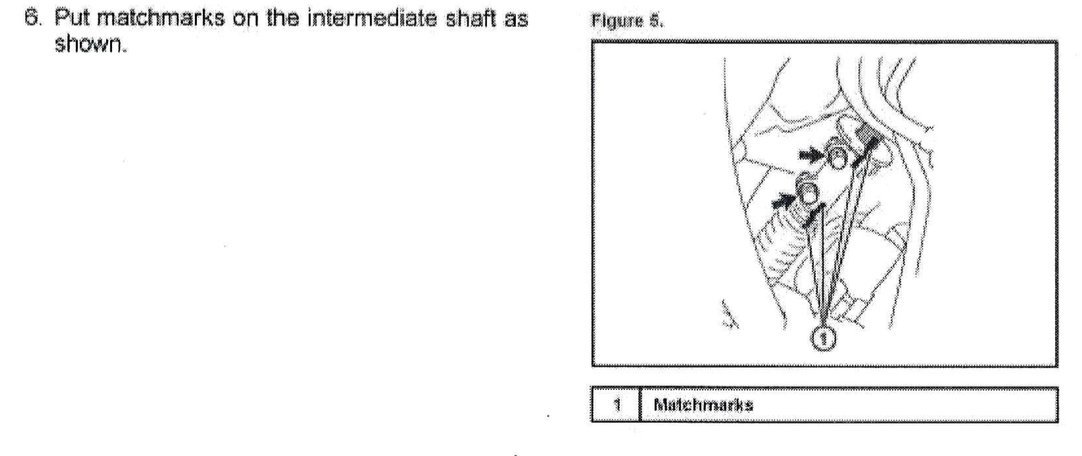

    6. Gain access to the clamp that connects the upper and lower steering shafts. Screen Shot 2018-04-17 at 2.16.01 PM.jpg

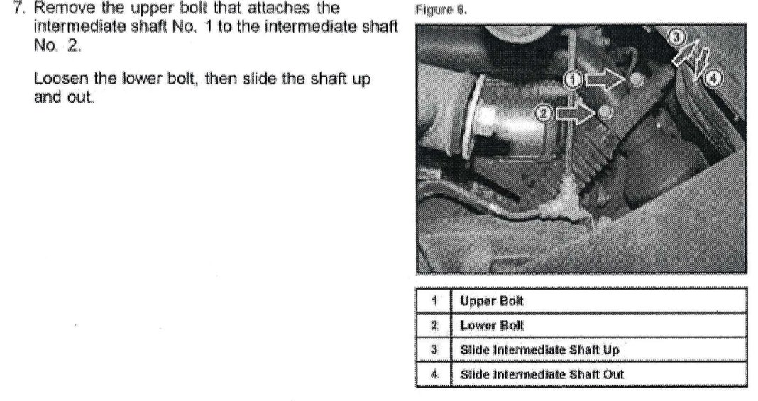

    7. Again, make match marks on these 2 shafts with respect to the collar.Screen Shot 2018-04-17 at 2.16.19 PM.jpg 4R4steering.jpg(borrowed from http://www.4crawler.com/4x4/ForSale/Docs/BodyLift_HowTo.shtml)
    8. Remove the 2 bolts (may be hard to remove due to rust. Use penetrating oil and do not break the bolts off because your life will then be 100x more painful) holding the clamp in place and "remove shaft" as the TSB states. The ease of this step depends greatly on how the rotation of your steering prior to you parking the truck. I have a feeling that, when SW is centered, the bolts align themselves as pictured below, but cannot confirm yet.Screen Shot 2018-04-17 at 2.17.22 PM.jpg
      • The TSB simply says "slide up and out".
      • Until now, I have been almost directly copy-pasting from the TSB, but this is where reality starts to deviate the course.
      • This step is not nearly as easy as pictured. There is friction involved, making the shafts hard to separate. *Remember: the shaft slides up, not down*
      • My truck recently had the frame replaced prior, so someone else had done the hard work and 'broken the seal' for me. Even so, I spent a lot of time on this step.
      • After trying by hand for about 20 minutes, I realized it wasn't gonna budge.
      • I tried to open up the collar by prying a flat blade in the slot. This did not do much on its own.
      • Then I got out the propane torch and penetrating oil. I put the flame right on the collar for 30-45 seconds. Then I quenched it with WD-40. Be careful how you aim the touch as there are brake lines nearby.
      • The shaft gave up and released after 3-4 rounds.
      • I found there was no proper way of using a pry bar or leverage in this instance (nothing to pry against) so you just have to hope that it eventually comes loose by hand through heating/cooling, penetrating oil, opening the slot with a flat blade, etc.
      • You can either do this from the wheel well, or from under the truck reaching up. It may be easier to create space in the wheel well by removing the wheel *be careful when placing jack stands*

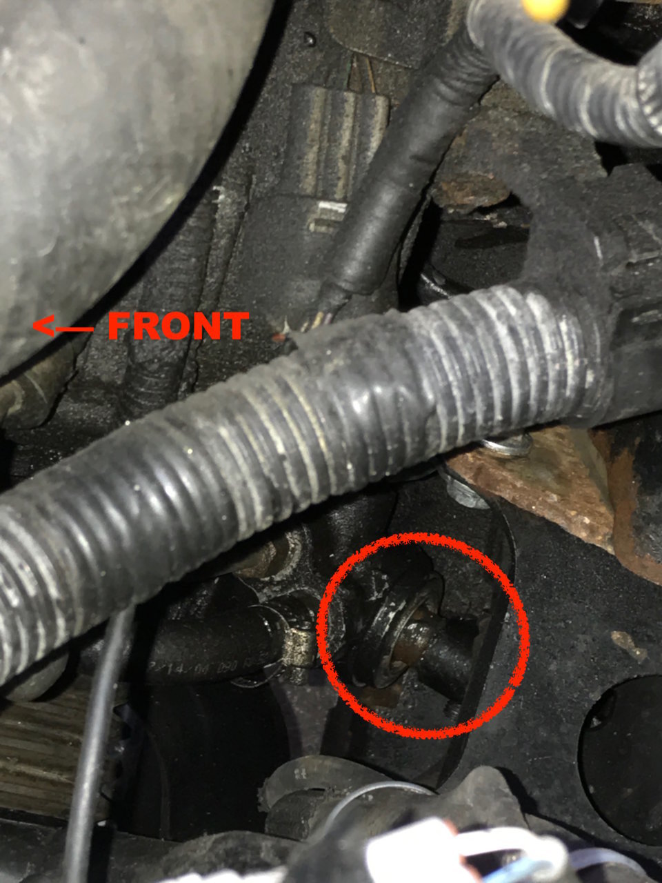

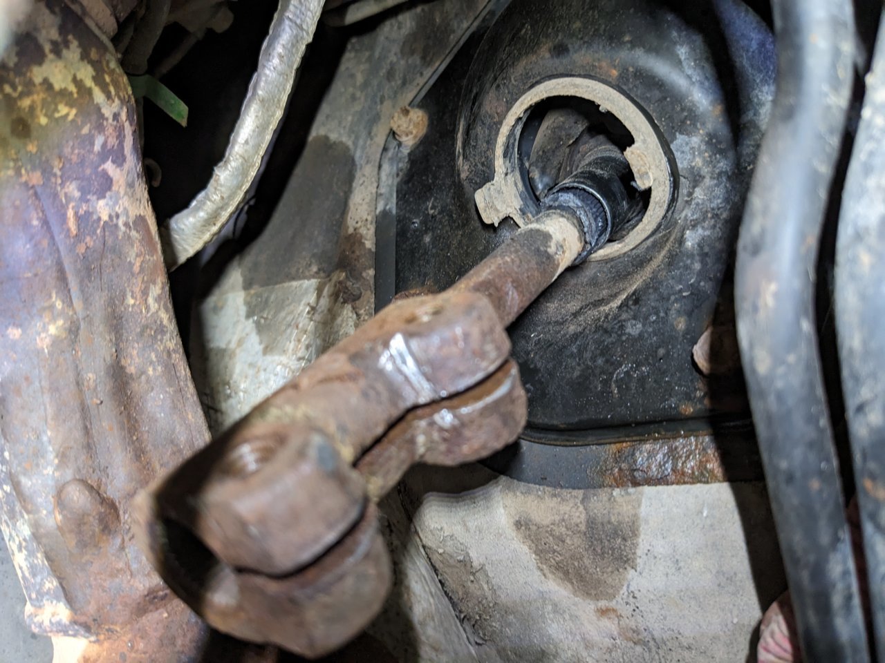

    9. Remove the shaft from the vehicle. Somehow the TSB completely skips over this and jumps to "transfer match marks from the old shaft over to the new shaft.

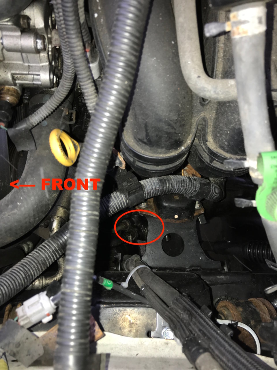

      • Remove the bolt at the steering rack that holds the shaft in place. It is a bit hard to see from below, and nearly impossible any other way. The only way I could see it from below is lifting my head up between the cross members and following the shaft down to see the joint. Although difficult to see, it is rather easy to access. The access of this bolt depends greatly on how the shaft was rotated prior to you parking the truck.
      • Ideally, you should make match marks on the lower steering shaft and the rack because they are not indexed to each other. The TSB skips over this completely, which makes no sense because the other match marks are worthless if this is indexed incorrectly.
      • [Will add pictures later]
    10. Once the bolt on the rack side is removed, the only thing attaching the shaft to the vehicle is friction. A whole lotta friction. This was by far the hardest part of the job. I spent ~1.5hrs removing the shaft from the steering rack. The rust gets worse the lower down on the truck you go.
      • I tried Mr. Torch again, sprayed in WD-40 and repeated 4-5 rounds.
      • I tried to pull straight up by hand (while on my back below the truck). This is an odd motion/angle, so I didn't have much strength in this.
      • I tried to pull up from above through bending over into the engine bay (try standing on a crate or car wheel to have more reach). Again, weird angle with outstretched arms - no strength here.
      • I tried to pry from below. Bad idea because I was likely exerting forces at a non-parallel angle to the steering shaft - something the steering rack is not designed for.
      • Lastly, I used a pickle fork from above. I stood on a car wheel placed right below the driver's headlight. I then bent over the core support, and placed a pickle fork between the steering shaft and rack input shaft. There is a rubber hose in your way. Move it to the side, and insert pickle fork.
      • After a few 'gentle' pries, I was able to get the shaft off

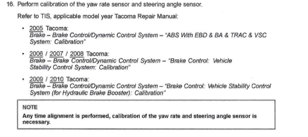

    17. The TSB says to calibrate the yaw rate sensor and steering angle sensor. There is also a note referring to vehicles equipped with traction control, VSC, BA (brake assist?), and EBD (early brake detection?). I admit, I do not know how to do this, but I assume my truck does not apply due to being a 4cyl model. I have not seen this step mentioned in other threads, but I will include it here for the sake of being thorough. I would say that if you put everything in the same alignment it was originally in, this is not necessary, but please investigate this according to your own needs. Screen Shot 2018-04-19 at 2.17.01 AM.jpg

    4. In step 1 - Unfortunately, my SW had lots of free play (rendering my indexing worthless), so I chose to simply let the SW ignition lock hold my SW in place. I removed the key from the ignition, and rotated SW until the steering column lock clicked.

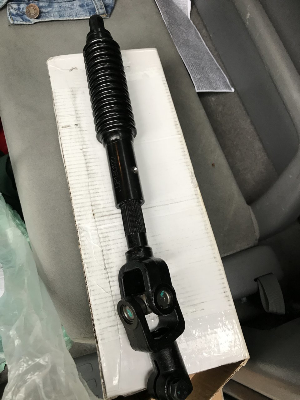

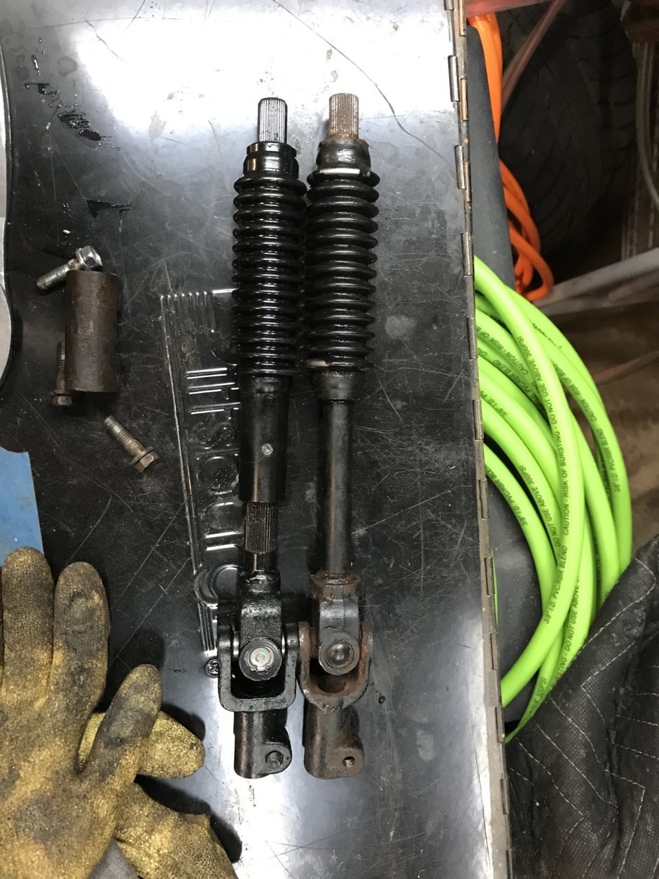

    Here's my quick review of the new shaft I got. After driving with it for about 4 months, I think it's a really good replica. My steering has just one hair's worth of play in it, but that could be anything - tie rods, steering rack, top shaft, etc. Only noticeable when stopped and jiggling the steering wheel back and forth repeatedly. Barely a hair's worth.
    Here's how I got it in the mail.

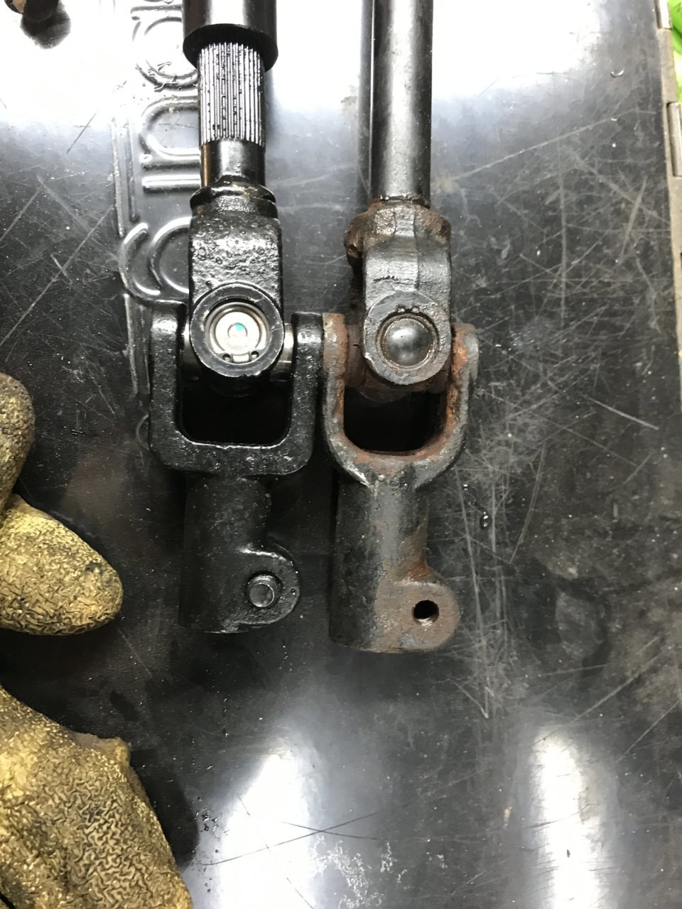

    The shaft is almost identical, but not quite.
    The old shaft has a key-way notch that runs along the top bit of the shaft. The new one does not have this notch.
    Also, the new shaft is shorter by a hair.
    Other than that, they are pretty much an identical and interchangeable piece.
    I would 10/10 recommend, and will buy another one if I ever need to. Especially at 1/4-1/3 the price of OEM Toyota.

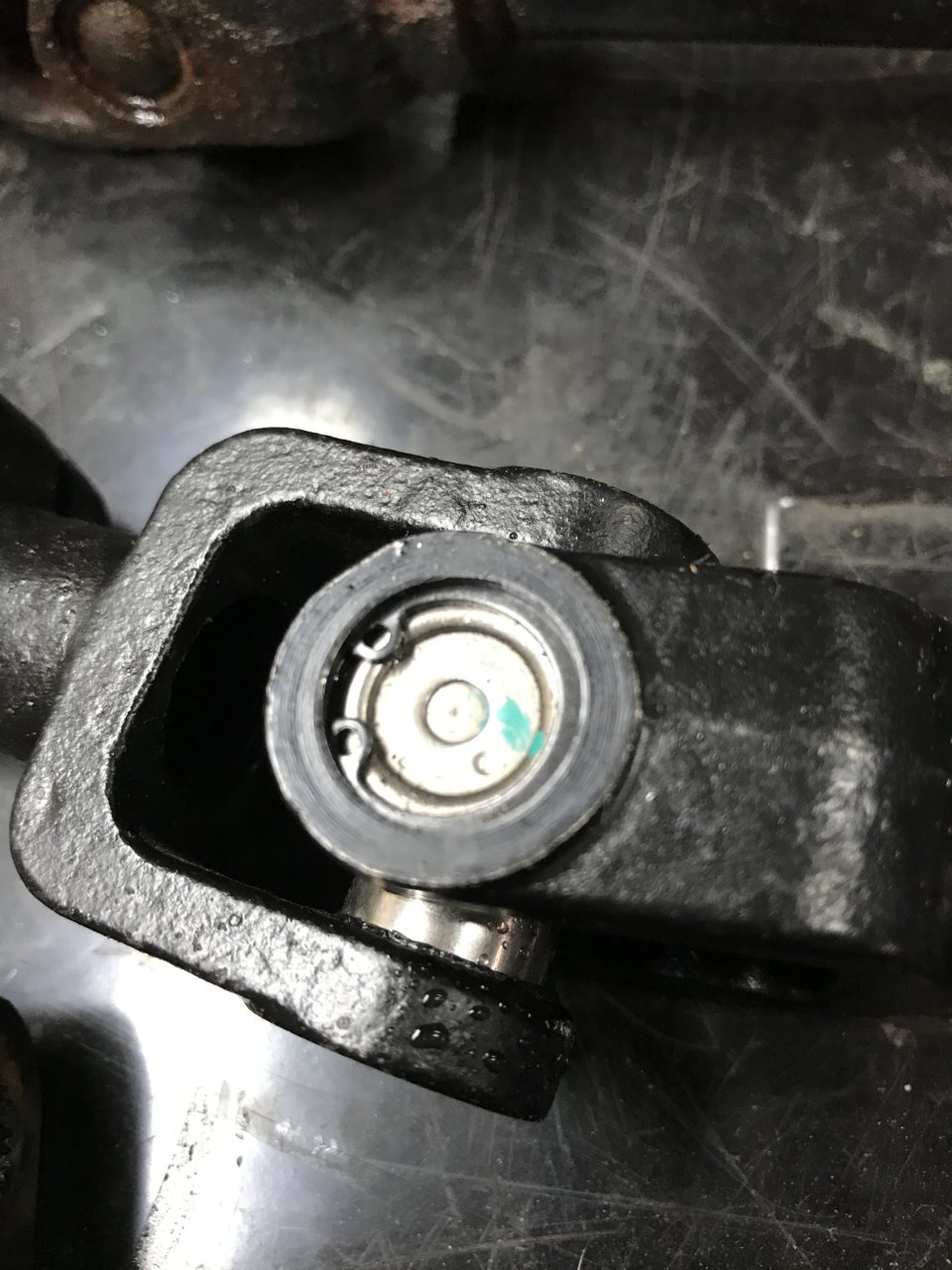

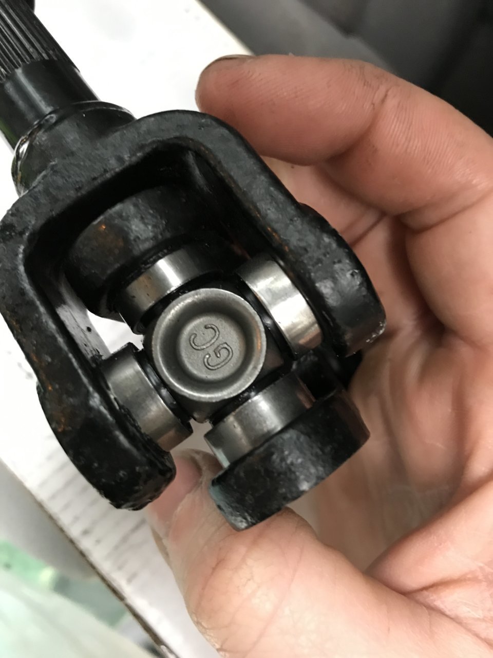

    Picked one up and attempted to replace, but I couldn’t get the shaft to slide “up and out” enough to come out. I had only about 1/2” of movement and that was with use of Balpean hammers. I didn’t feel like breaking out the air hammer. I also was concerned that the bottom wasn’t going to come off once I had the upper connection off. Everything was pretty rusted, I had to wait an hour for the 50/50 atf/acetone + aerokroil to penetrate, and had to be really creative with extension rods to reach that lower bolt with the impact. I also wasn’t a fan of my ‘matchmarks’ melting away with all the penetrating oil I had all over everything .
    Cleaned it up and manually greased the original one with some molly, then buttoned it back together and will replace it with the steering rack some later time. Entertained sawzalling the old one off, but I really was worried about that bottom.
    Btw, the OEM column ujoints have China stamped in each bearing cover. This eBay part very high quality and just as good as the OEM part. No need to turn ones nose up to this non-OEM part.

    I just replaced this today and this thread helped a lot. I was a little confused by the diagrams concerning the upper shaft as I didn't need to do anything with the upper shaft (inside the vehicle under the drivers dash).
    Some tips that I would ad. I didn't "lock down" the steering wheel until I was ready to start hammering, having the ability to rotate the shaft and have access to the seams to get things loose helped a lot. Once the seams were opened up I locked down the steering wheel and got the shaft off.
    I would also say. The key to getting the upper collar loose enough and the lower section off was to spread the collar more than I thought. Get a screwdriver or pry bar in the seam on each and get it opened up. I also had been PB blasting things for 3 days prior and used a torch to heat up the collar prior to pounding it loose.

  20. Jun 27, 2023 at 9:55 PM
    #20
    Pgilbrea
    Pgilbrea New Member
    Jun 27, 2023
    #427776
    3
    Paul
    2009 TRD Sport 6-speed
    Just did this and there was a LOT of rust. I was pounding pretty hard to get the sleeve to move after a dozen or so soaks and as much collar spreading as I could manage. I got the old off and decided to pull the sleeve all the way off to clean up some rust. I couldn't figure out a method of hammering or prying the sleeve back down, so I slpiced a couple eyes of dyneema to do a slide hammer type movement. Think steal cable with a 3lb hammer on the end. When removing the old shaft, I hadn't noticed the sleeve had not moved on the upper shaft, only that the intermediate shaft had come out of the sleeve.
    The slide hammer type thing worked really well... Too well actually. It didn't take long before I realized the upper shaft was moving but the sleeve was still firmly attached to the splines. So..... Looks like I may get to replace the upper shaft now too? I haven't ventured into getting it off and assessing the damage as I ran out of daylight. Thoughts?
    Picture is looking up from the seized sleeve still attached to the upper shaft. Note the upper splines and newly exposed grease.
