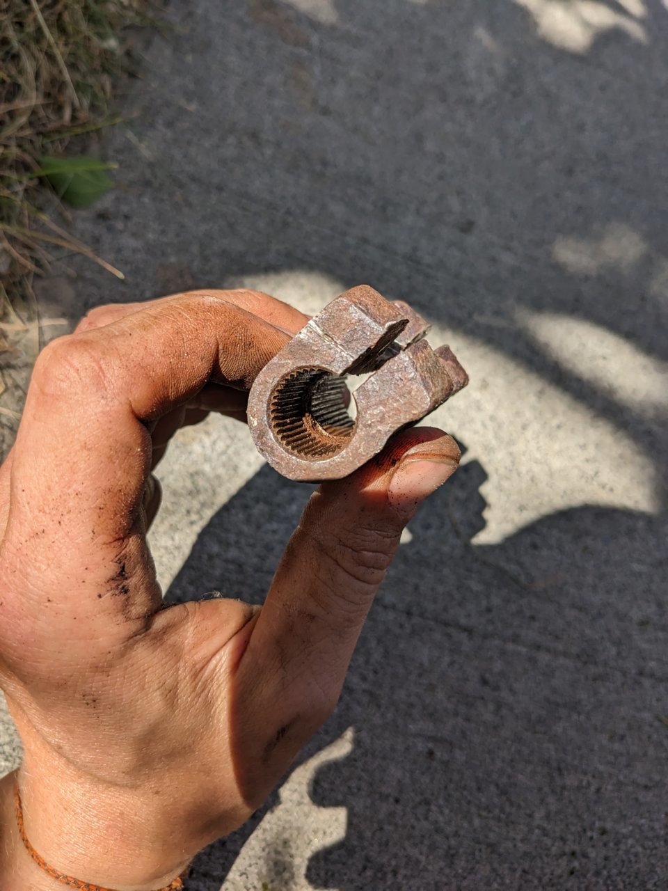

    I see it as you have 2 options. Being that the sleeve/clamp didn't move on the upper shaft, you could reinstall as is OR remove the upper shaft which isn't difficult, and soak with Penetrant, put in a vise and BFH the sleeve/clamp off, clean up the splines and inspect further. I'd recommend using a torch and applying some heat before getting too carried away with the hammer. Heat is your friend here, followed by a good penetrating oil.
    I'd refrain from "Spreading" the sleeve/clamp as much as possible, as it'll only weaken it. Remove as much surface rust as possible, and go with the heat and Penetrant method. If you're able to put it in a vise, with the sleeve/clamp on top of the vise Jaws, and the shaft hanging below the vise, that'll give you something to drive against and hold it. Use a punch and drive the shaft out of the Clamp with a good size hammer.

    Thanks for the help Yancey! Got it wrapped up today. The sleeve was pretty bad, so no wonder I couldn't get it to slide. After wire brushing it and cleaning it up, the corrosion was still pretty welded on and hard to remove without spline damage. I opted to make a quick trip up to my stealership.
