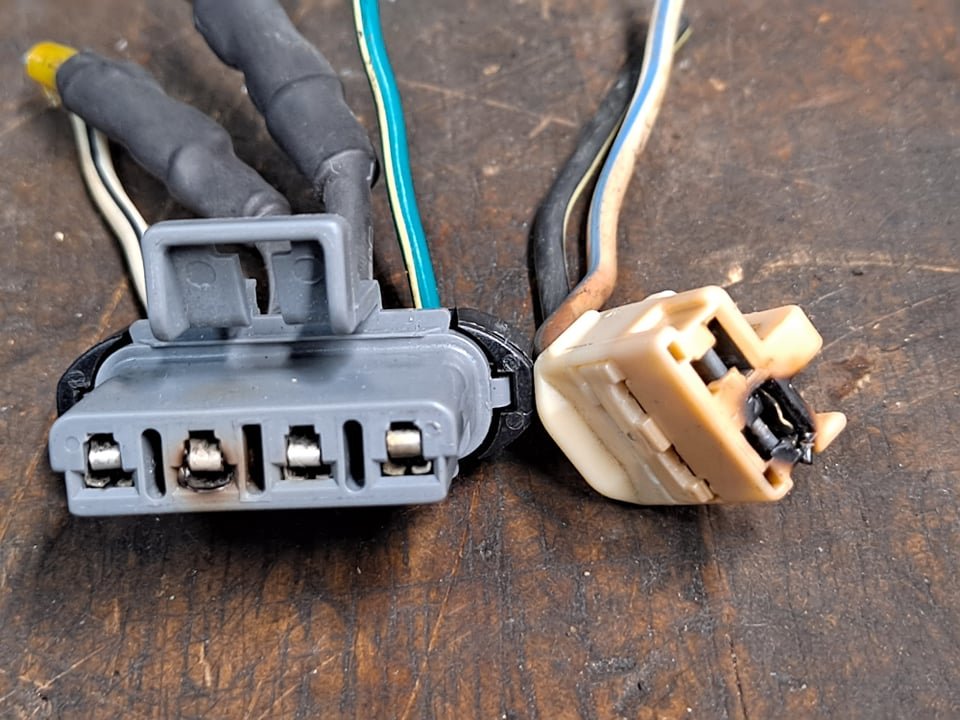

    Resister plug on the left and Blower motor plug on the right.
    241692447_445646066670577_56273528711855_6763e9f8733708c8c0c44a7ddd34d660fedc8dbf.jpg

    That's pretty standard stuff of those years.
    The issue seemed to improve on the later gen models (2011-2015) but the issues were still there.
