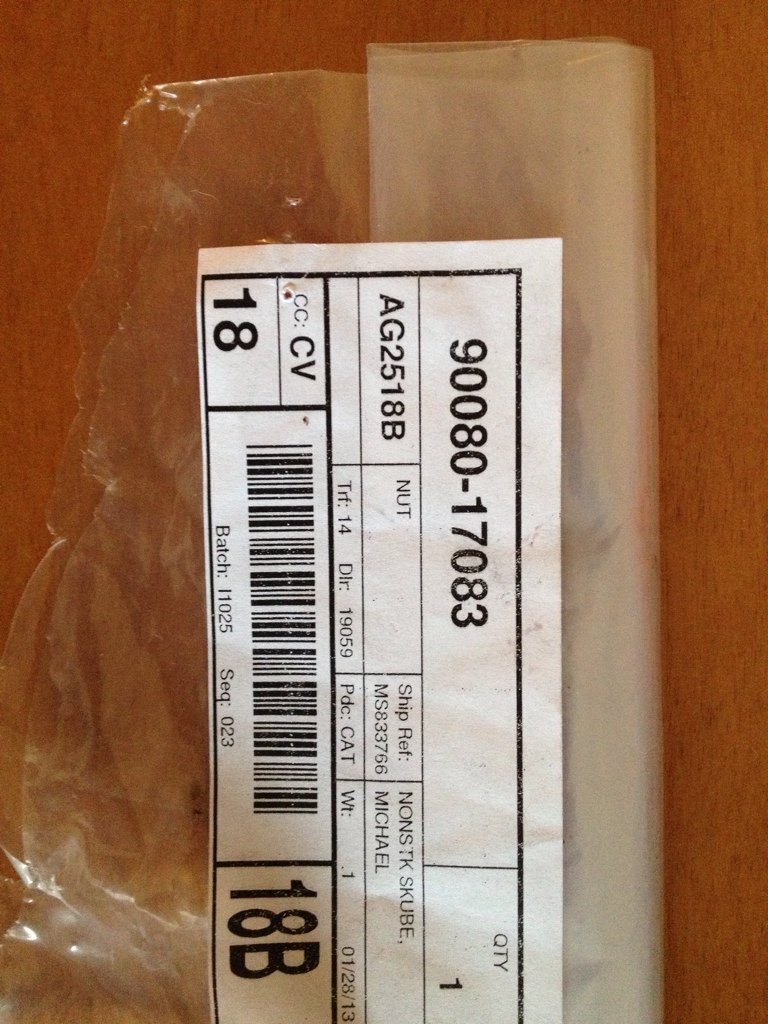

    Ok, so here are the part numbers for the two washers and nut shown -
    NUT - 90080-17083
    Washer - 90080-20048
    Washer - 90080-20049

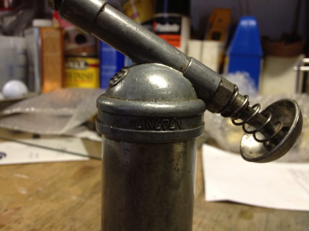

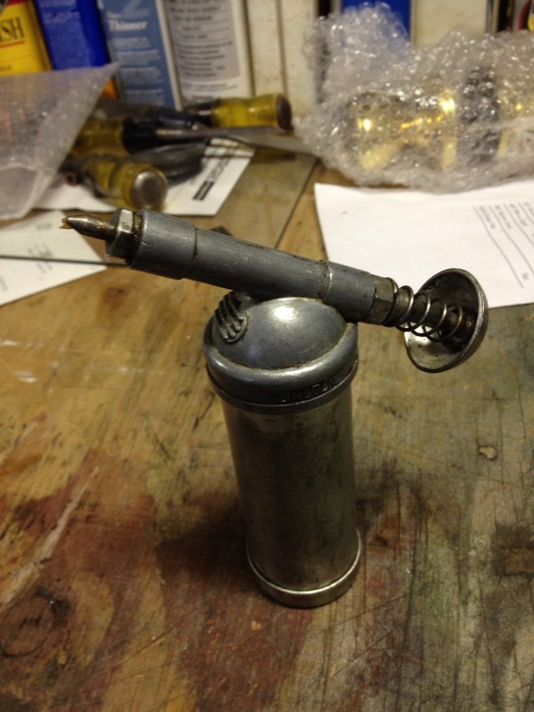

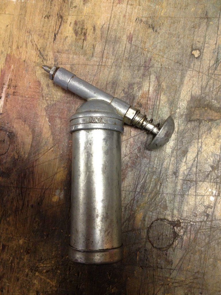

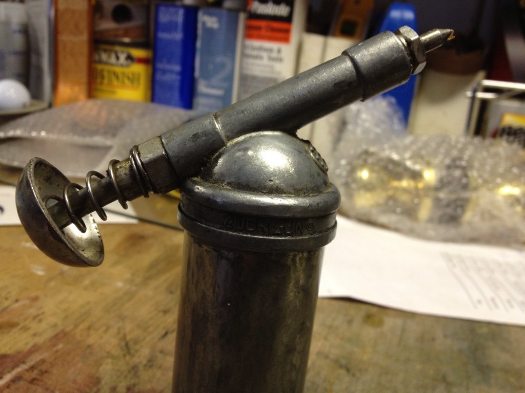

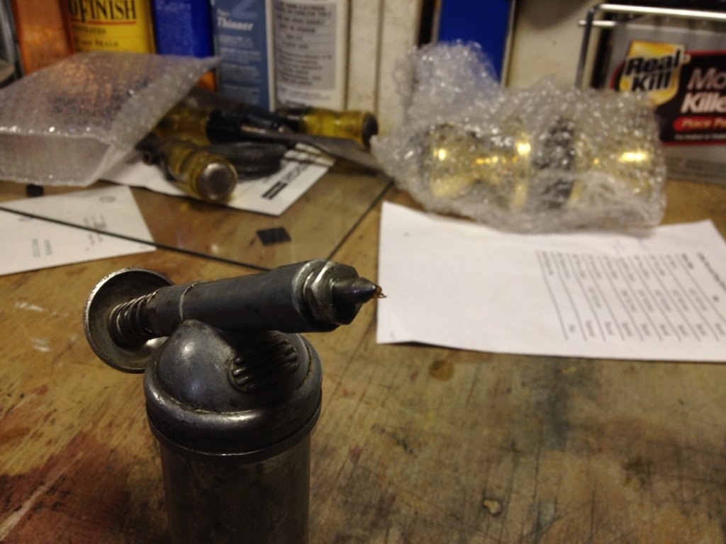

    Also, I figured out what to use to grease them- My father-in-law had a little hand held gun that he uses for his chainsaw, and the tip fits perfectly. Also the gun is rigid, so you can press into the center of the fitting, I was able to grease all of mine, took a little longer because the gun is small, but it worked perfectly. So now the task is to find one online.
    The one he had is made my Lincoln, and called the Lubrigun, and has a chainsaw tip on it, see the attached pictures.
    Here is what I have found online so far -
    (1) http://www.amickssuperstore.com/Dualco_Chainsaw_Grease_Gun_p/dualco grease gun.htm
    Dualco seems to be the best one.
    (2) http://www.mfgsupply.com/32-5801.html?source=googleps&gclid=CLzc-o_lz7UCFckx4AodKzwAIw
    (3) http://www.amazon.com/Dualco-Grease...361737927&sr=8-4&keywords=chainsaw+grease+gun
    (4) http://www.amazon.com/Astro-Pneumatic-Grease-Needle-Nozzle/dp/B000FMK7FG/ref=pd_sbs_sg_8
    No free shipping either, and about the same price after shipping as the better Dualco one.
    (5) http://www.amazon.com/Mini-Grease-short-Needle-Nozzle/dp/B0057GX4XW/ref=pd_sbs_sg_6
    (6) http://www.amazon.com/Oregon-Chain-...361737927&sr=8-2&keywords=chainsaw+grease+gun

    8F9B6C44-FE14-4CE4-82FC-A204EAB92FC2-419_0175a5340cf2d64a249ea3aaa141ae495379ded0.jpg
    98CDF23D-C62C-4555-B050-706CD34B2E00-419_e52883aa0584dbf41b5f946538f179cd3e199bad.jpg
    C1778ACF-1DA5-4AAB-B718-E39B4DB22B6A-419_5f3c2b197aa061503291d495293856a16c90fead.jpg
    47E522F1-2643-475F-864B-0FA2E59DADB8-419_aaf77637ea7b6a6b32de8507eb46256b90fa79ba.jpg
    0FD80415-7B85-4FDA-B7C7-EC0AFADC2282-419_78fac40f2985d2c50b5b30f291d01f7da1760bbe.jpg

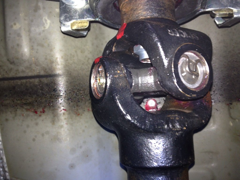

    Another picture of the slip yoke grease fitting, so far so good, have about 1000 miles on it so far.
    5FB53062-22C7-46EF-8FA4-09D989D521B9-419_4d476fe9eb4b061f1eee6d98fe59ce46035e0e38.jpg

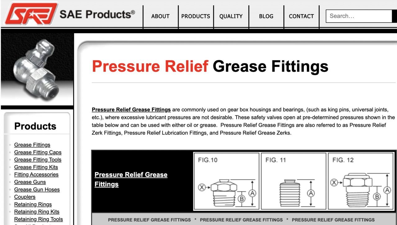

    If one was really intent on being able to grease the slip joint without disassembling it, you could use the normal zerk fitting to inject new grease, then unscrew the normal zerk fitting and replace it with an identically-threaded pressure-relief grease fitting. Leave the pressure-relief fitting on for normal everyday use. As heat & mechanical cycling push the new grease around inside the joint, the pressure-relief fitting would allow excess air or grease pressure to escape easily, while still keeping contaminants from getting into the joint.
