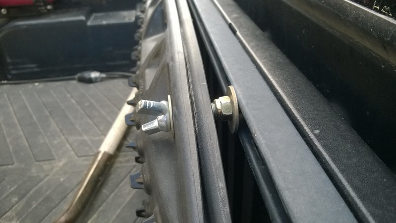

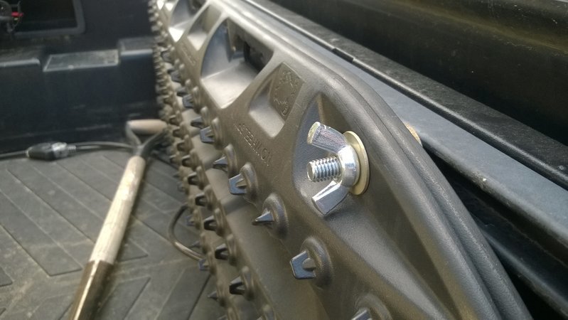

    I have mine mounted against the back of the bed. Carriage bolts through the rail, then a washer and nut to secure the bolt. Max trax onto the bolt and then wing nut to tighten them down. Works great.

    Do you have photos of your mount so I can get a visual? Thanks! Sorry, I have deslxia and it's hard for me to comprehend just words!

    In the first picture you can see the carriage bolt coming through the rail with the washer and nut holding it in place. Second picture is with the wingnut which holds the boards in place. Hope that helps.

    Thanks Matt! That's super helpful and I'm gonna install it manana after getting the parts at the store! I'll be sure to post some photos!

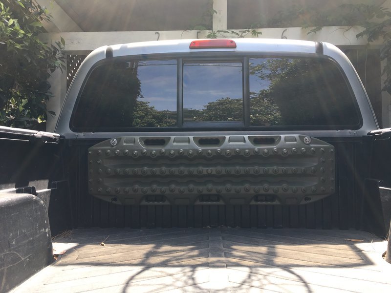

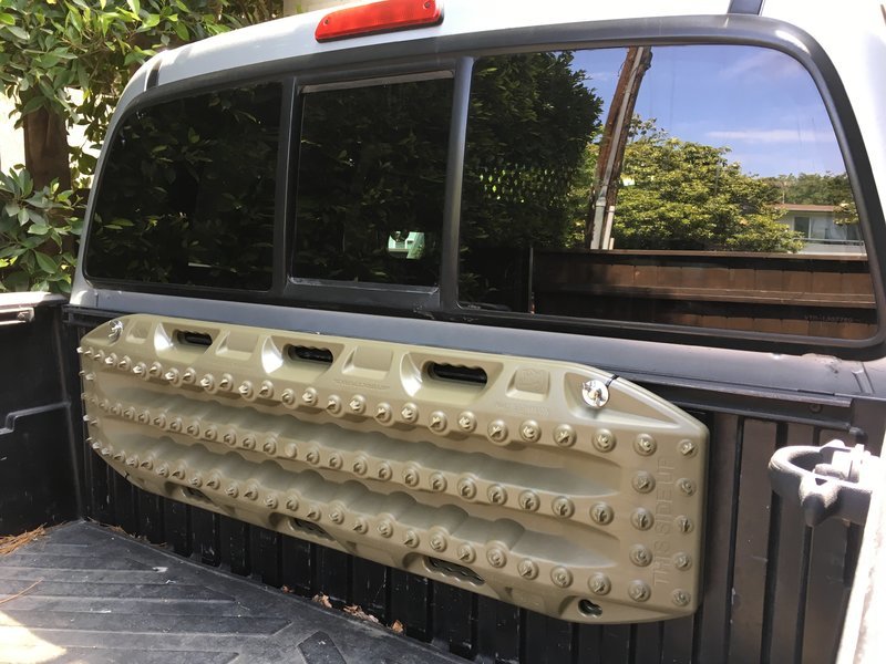

    Viola! Easy! Thanks everyone!

    Very ninja turtlely in a great way.

    Gotta love it! I'm going for a Grey/Olive Green theme! lol
