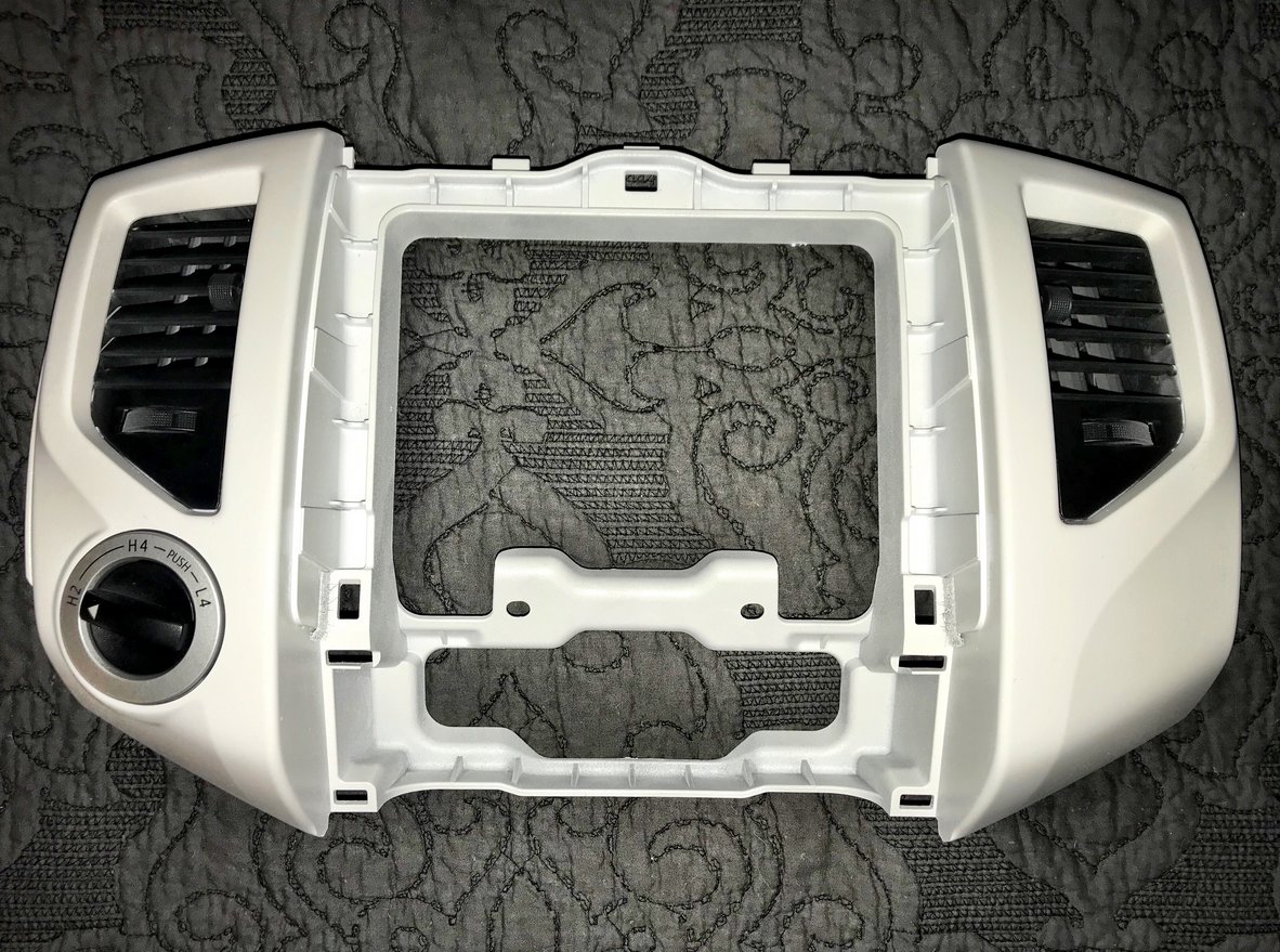

    That looks awesome! What was your method for painting it? I'm very interested in doing this too mine. There are a lot of different ways to do it apparently. Yours came out great!
  14. Sep 13, 2019 at 7:08 PM
    #994
    lechicklet
    lechicklet Well-Known Member
    Aug 18, 2018
    #263227
    207
    Chey
    California
    ‘13 4WD DblCab Ltd

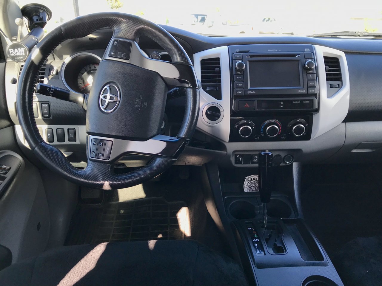

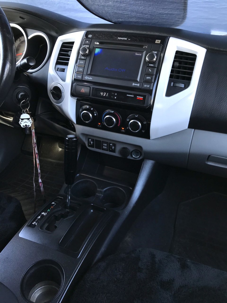

    Thanks! I'm really fond of it myself ;)
    Use a soft plastic tool to pop off the plastic radio bezel and remove the screws holding your radio (I think there were 4 screws.) The climate control unit pops off pretty easily with that same plastic tool. (A screwdriver will likely damage your dash if you try.)
    Once you’ve removed the radio and the climate console, you can remove the large silver plastic surround piece, it’s one big piece of plastic and it should pop off with a solid grip and some gumption.
    Prep
    I used steel wool to buff the silver plastic, then alcohol to clean it off. (Sandpaper was too rough for the soft plastic, so I don’t recommend it.) Then use painters tape and cover up the air vents and 4x4 controls.
    The trick to the paint job was to apply many light coats. Light coats are the best way to get a smooth, even finish. I got white primer, which really helped with the pop of the white paint. I did about a coat every 45min for the primer and paint, and about 20min for the Gloss. You definitely want to let it cure for at least 12 hours before reinstalling it. I recommend 24hrs, but 12 might suffice in a pinch if you’re EXTRA careful and don’t want a single scratch (because putting the radio and climate pieces back could potentially scratch the paint.)
    Paint
    I used Rustoleum "2X Ultra Cover" products and I'm super happy with it so far. Make sure you get the kind that bonds to plastic.
    Primer - 3 light coats
    2-in-1 Paint - 3 light coats
    Clear Gloss - 4 light coats
    I did extra gloss coats because it’s a spot with a lot of hand contact. Def don't want grease and dirt getting to the actual paint, and so far the extra gloss coats have done their job.
    So far, I’ve been super careful not to use any strong cleaning products for it. Sudsy soap and warm water work just fine to get any grime or smudges off. Pick a day where you're home and around the house doing errands and you can pop outside for a quick coat every so often and it goes by in not time at all.
    Here's what it looked like after painting it:

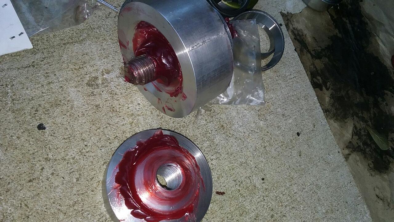

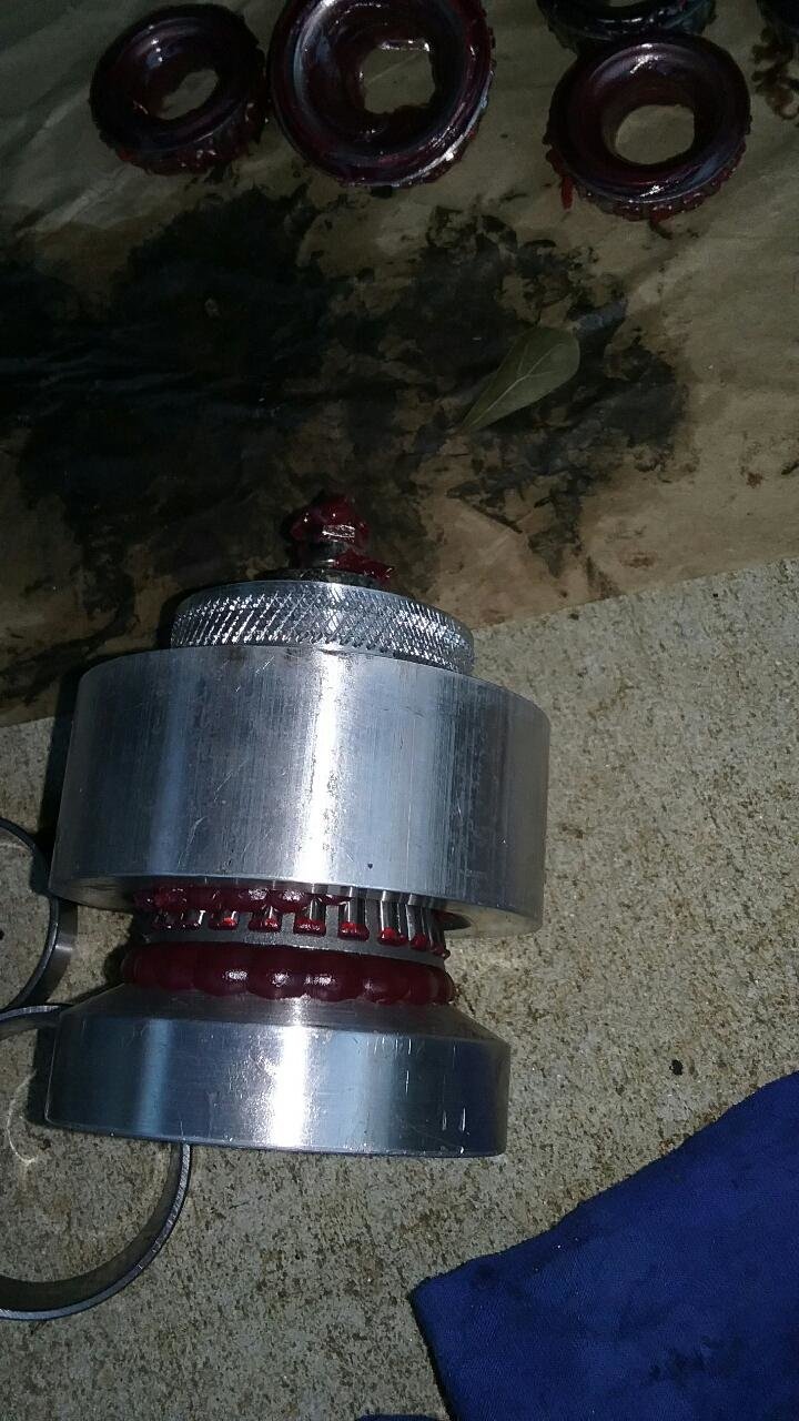

    Not sure why I haven't built me one of these before now. Seen some plastic ones but I built one a Mack truck could run over and not hurt it. Packed a few wheel bearings in no time and not nearly as messy .
