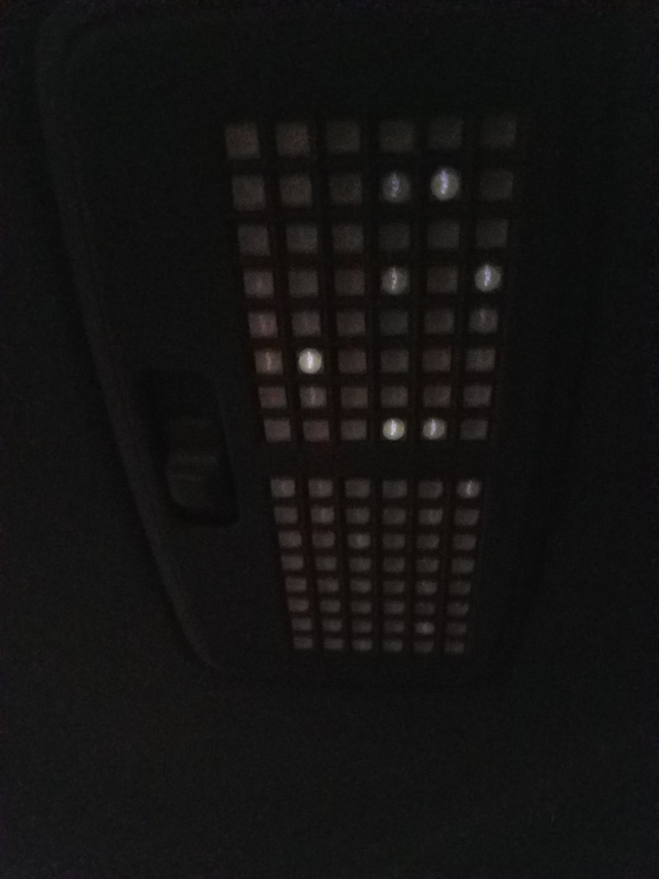

    @mesojdm,
    Thanks for the fast shipping, I received the light today. It's very simple to install and super bright.
    I do run into an unusual "glowing" of a handful of LEDs after the light went off, they stay lit and don't seems to go off thereafter. Any advice?

    This is on a 2nd gen correct? There have been stories of this same thing happening(with other LED bulbs) but its is not common at all. It looks like the truck dome circuit does not see enough resistance, and somehow still powers the light(just barely). It was solved by putting a resistor in the dome light (100OHM 1W) as seen here https://www.tacomaworld.com/threads/interior-l-e-d-dome-lights-gets-dim-when-truck-is-off.514835/
    I'm happy to send you another set of LED boards, but it might be something on the truck side.

    Thanks for the quick response Sir. Yes, this is for the Gen 2 Tacoma, I will try to follow the advise of the link above to add a 100 ohm, 1W resistor to it, assuming the resistor doesn't have polarity connect issue right?
    I will let you know if that fixed it.

    Resistors aren't polarity sensitve.
