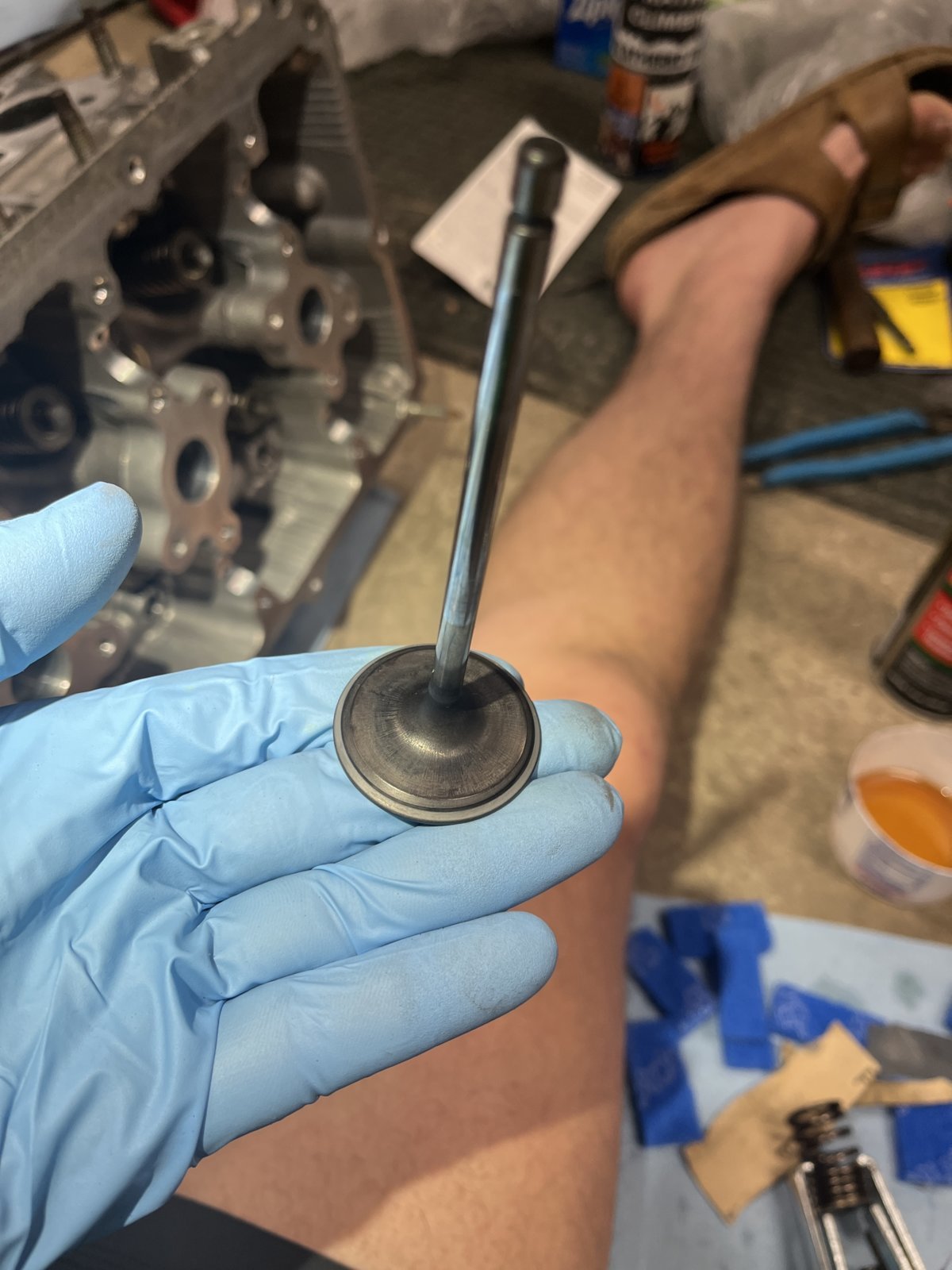

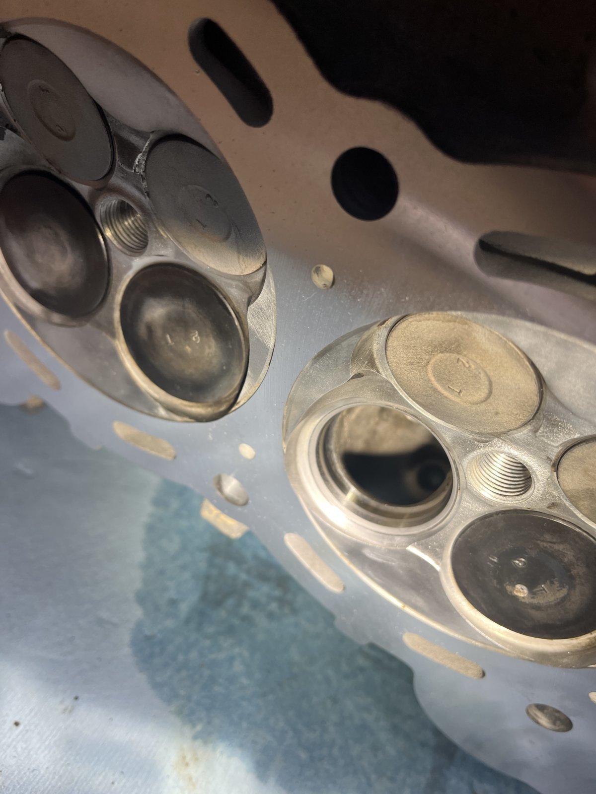

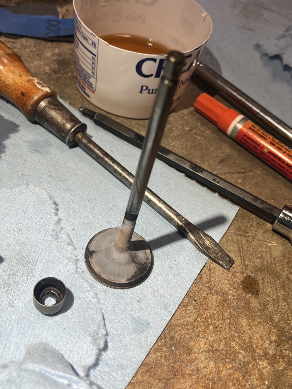

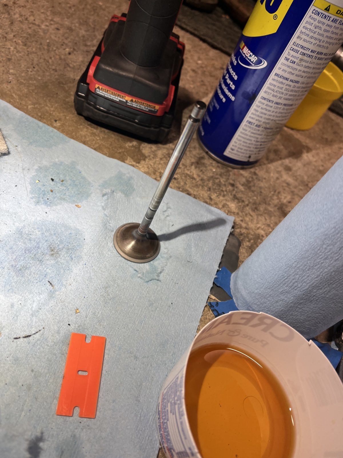

    Made more progress yesterday from 7/16 valves to 13/16. Boy are the exhaust valves a pain. So satisfying to see the ports and the valves and everything clean though. Just when I developed a good rhythm I switched to the exhaust valves and had to change everything completely. In case it’s useful:
    Intake: Remove cap, compress and remove spring and holders, remove valve, remove old seal, clean port and valve, run brakleen and a small soaked piece of shop towel through the guide, apply oil to valve, insert, lap, check, repeat if necessary, otherwise add valve stem seal (I have decided I like using the stem of the valve to help align it), and reassemble. With the exhaust valves and ports I have been using tougher grades of scotchbrite and oven cleaner to make it work. In fact, I find the port side of the exhaust valve guide to be dirty, so I have been using less aggressive tiny scotch brite pads and oven cleaner with tweezers to get down in the hold from the block side of the head.
    I also recognize that the 220 grit the valve grinding compound gets down to is not fine enough for a really good seal. Good thing is I am not building a race car, I am simply trying to restore the condition of the engine to near stock.

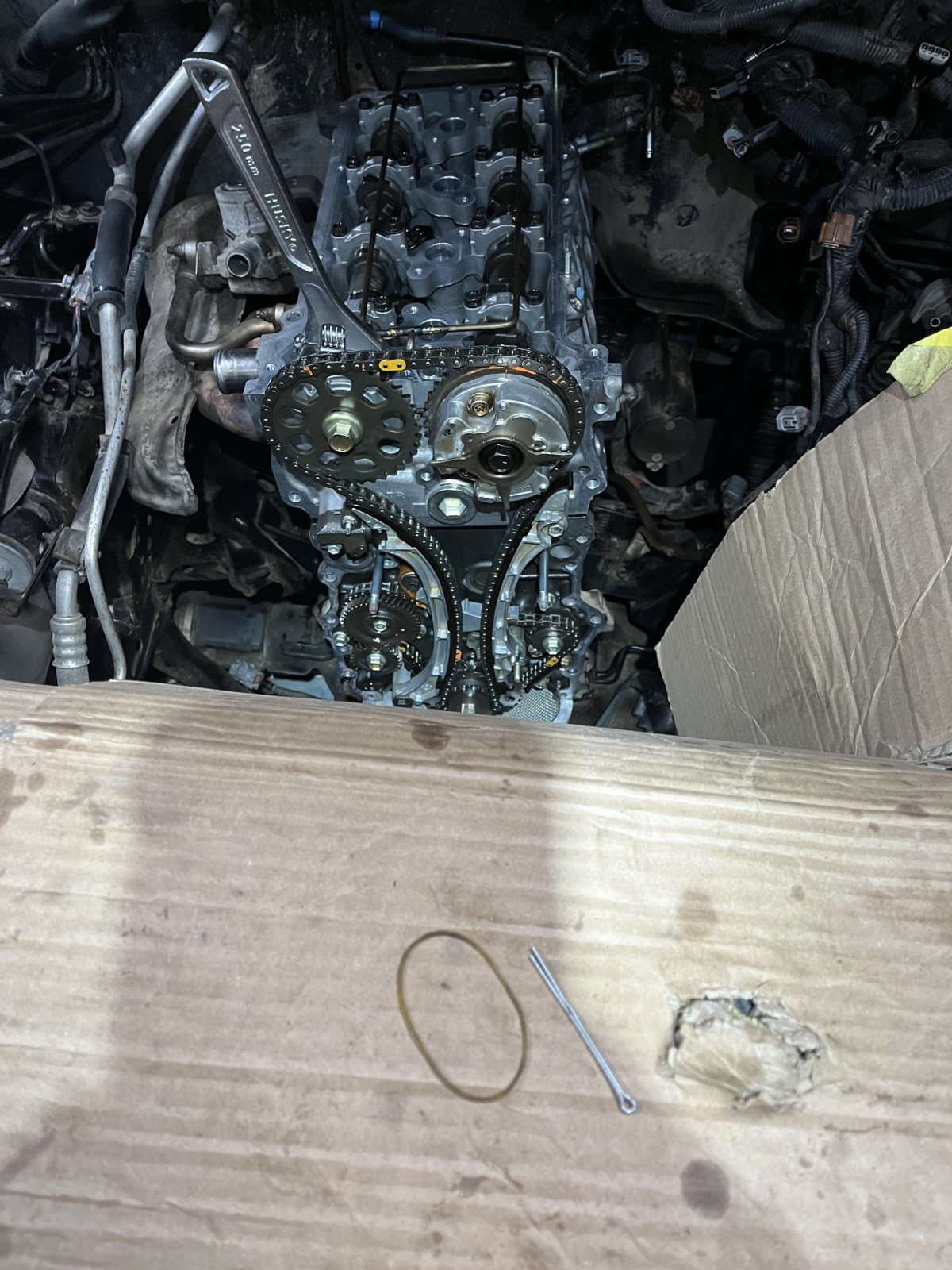

    Update time. Got the head back on and the timing together.
    While the first couple of valves were a lot of fun, two days later I was pulling my hair out. I also have to say, the time stress of trying to get things on before the FIPG cures... not so fun. Getting the head on was super frustrating, especially considering I forgot to put on the exhaust manifold gasket and then had a hell of a time trying to get the exhaust manifold to back off the studs, and then also back on with the head in place. I highly suggest remembering to put gaskets in places that are important. I used a piece of cardboard between the hg and head while getting the dowels lined up. I think it took me 22 minutes to get the head bolts fully torqued compared to the recommended 15. No way in hell was I going to take it all apart for those 7 minutes, that seems ludicrous. For some reason, the timing went together very easily and that pleased me greatly. I am now prepping to put the timing cover back on and good lord is the FSM convoluted when it comes to that. My FSM also does not seem to mention using the special coolant sealant around the coolant ports but I will be doing that anyway. Time to go hunting for the TW posts about it again.

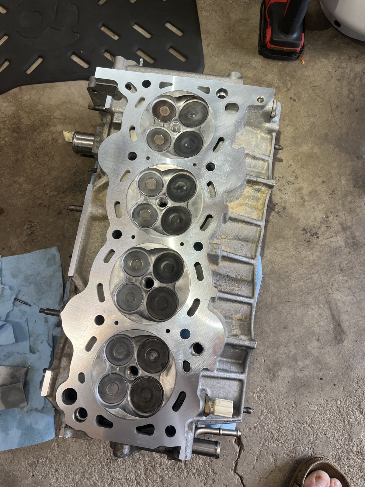

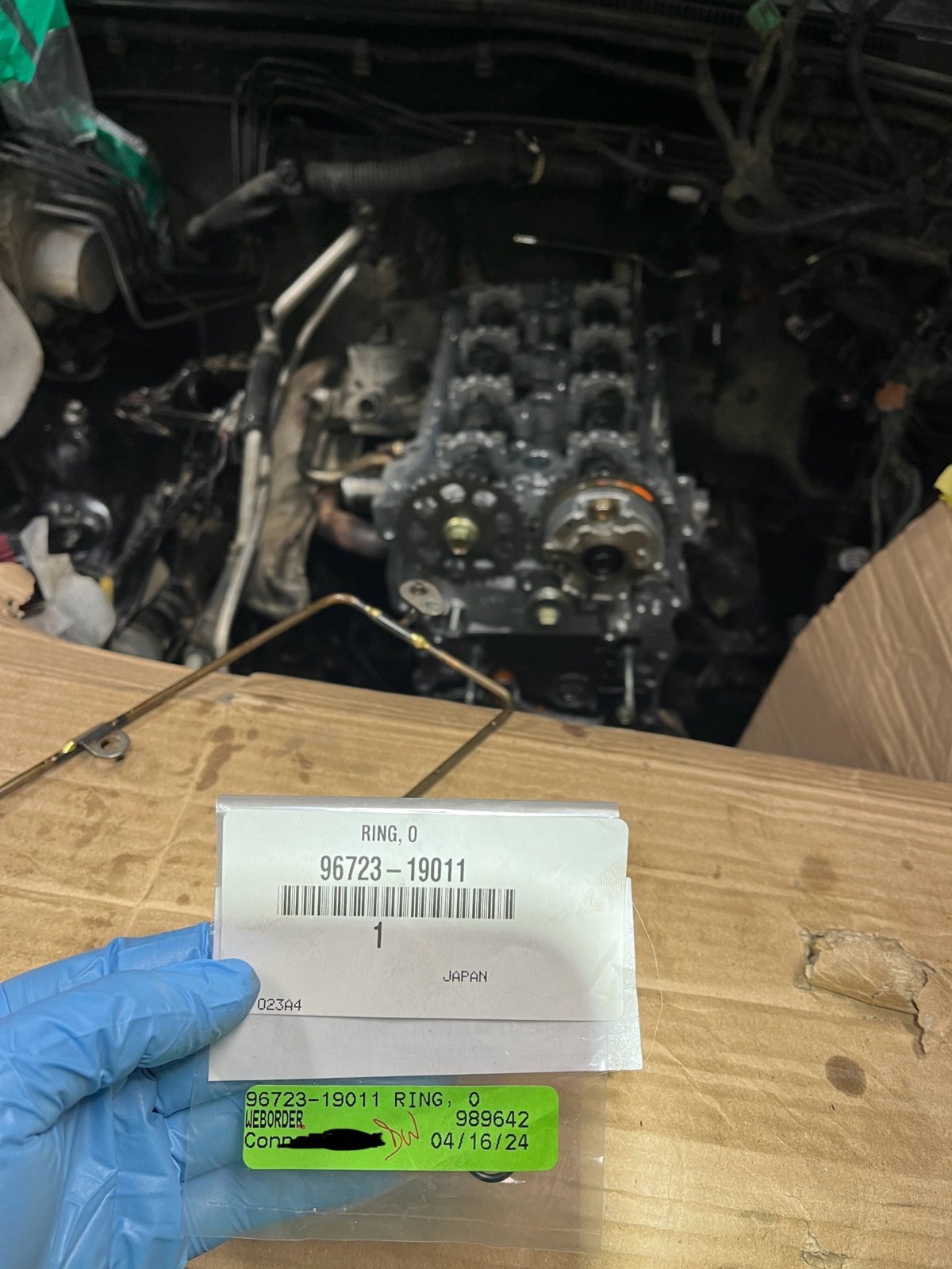

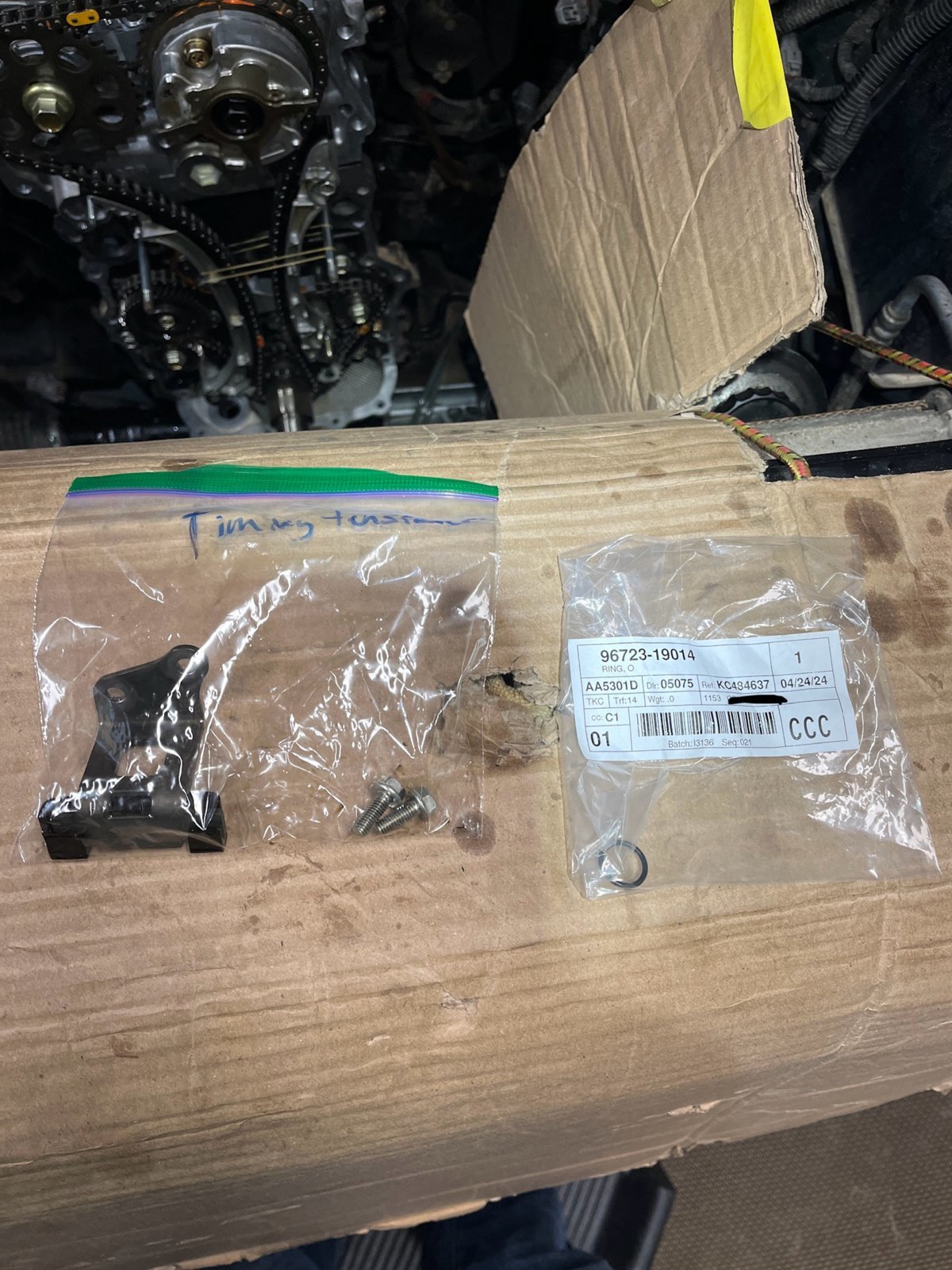

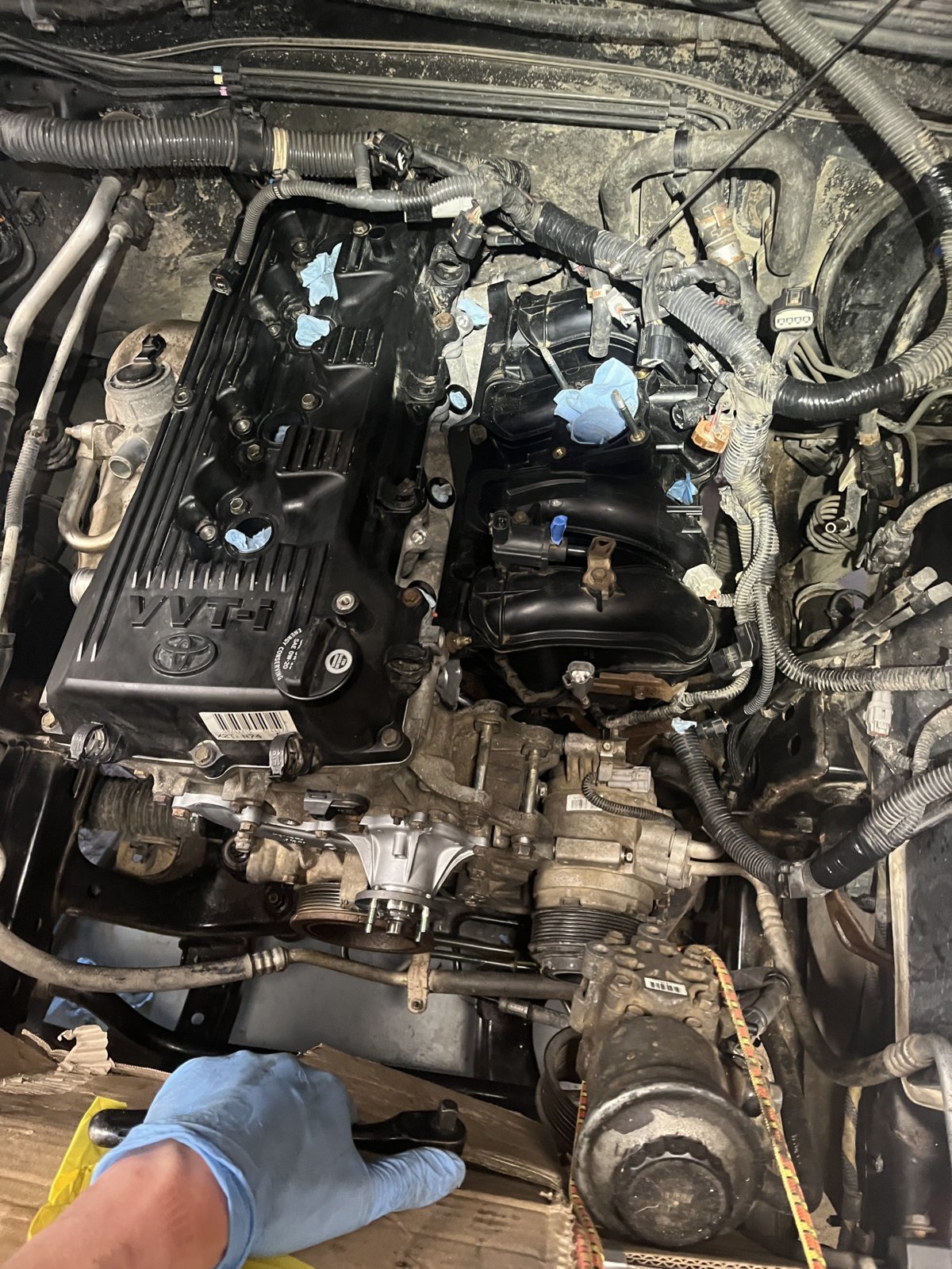

    More images.
    1. Camshaft oil delivery pipe and its’ o-ring and part number.
    2. The top timing chain guide and its’ o-ring and part number.
    3. A clean and lapped exhaust valve seat.

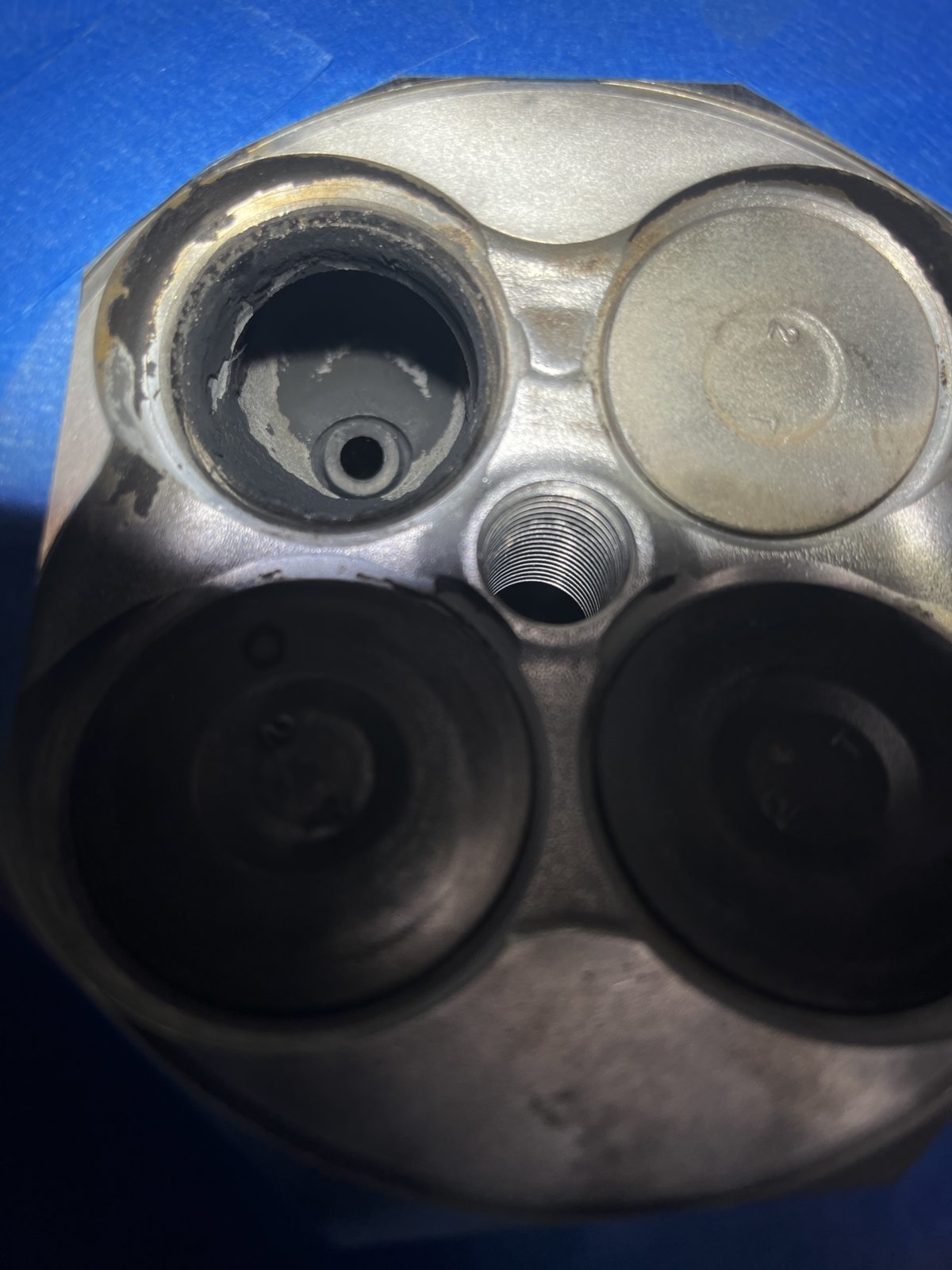

    4. The head ready for installation after I put a tiny scratch in it going over it with the shop vac one more time. The plastic nozzle thing myst have had debris on it. I was really kicking myself. I sanded the scratch down with 5000 grit sandpaper and I couldn’t even feel it with my fingernail. I also found another tiny bit of debris that had become lodged in the aluminum, probably while flipping it over many times cleaning and lapping valves. I sanded that down with 5000 too and eventually decided I had lost enough of my mind about it and that it was either going to work or not and it needed to go back on the block. There comes a point where more deliberation doesn’t actually add anything.

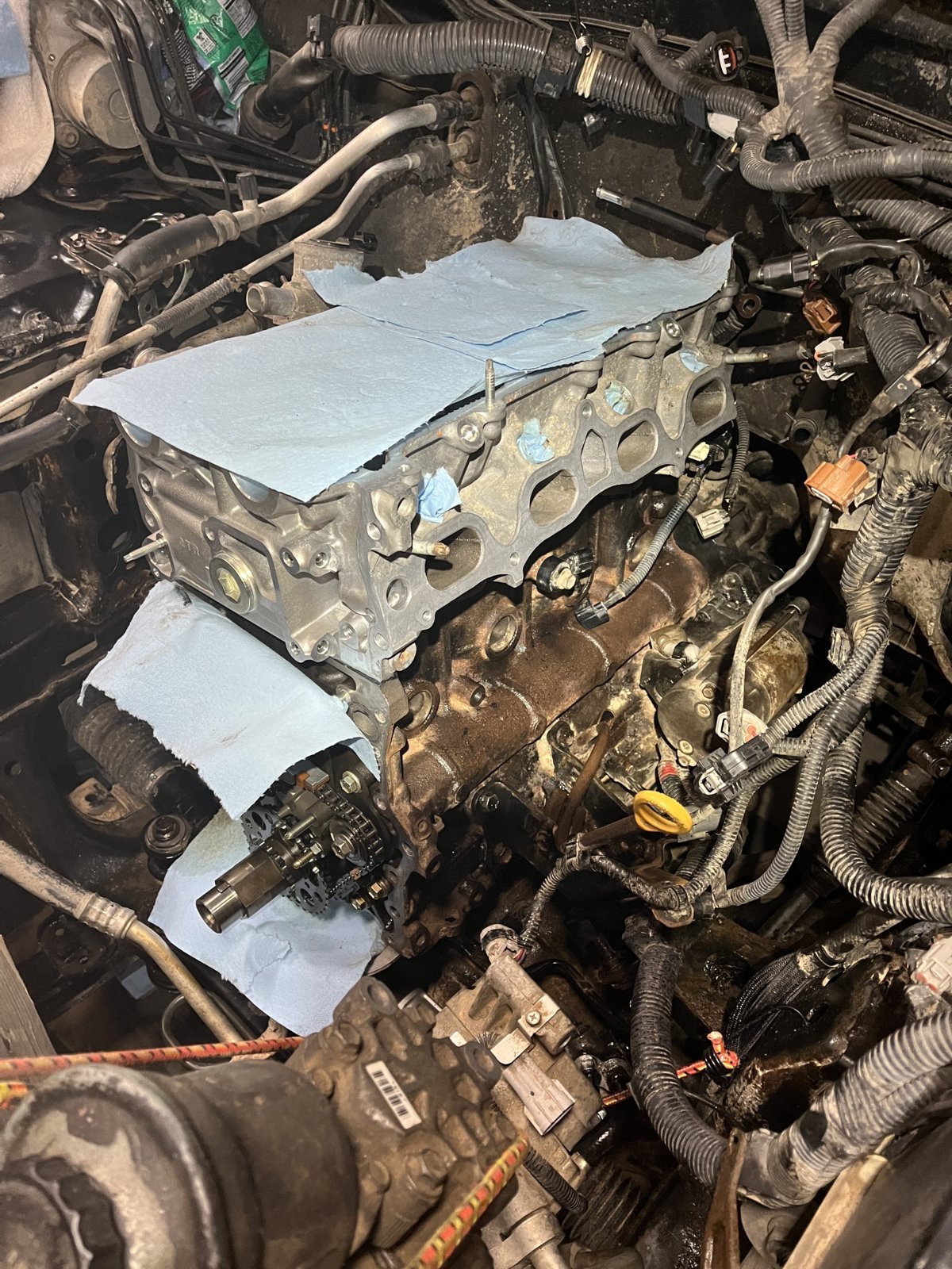

    5. The head after installation and the engine bay sporting some new fluid film lol. Figured I might as well. My family group chat made fun of the head being cleaner than everything else in the engine bay.

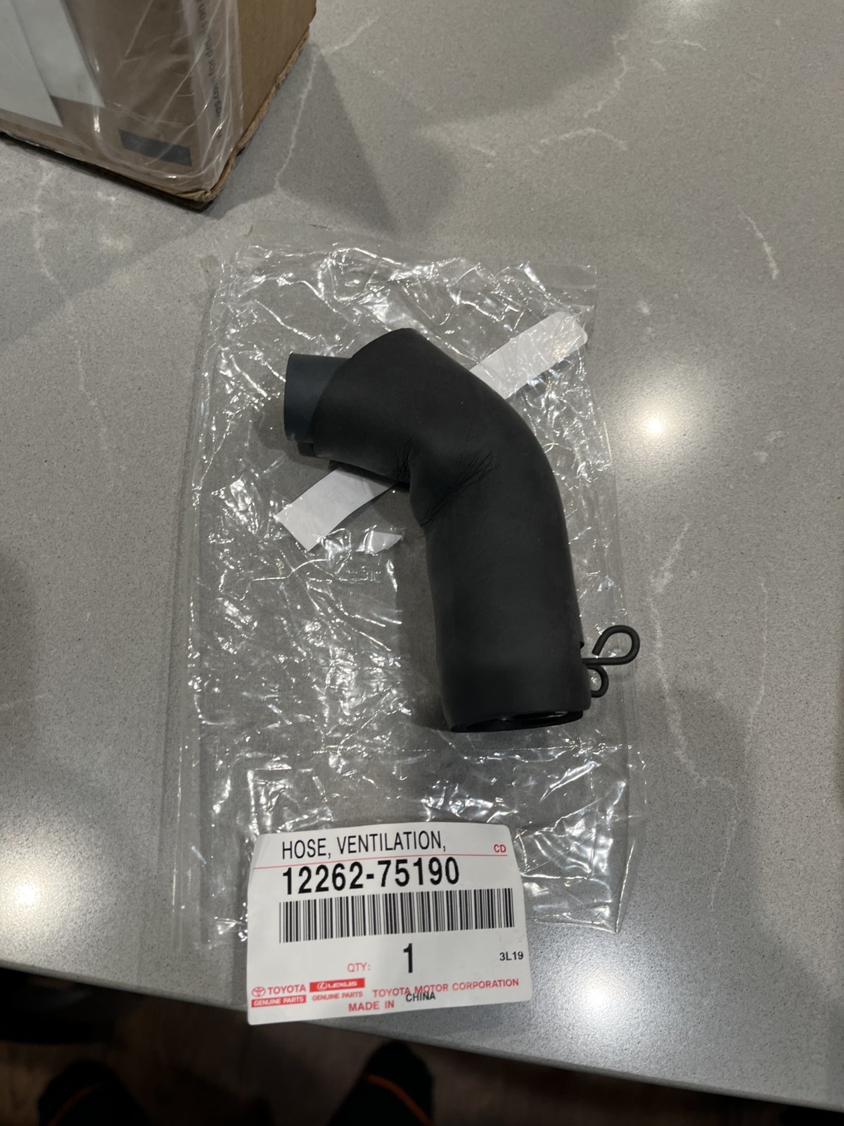

    6. One of the dumb formed hoses from the air intake.

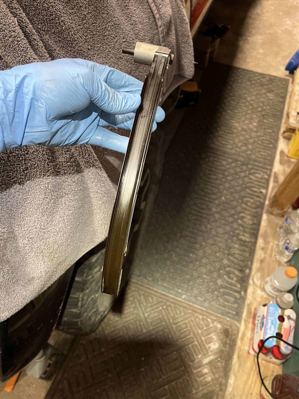

    7. Reinstalling one of the timing chain guides which seems to have a bit of wear at the top. Whatever. I elected not to replace any of the timing components. They are expensive and the ones in there seem to work.

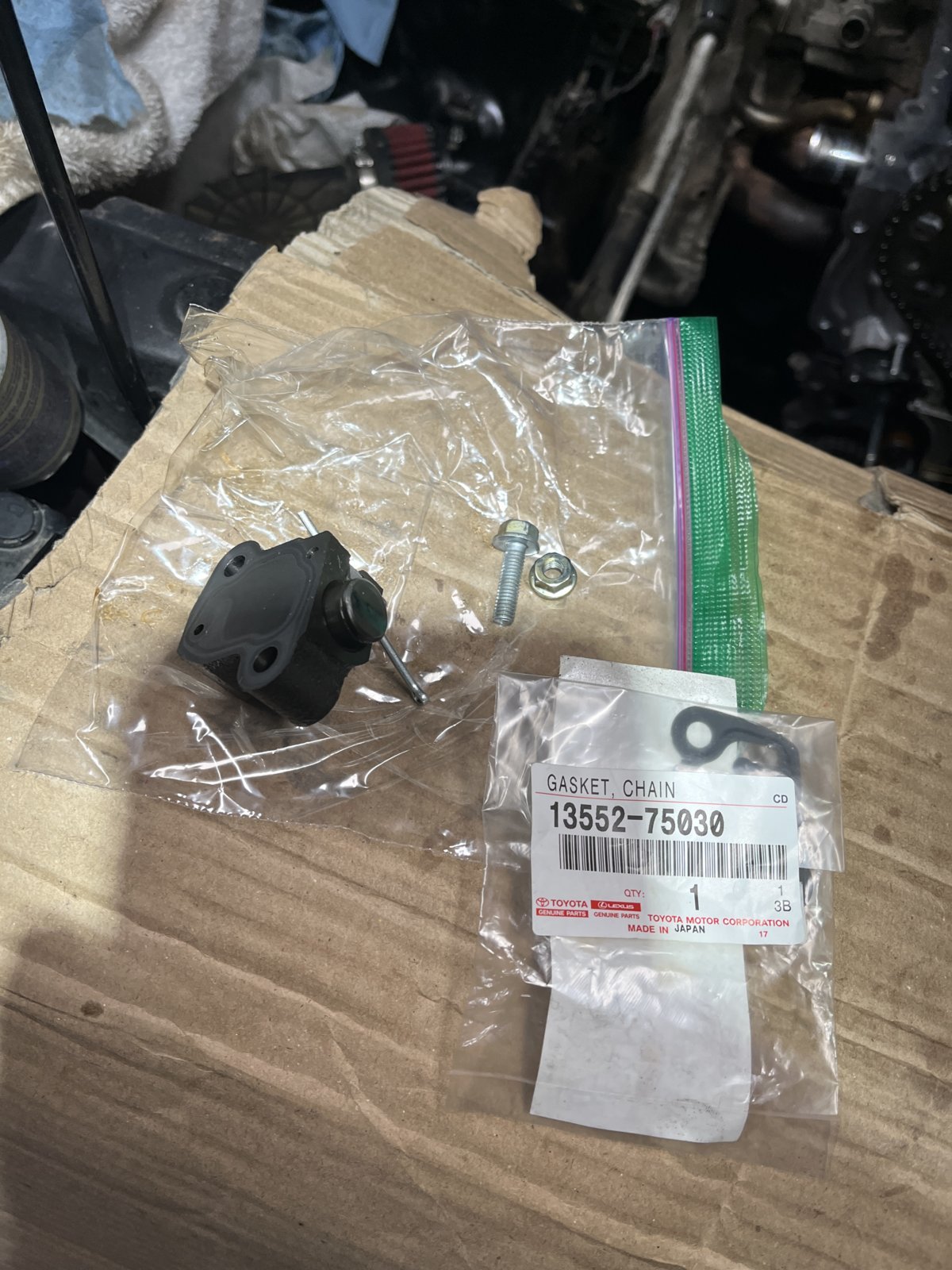

    8. The chain tensioner and its’ gasket and part number. I note that the wings on this gasket are slightly different from the old one I pulled off during disassembly.
    9. The timing back together and the rubber band and cotter pin I used. The cotter pin was perfect for the chain tensioner because you can secure it in place once you have it off. It took many tries for the plunger to depress on disassembly but patience prevailed. The camshafts were not jumping so much on assembly and so I was able to easily maneuver them into place and kind of coax the crankshaft gear onto the chain in the correct place. I took a reference picture before disassembly that matches the assembly photo perfectly and this made life so much easier. The painted chain links and previous paint marks also helped.
