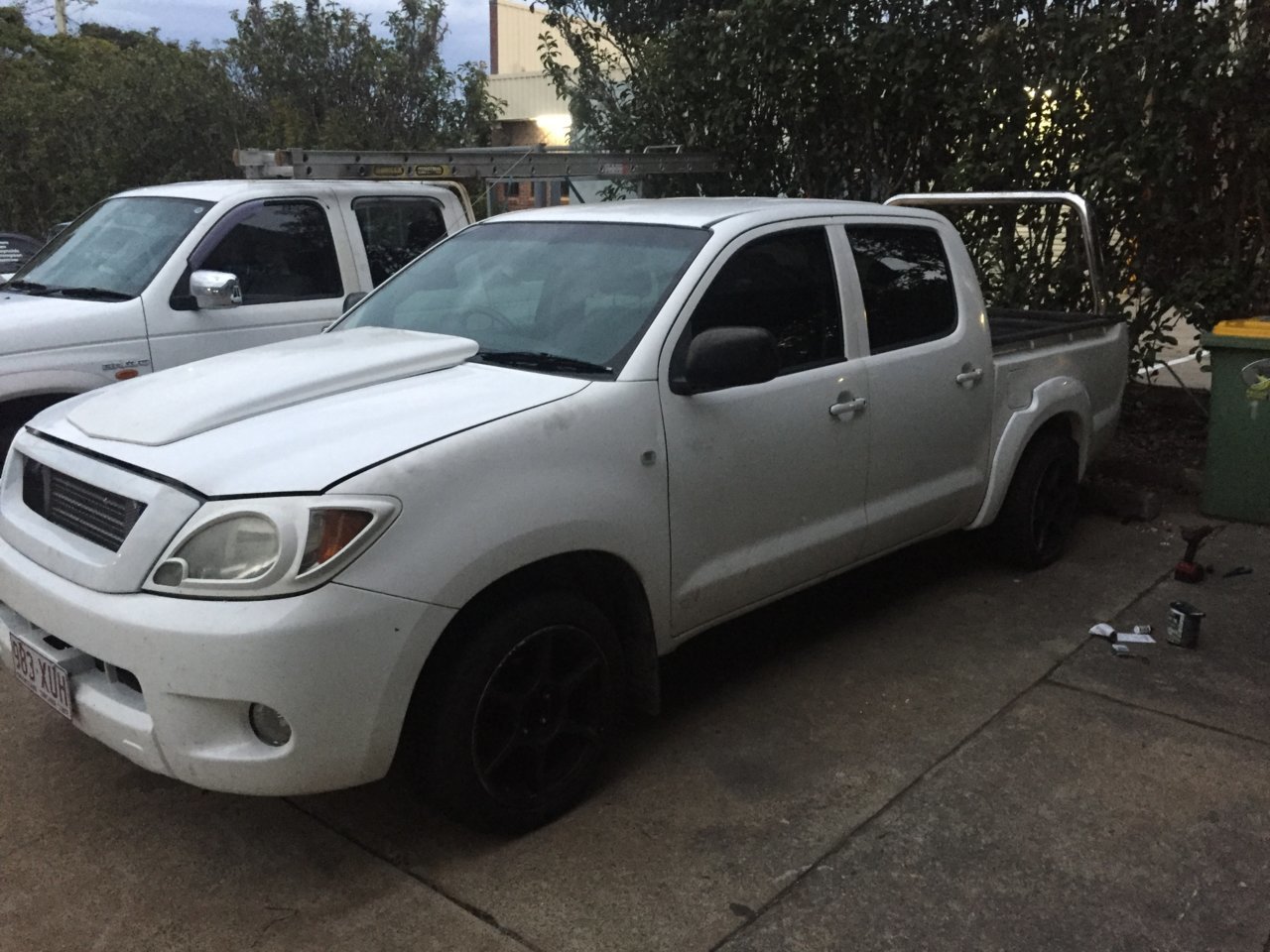

    Read it! Enjoyed every page haha. Thank you BassAckwards. My build was based around the look of the F150 lightning but in a smaller more 'aussie' way (read price of fuel and rego is stupidly high here). How she was looking in pic 1 when it was going.. pic 2 and 3 is how she is now with the upgraded harness etc..
