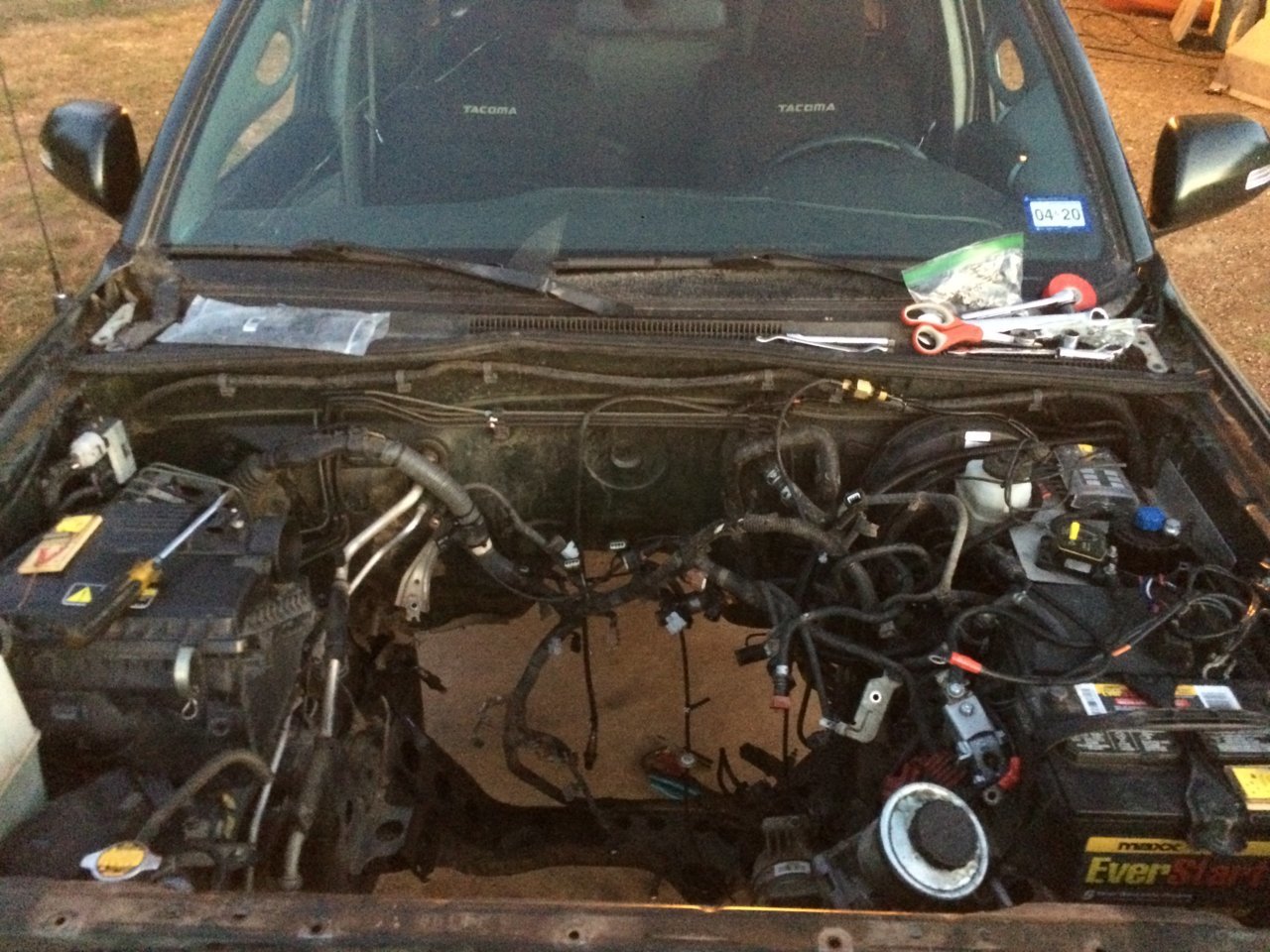

    Motor seemed to be okay other than the leak but the crank damper was broken off during the wreck. I didn't do a compression test after it started puking oil, so I can't say for sure about the overall health of it. I already took it back out and back to the yard though. I got pissed that they hid the issue from me so I took it all back apart and cut my losses.
    Thinking about trying to take mine apart and learn something now.. I have already come this far, seems like if I can tear down the old one, and take the block & head somewhere to get cleaned up then I may be able to turn this situation around. Does that sound like a ridiculous proposition? I have never worked on motor internals but I am gonna have to learn at some point. Seems like a good opportunity to try

    It isn't. There have been a few on here who have done just that.
