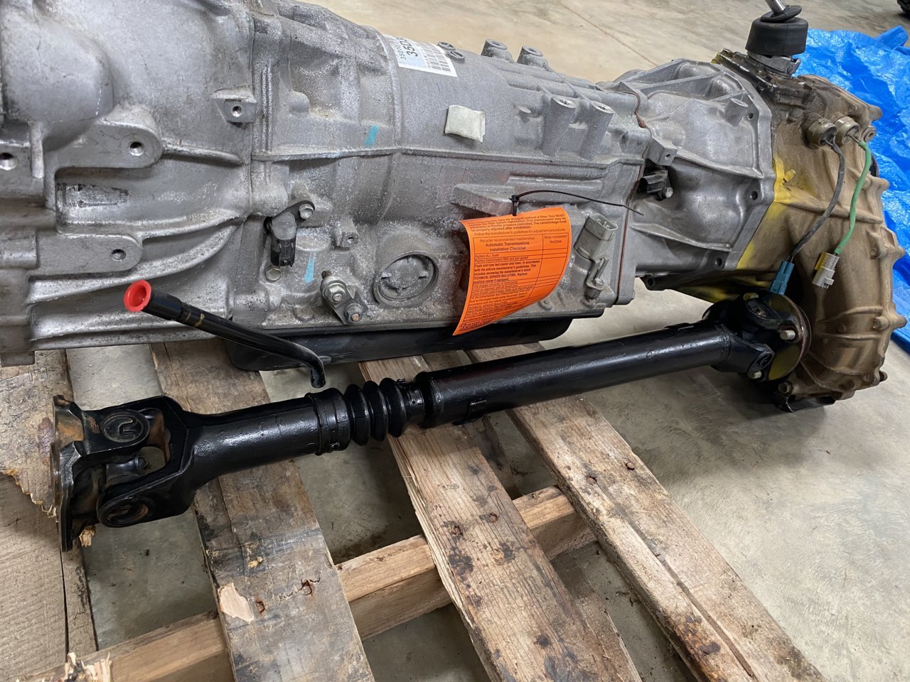

    Can someone with a 2.7 4x4 show me how this portion looks under your truck? It looks as if the driveshaft is going to touch the dipstick

    It won’t. The diff is lower than you have it imagined there. I’ll send you a picture a bit later.

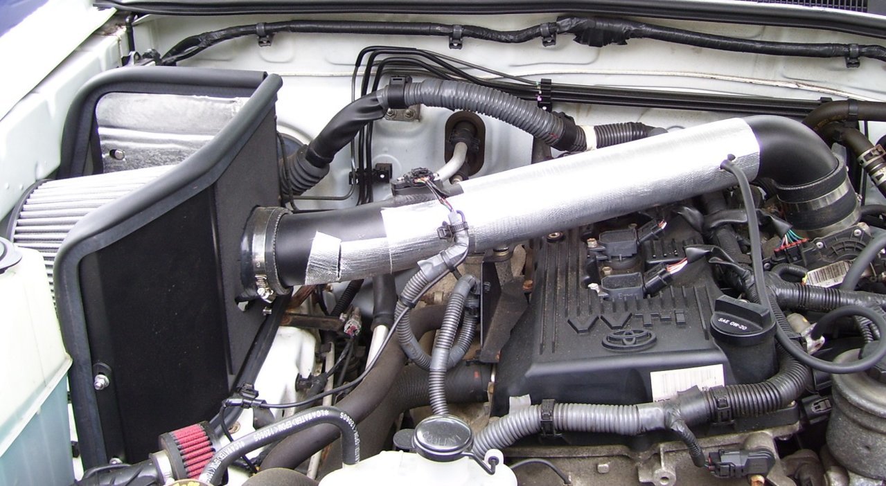

    Figured I would add to this. I made a run to the beach this week which was a bit of 55-65 mph driving combined with a lot of 30-35 stop and go with all the traffic lights at the beach. Almost got 20 mpg and the tank was topped off more than the previous fill up so it might have been 20 mpg in reality. But comparing 6 fillups since I put the AFD CAI back on with the heat wrap to the same time frame last year with the stock airbox, CAI avg is 18.07 and stock airbox was 17.06 mpg. CAI high was 19.95 mpg and stock was 17.8 on mostly higher speed runs but both had traffic lights (same road actually) but I don't like comparing a single fillup since you can't verify top offs are the same. Same tires as well as everything else (truck actually has more weight now with the rollbar but not a big difference) so it seems to be a pretty even comparison. I think I have a little more highway on the CAI this year but I've never had a true all highway fillup either way so I'm sure it would pull down 20+ if I did. It looks like the CAI is worth .75 to 1 mpg over the stock airbox and with the heat wrap, the temps were only 2-4 degrees different while moving. My guess is that the straighter/smoother airflow does make a difference. As we get into the colder weather, I'm sure the difference won't be much with the winter gas but I'll keep an eye on it. I doubt there is any HP difference but for people who drive longer distances daily, it might be worth it.
