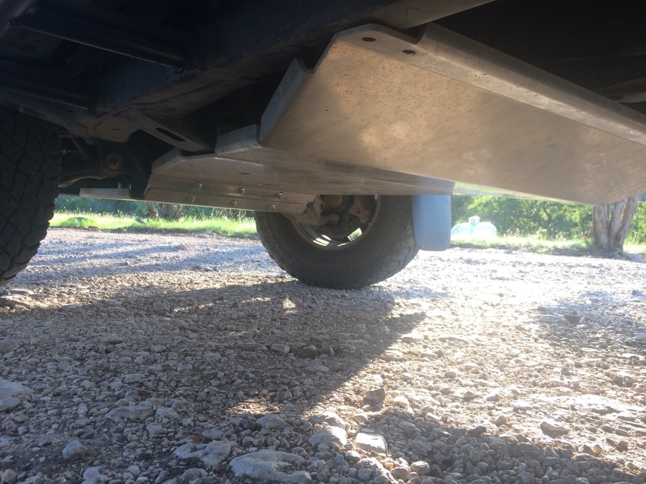

    I have an access cab 2.7 prerunner with full pelfreybilt skids. Had to make a filler piece to bridge the gap between the ifs and trans skid. You may not have to do this since you modified your cross member for 4wd but I can't say for sure

    Ive got an RCI front skid now, just not sure if the mid and tcase will work with my truck. The IFS skid does but thats not the tricky part lol.

    Mid and t-case should bolt right up to the trans crossmember, but you'll likely have a gap between the IFS and trans skid.. You didnt modify the actual location of the cross member on the frame right? just where the mounting point is at the center of the cross member? if so i think you'll have to do something similar to me to get them to fit. Similar to what would be needed to make em work on a prerunner

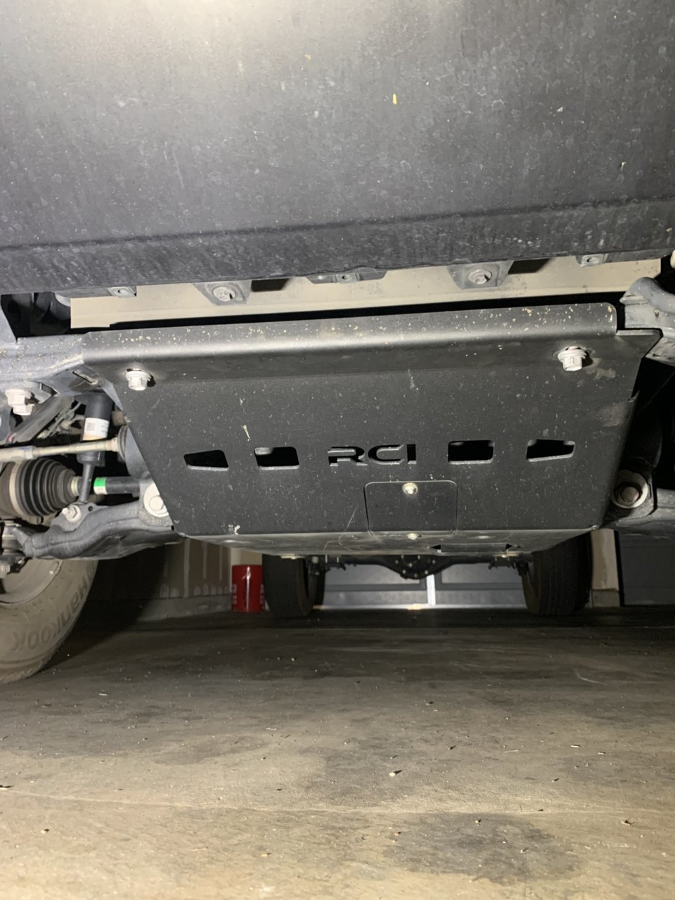

    Yup, I have the RCI steel skid up front with 3rd gen 2.7. 15 min instal tops and easily removable for oil changes - it does have a cut out by the plug but I find it a lot easier (and less messy) to just take it off. Takes once dropping the filter on it with oil everywhere to just take the extra 5 min and remove the skid

    I have that one im more so talking about mid and tcase
