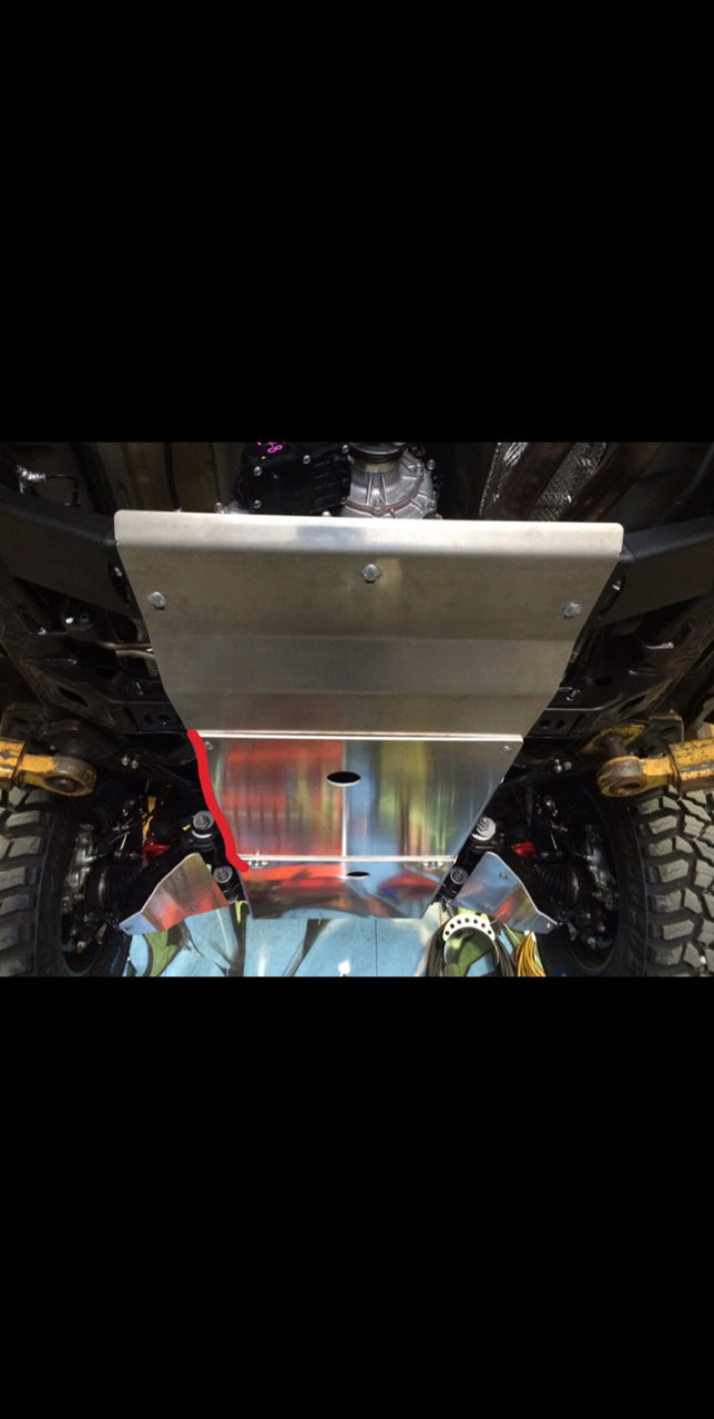

    Yes, i didn't modify location of cross member. I just dripped it about and inch by cutting some of the top portion off. Nothing else was changed.

    When i started trying to figure out what it'd take to make mine fit, i started by installing the T-case skid, then the trans skid (used the same cross member bolts to mount), and then i threw the IFS skid on and saw what would need to happen to join them. Maybe give this a try since you are essentially fitting them on a prerunner crossmember. Also not sure how different RCI skids are, but that could take some different modifications to get them to work. Good luck! Curious what you have to do to get them to fit

    i emailed them to see what they would say. On website it says 4x4 trucks only but obviously that was not the case because i fit the front skid up to my prerunner.

    Ahhh i see, i thought you already had them and wanted to install. If you can get dimensions of the t-case and mid skid, i can compare them to my pelfrey ones if that would help. Still would be apples and oranges, but maybe they are similar?

    trans is: 27 × 23 × 3

    damn thats a clean truck! Could eat off the undercarriage if you needed to lol. I will grab some measurements after work and post em. Are there any in particular you're looking for? Like distance from one to the other? just let me know and ill post em around 630pm

    lol that not my truck haha. But yea bolt hole from ifs skid to bolt hole of tcase skid!

    I will try to get that for you, but mine are a good bit different.. Where does the bolt hole at the back go? thru the crossmember? IFS skid looks to have more overhang past where mine is..

    The hole goes through the cross member. It mounts with a c shaped washer then nut. The one at the back of the ifs skid is threaded into the frame.

    My measurement shows around 26.5"

    It should fit then!
