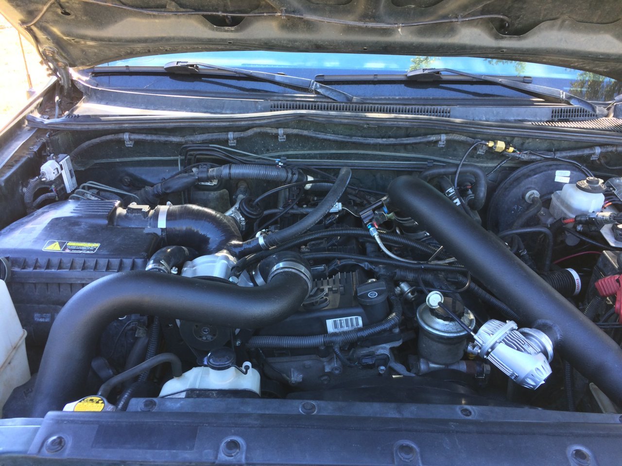

    Relocated the oil cooler under the passenger headlight and then bolted on the URD SC again yesterday. Took longer than I expected but it is running good so far!

    With a stock motor I'd stay with the stock fan clutch for reliablity, but that's just me. I've got the stock one with 270k on mine

    Blended right in. Almost couldn't see it.

    Once I paint the brackets everything will blend in pretty good!
