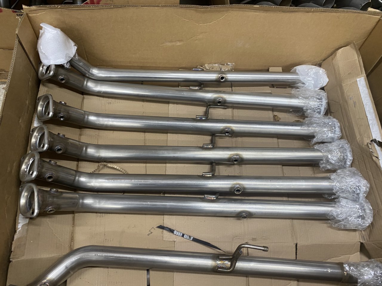

    Heard back from URD. It's a catless midpipe with an extra port for an aftermarket AFR gauge. Pic below
