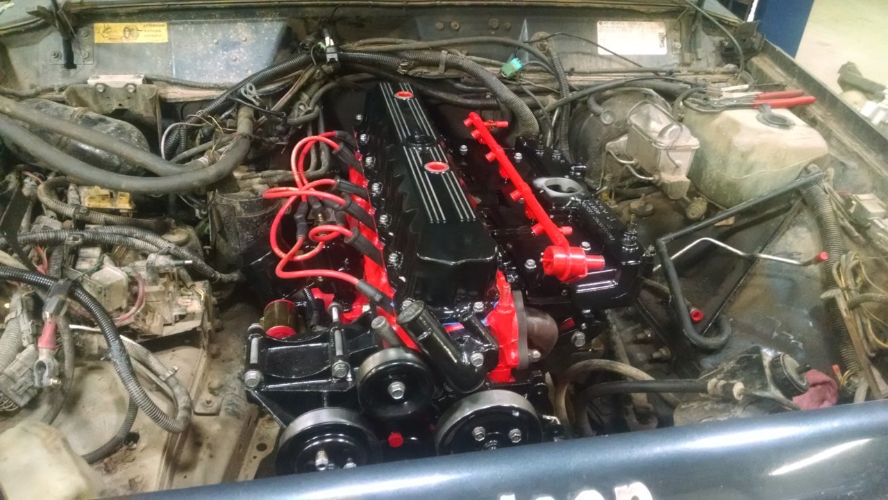

    This sounds strikingly similar to mine. 276k on the chassis on my 09 but i have a motor and trans in it with roughly 110k.

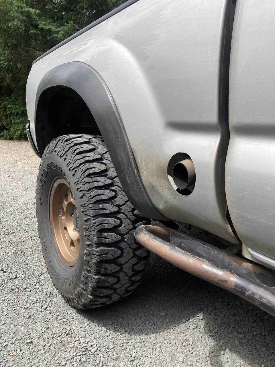

    Ahhh man murphy's law at work! Mine was self inflicted i cut the tailpipe off bc it was rubbing the bumper and then it all went down hill from there. I melted alot of the shielding and the socket for the license plate light had to be completely replaced. It also made my trailer wiring harness short out so when i hit the brakes the right turn signal would pop on. Good times :rofl:

    I love that exhaust exit! i've been wanting to do something similar. Do you have any more pics of how they routed it up through there?
