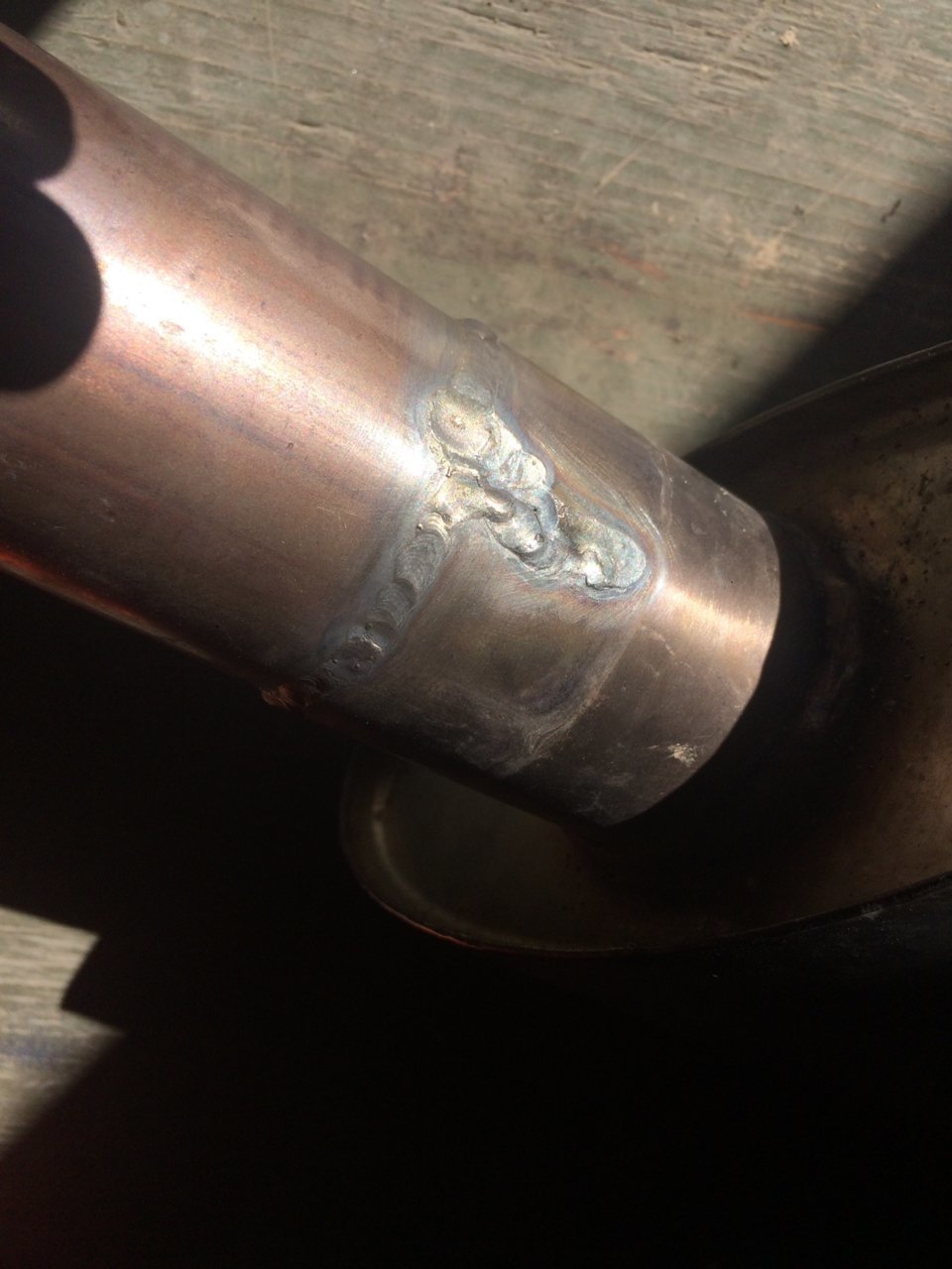

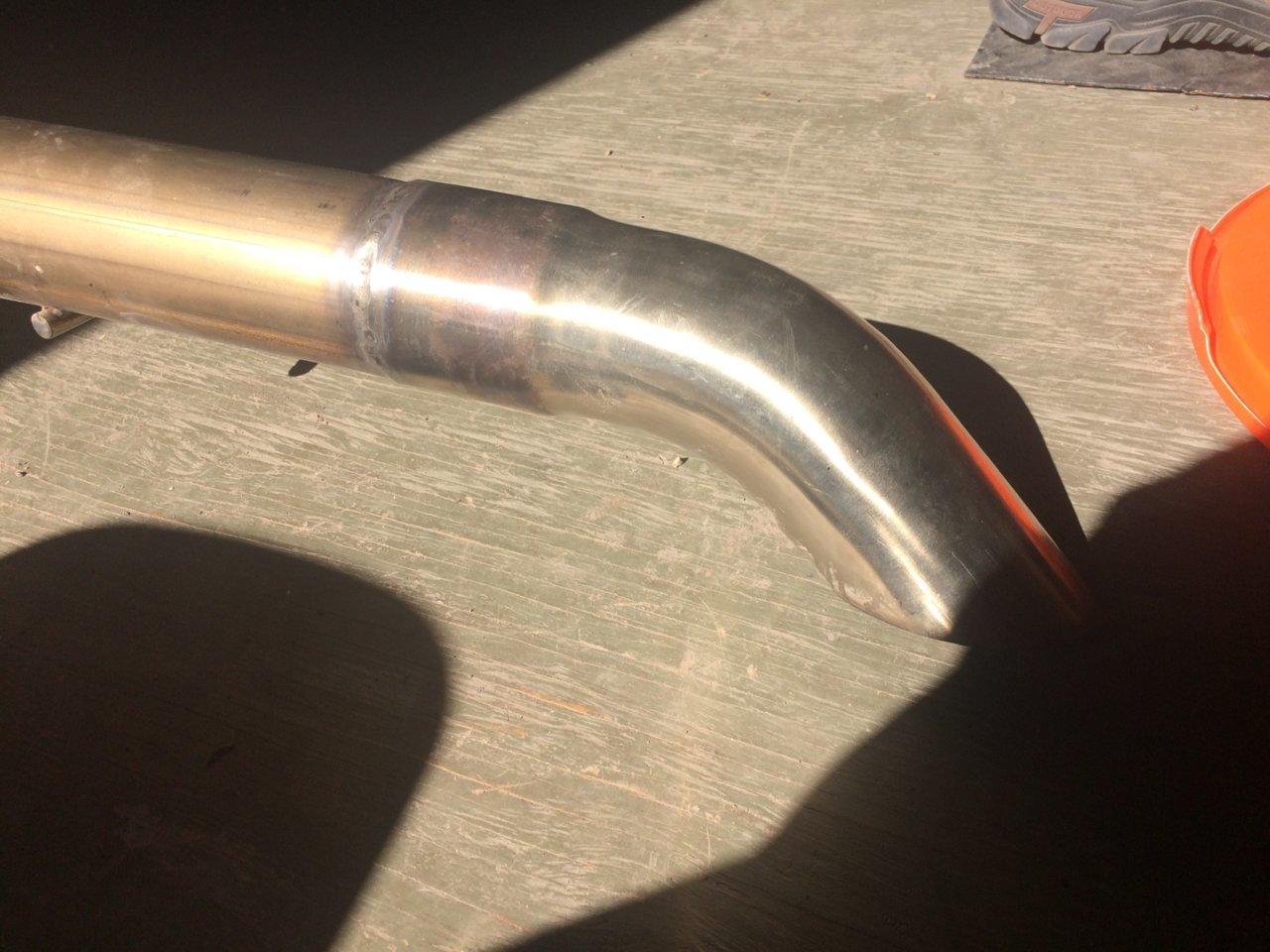

    I agree on the un-drivable part. The drone was so bad w/single muffler. And just straight up loud. The video is of the Flowmaster HP2 muffler all by itself. The tunnel doesnt help but you get the sound profile it was putting off. Also pre S/C
