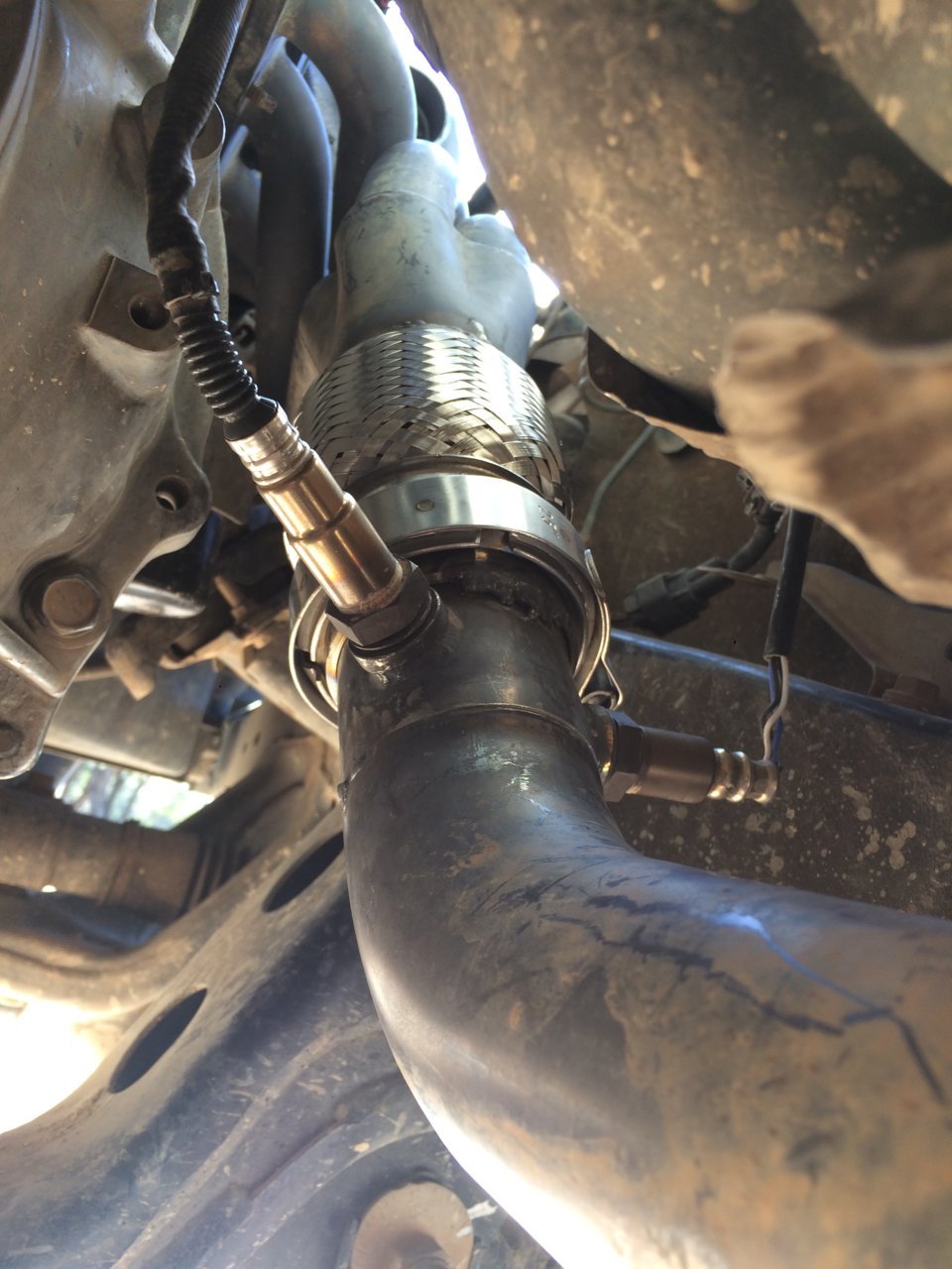

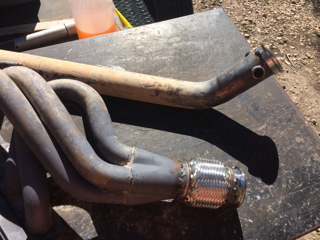

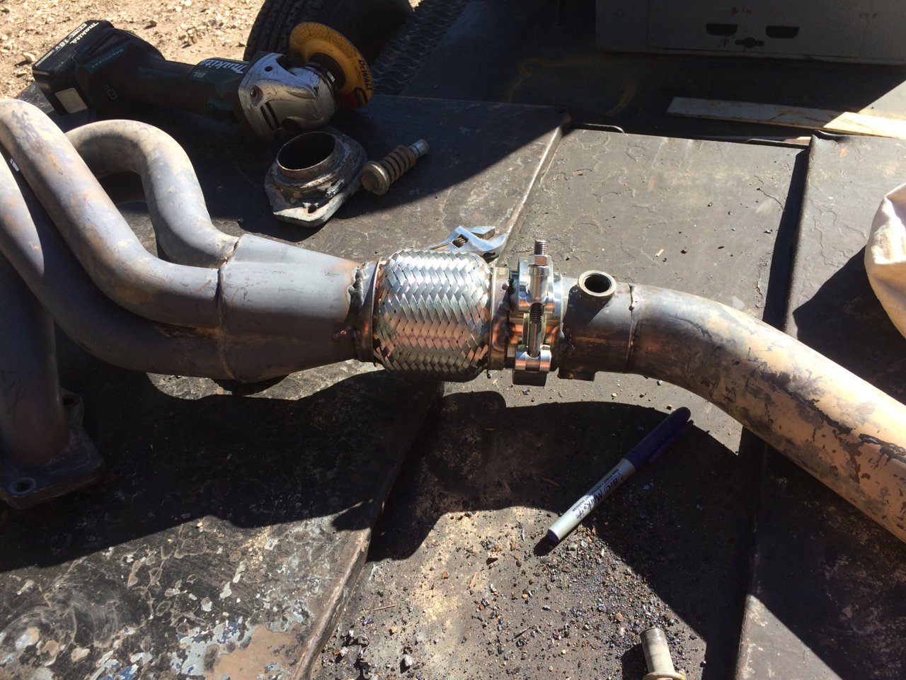

    Test fit went well, time to weld it all up

    Interesting spot to put the flex pipe, curious to see how it holds up!

    Hopefully its up to the challenge, this has been a good bit of work.
    I thought that the stock spring clamp style fitting allowed for some movement which is why i figured a flex was necessary. Looking forward to having this one wrapped up

    Bravo sir!

    You were correct in your implementation. :thumbsup:

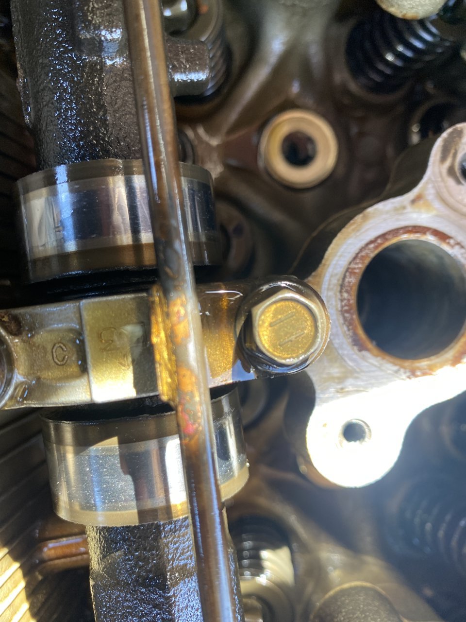

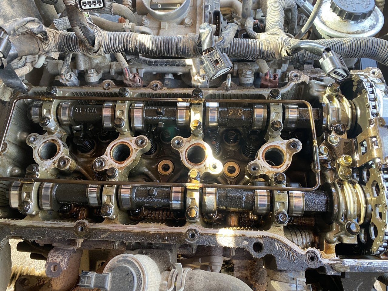

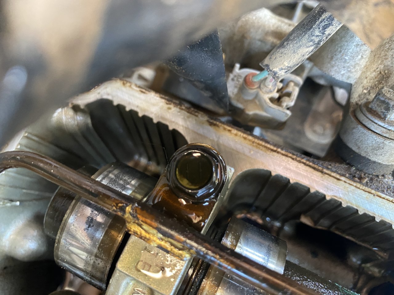

    Hey everyone, I am late to the party on the 2tr performance side. I am curious if anyone here has a guess at what psi of boost is the stock motor good for? (Not one hit, talking long term).
    This motor is coming out because I fear her life has been ended early from abuse. Not from lack of oil changes because it actually looks good, but it appears the motor has eaten a large amount of dirt and she isn’t making good noises. I am planning to rebuild it. I was planning a stock rebuild and eventually I will be putting a turbo on it. Just trying to figure how much boost I should target so I can get a properly sized turbo.
    3BB0FFF0-FECC-4C7B-8F22-8BB5E6E3AA68.jpg 78B27D32-4F33-4BDF-B9C8-35A17B830BBE.jpg
    Not sure what that dark discoloration means on the cyl 4 intake cam but cyl 4 did have the lowest compression so maybe no surprise there.A2E9D31A-1AB0-4C53-9501-18FF3D77F188.jpg
    Oooo shiny glitter!
    Edit: also wondering if you guys delete the balance shafts or just leave them alone?

    If you have access to a MIG welder or TIG welder, add some beads over theirs, at the merge.
