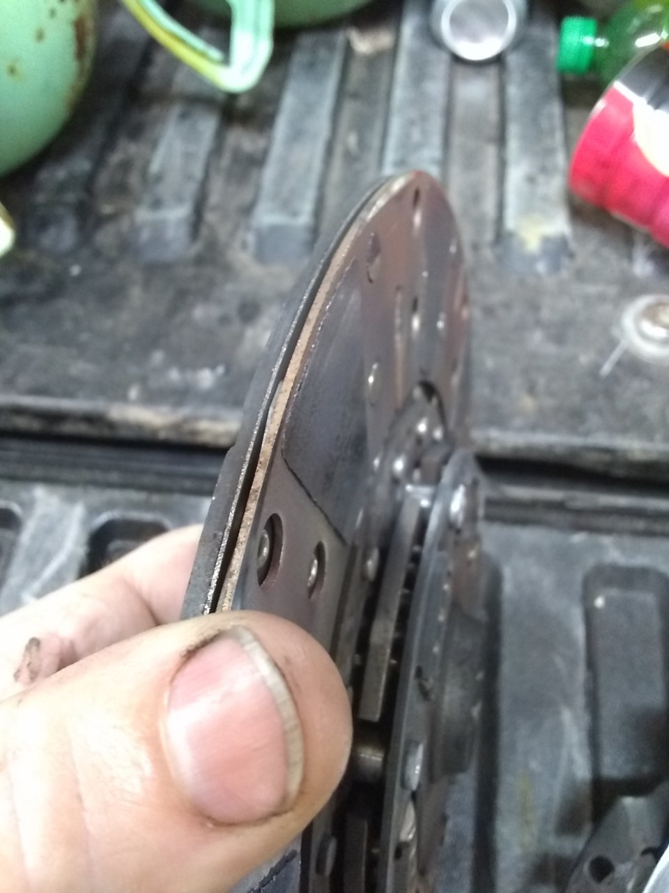

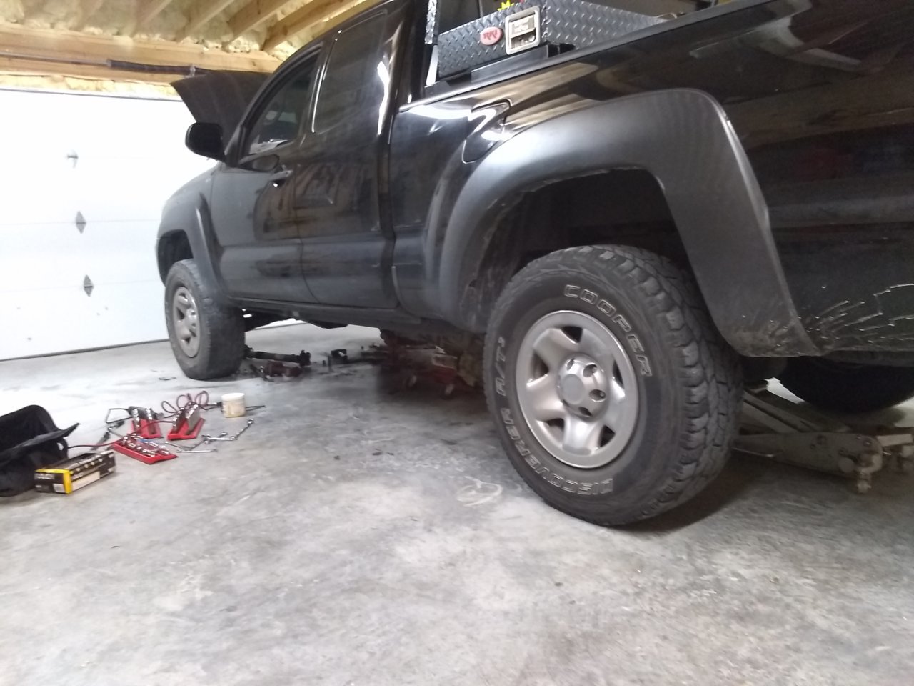

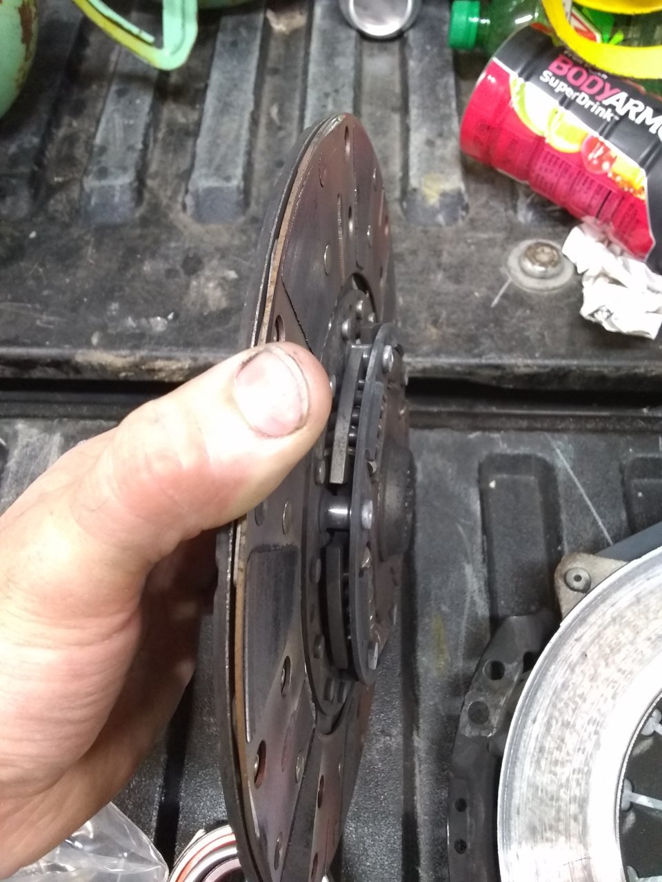

    Helped with a clutch install on my friend's 2TR, this past weekend. 2015 model. He purchased it a little over a year ago.
    Came with the URD supercharger kit, and what we found out, a Competition Clutch Stage 3 as well. With an LCE Heavy flywheel. Not sure of how many miles the kit nor clutch have on them, since there was no paperwork of installation date.
    Didn't get many pictures, unfortunately. What I did get was the disk that came out.
    IMG_20200201_185247987.jpg IMG_20200201_185310211.jpg IMG_20200201_192812_01.jpg
    If you pay close attention, the pressure plate side was nearly worn completely out. The flywheel side was not, and had ample material left.
    He had complained of having some slippage. That would be why.
