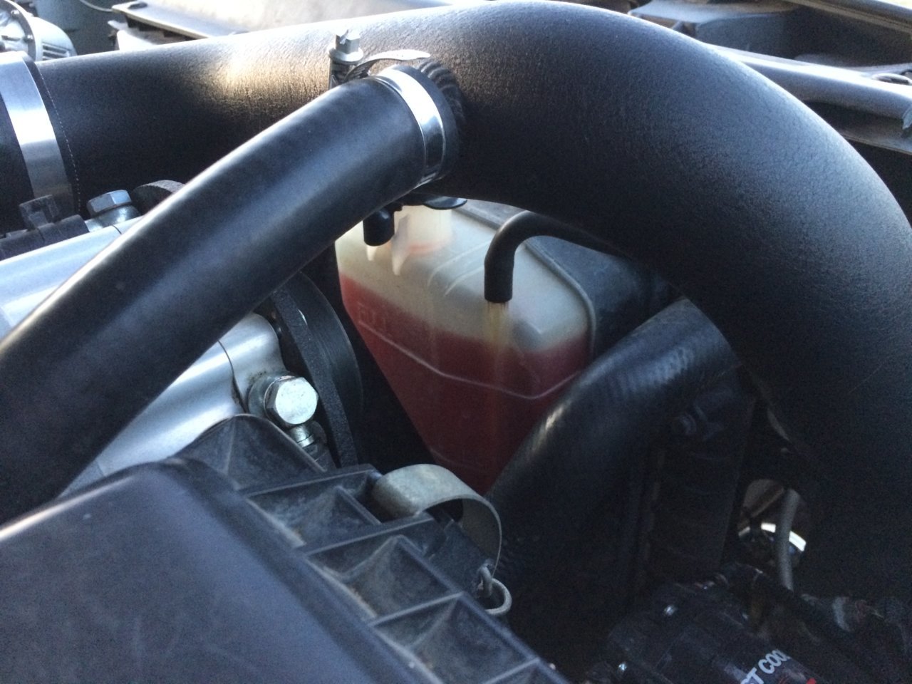

    Well here we go again

    Does anyone know if it’s alright to change the head bolts out one by one so as to not have to remove the head from the truck? I’d like to throw some ARP ones on it if possible

    I would think you'd run the risk of warping the head unfortunately. I can't say I've ever heard of somebody trying that either.

    Super common. I've done it on a few of my friends 7.3 and 6.0 diesels for that exact reason. Never had a single issue on the 6 trucks we did. Removing one bolt doesn't run the risk of warping the head. If it did, then that head was done for before the bolt swap lol

    The only thing that has me worried is the instructions say to chase the threads before install. Not sure how i'd do that with the head on the truck. Idk at this point it might we worth a gamble not to chase the threads and just throw some ARP bolts at it to see if i can get it to stop leaking.
    This happened literally 5k miles after installing the blower on my old motor. Then 5k on the new one and same thing is happening again. I am starting to think the stock head gasket/hardware doesnt like 10lbs of boost. I am disappointed to say the least. Looks like an LCE built motor might be happening sooner rather than later

    Same happened on my friend's 2TR. Once the boost was removed, no more problem. Lifting the head juuuuuuuust enough.
    His was running 11-13, until the used Rotrex blew.
    Swap them out 1 by 1. Just have to make absolutely sure the threads are clean, in the block. Acetone, brake clean, alcohol, and an air compressor to blow it all out.
    I always torque the studs to 80 in-lbs, to make sure they are uniform. Before installing the nuts.
