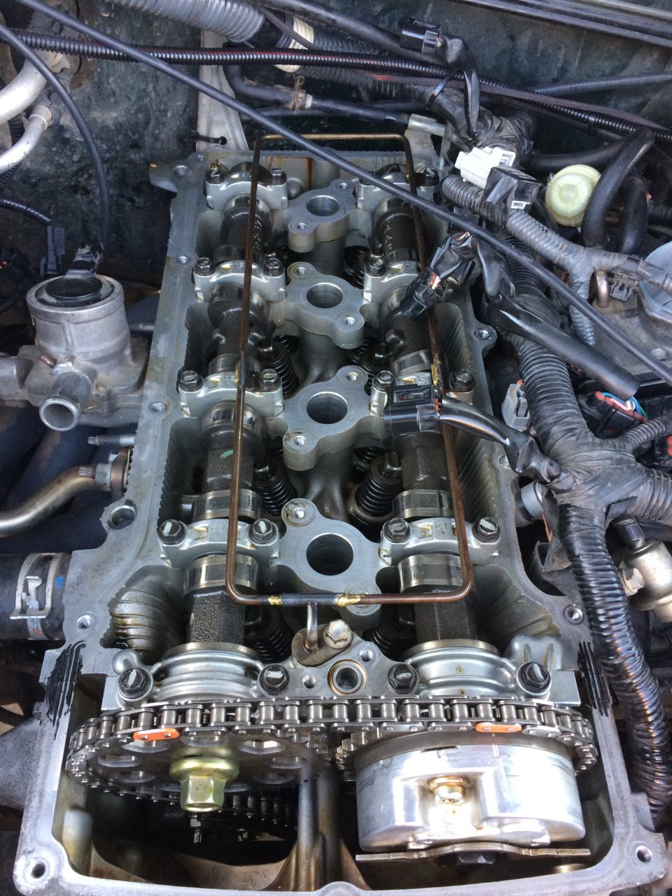

  5. Mar 7, 2021 at 5:41 PM
    #645
    BassAckwards
    BassAckwards [OP] Well-Known Member
    May 3, 2016
    #186002
    27,953
    2009 Tacoma AWD Turbo 2TR-FE
    Full-time AWD & BorgWarner EFR 6258
    Got it all put back together a little bit ago. Turned it on and all is well so it looks like i got it timed right. Timing chain & exhaust cam gear were a little tough to get on but i finally managed to get it on. Ill know tomorrow after i drive to work if its going to self heal or still puke everywhere lol
    Last pic before the phone died

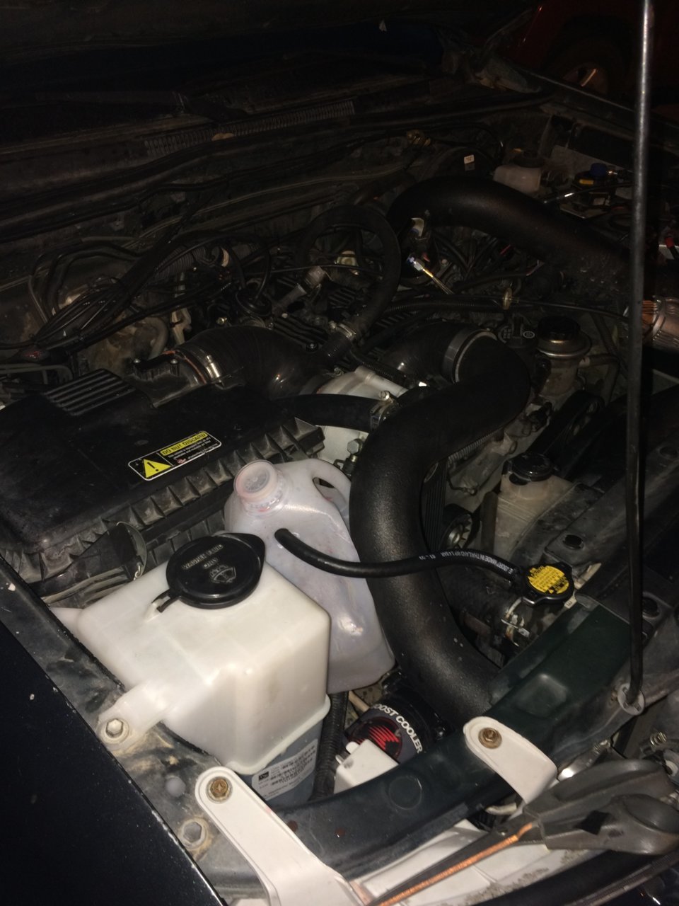

    High capacity overflow reservoir installed
    Kuntrykid, Crobran, BenMara and 3 others like this.

    Ha! Looks like when I was using an orange juice bottle to do the same. Before I made my own.
