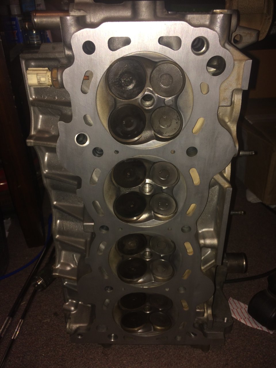

    I think toyota refers to them as “camshaft followers” but long story short theyre 15-20 bucks a pop. So i will need to pull the old motor apart to grab some.
    Got the head back today. Had it crack checked and resurfaced for a hundred bucks. Waiting on the new head gasket to get here but ive got lots to clean up in the mean time7B5544EE-1230-4C16-8245-092DA4B53308.jpg

    Man that is a high price tag. Eesh.
    At least the head was very cheap, and is in good shape. Which headgasket did you go with?

    I went with the .030" thickness Mahle gasket and had the machine shop take off .010" since the stock one was .020" so i'm hoping everything goes back together how it came apart.. Gonna be a weekend of wrenching
