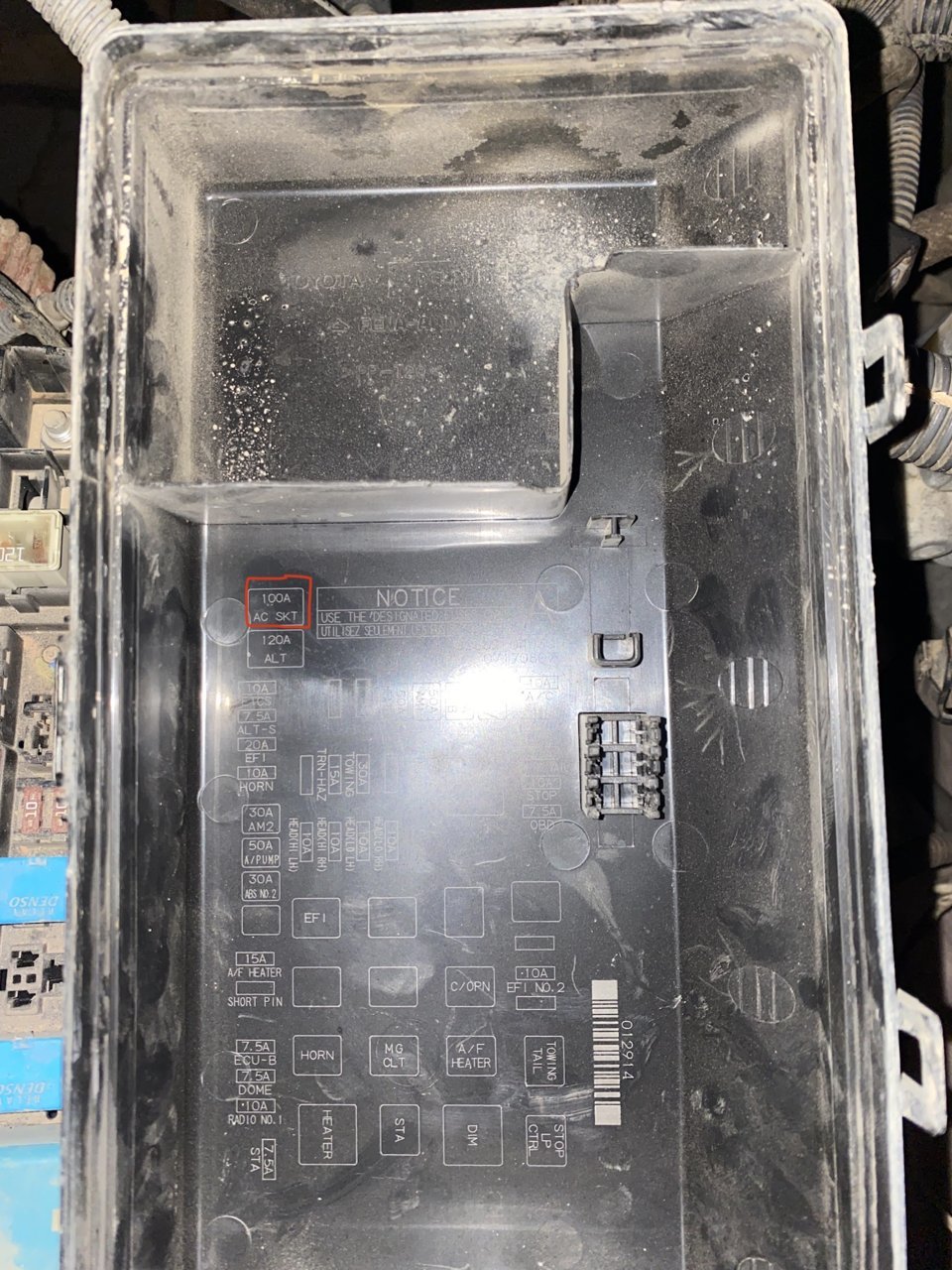

    Hey if any of you have a chance could you take a picture of your fuse box and post it please? I am trying to find out what type of fuse I am missing or if it’s normal on my truck. It appears when stuff stopped working the P/O just pulled the fuses/relays

    Under the dash or hood?

    Under hood, sorry I should have specified.

    This is the fuse I was missing how ever this truck does not have the bed power outlet which is what that slot is for. So that makes sense that it’s MIA. I finally figured out where the wiring diagrams are in TIS :anonymous:
