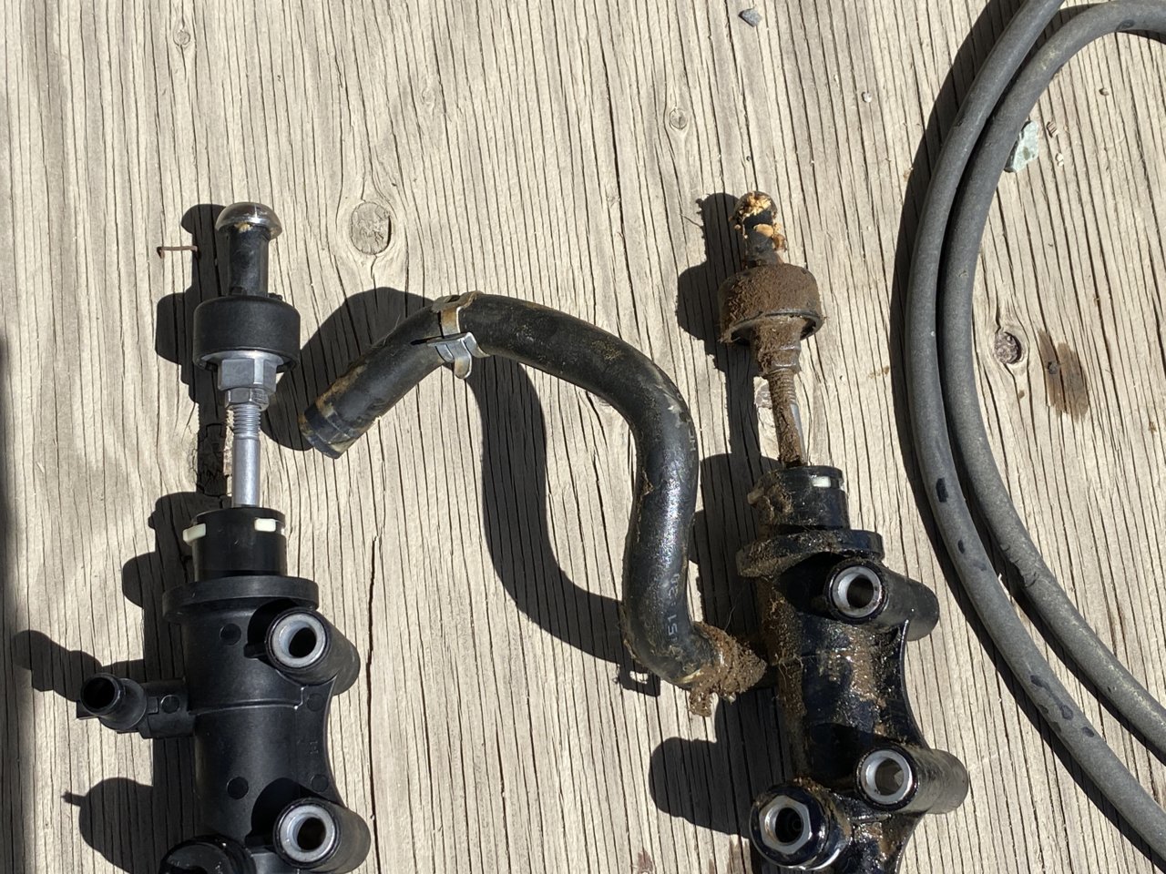

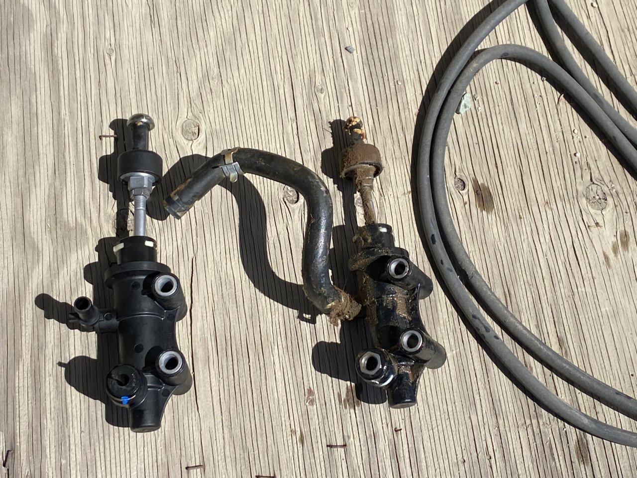

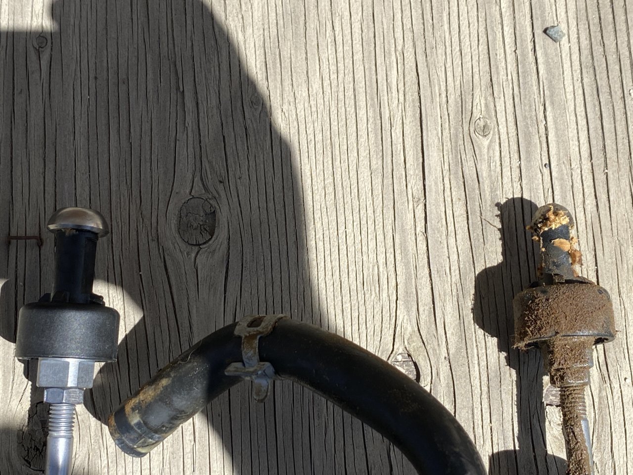

  14. Apr 9, 2021 at 5:09 PM
    #754
    Murphinator
    Murphinator Well-Known Member
    Mar 1, 2015
    #149903
    3,335
    Anthony
    SoCal
    14 DCSB 4x4
    The updated toyota part (12+) vs the stock 08 clutch master cylinder:
    As you can see the pivot point that rides on the clutch is larger, how ever it seated in fine.
    On a side note, I had to take it back to toyota. I spent all day trying to bleed the stupid pos. I didn’t want to tow my shtbox home from work so I put the old one in and it ended up bleeding fine. Hopefully the replacement I get tomorrow will bleed ok. I also got a new slave cylinder since in the middle of the day I thought maybe that was what was wrong.
    That was a nasty job trying to get the flare fitting in, I now fully understand why you switched to AN @Torspd
