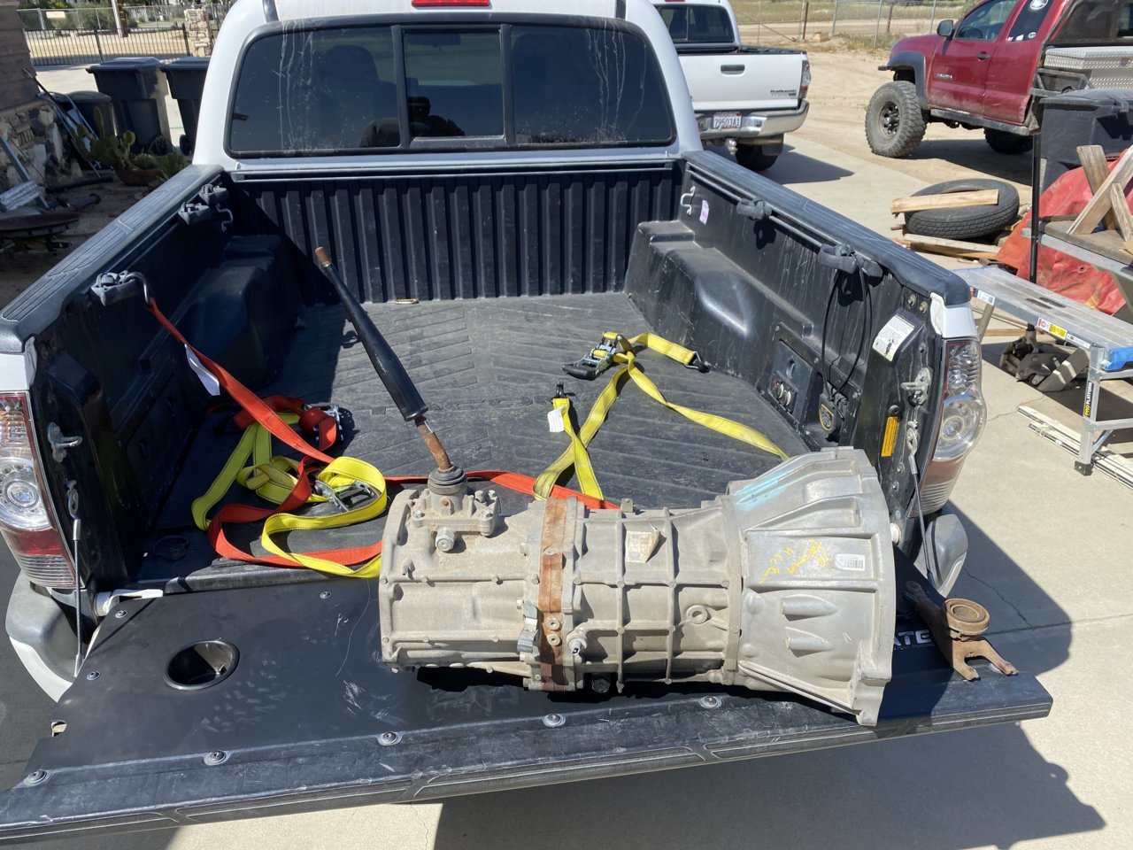

    That one came out of a 2014. Interesting, I thought the only difference between the r155 and r156 was 1st and 5th gear ratio, or did they upgrade other parts? That would make sense though since I did look and couldn't find any out of a 16 or 17.
    Hmm I think Marlin Crawler sells those shift forks. I may have to look into that, I didn't know they fit the r155.
    Also, final update on the new updated master cylinder part number. I ended up swapping the clevis. If you choose not to, you need to adjust it further onto the rod than your older style since it is longer. Another question I have to ask you guys with manuals, when you have the clutch on the floor and start pulling back when does it start to engage the clutch? I think my adjustment is off since it has to come pretty high off the floor before anything starts happening. I am happy to report the new master/slave is working much better than before. I can actually shift now and not get jerked around. Before it was like an on/off switch which I thought was just because of the lce clutch.

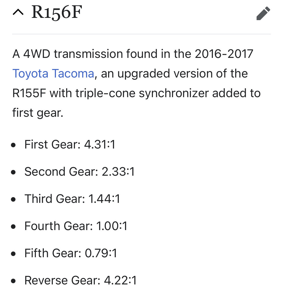

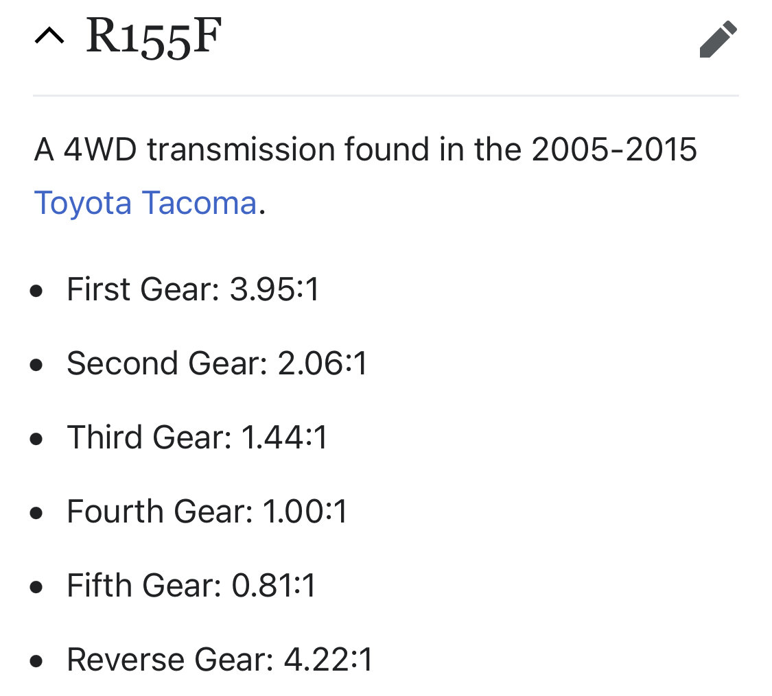

    Only thing I can find from wikipedia is this:
    So 1st and 2nd are higher gear ratios and 5th is slightly lower, and the triple syncro on 1st. I would think 1st gear would be really high for a car like the supra but I guess you may deal with it instead of paying out large $$ for the r154
