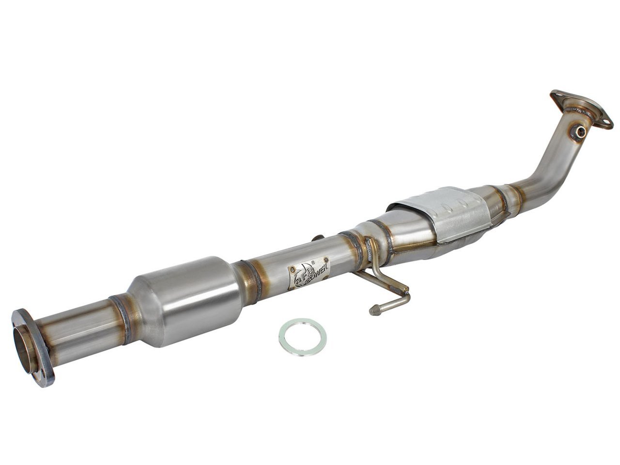

    4CBC40BC-A06C-46AB-985F-5763A14FD7C7.jpg Does anyone with the 2TR run the AFE midpipe ? I haven’t found too much discussion on it. It looks to be slightly larger in diameter but can I expect much noise if I keep a factory muffler/rear section which is my intent.
    Previous owner had the cats cut out and straight sections welded in. It sounds terrible, raspy under acceleration with some drone. CEL is lit up. I decided to buy one to compliment the LCE header I also ordered. I’m looking forward beefing up and dropping the torque curve.

    I havent but i have had my cats out for awhile before the engine scattered and i can say keeping the cats unless you plan to go full racecar is a good move. I went from the LCE header with all factory exhaust (which was super torquey) to 2.5” full mandrel bent exhaust with a resonator and muffler and the torque benefit of the header was lost with the bigger exhaust in my application. So if it was even close to a stock setup id say go for it. It will more than likely give you the torque curve your looking for.

    I’m thinking if I do have to replace the rear section I’ll go custom. The 5x9x15” (Vibrant) 2.25” is what I’m thinking. That should work better with how my 2.7 is set up.
    The AFE pro dry drop in seems to work well and I will also pick up a intake spacer soon.

    I think the 2.25” is way better than the 2.5” if your staying N/A. I noticed an immediate drop in torque upsizing the exhaust .25”
