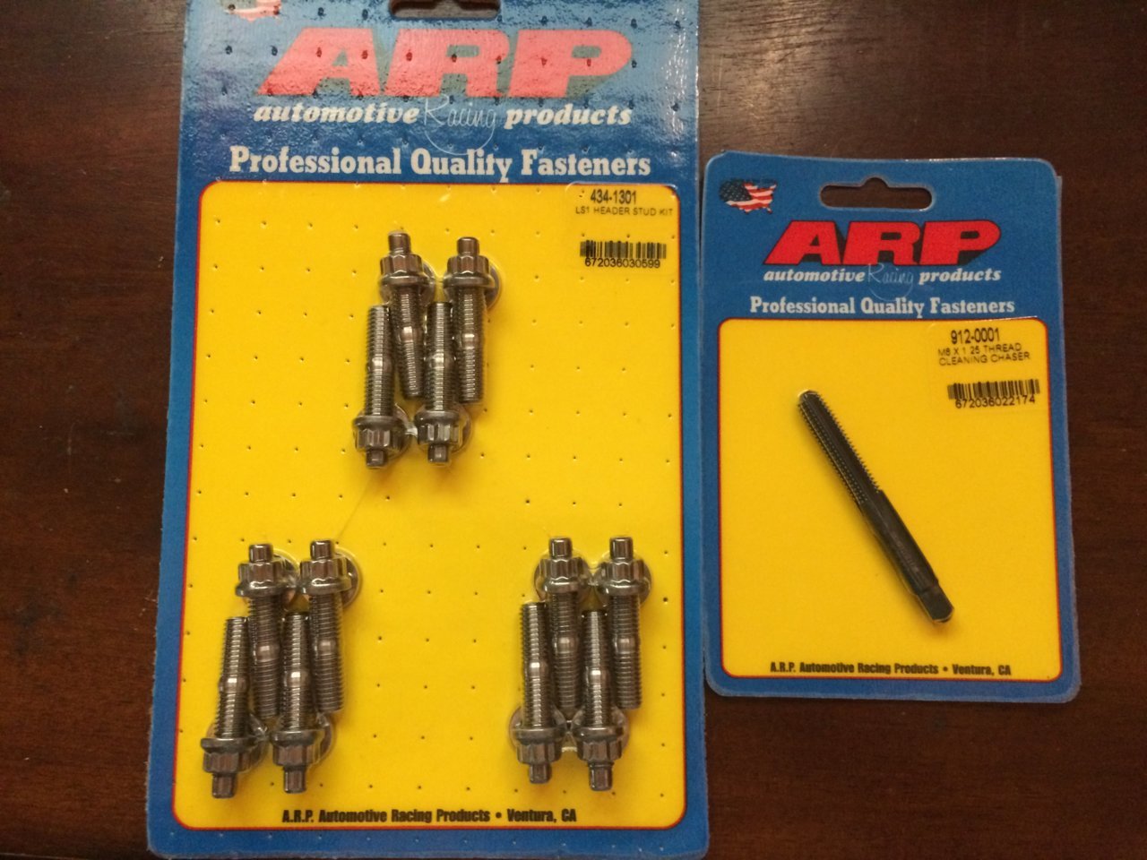

    I confirmed a few weeks back that the 2TR exhaust manifold studs are M8x1.25 so i ordered some LS1 header studs and im gonna try to install them friday. Hoping the blower doesnt have to come off to get to the front ones

    Ill keep you posted for sure. After having ARP head studs solve my HG issues, i am gonna start swapping everything i can out for ARP stuff.
    Im not a big fan of the header studs LCE offers so if this works out, it should be a nice upgrade

    Noice! Hopefully it works. I finally got some ARP main/head studs with my name on them. Just waiting for shipment
    Am i current in the understanding that the only head gasket available is the OEM Toyota head gasket?
