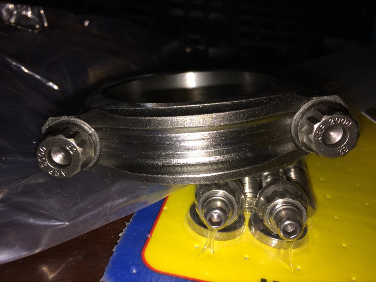

    my pauter connecting rods came with them. Heres a picF9D56D79-1266-4256-9115-F2C1712AC54B.jpg

    I wonder if they'll work in the factory rod though? Did you already put those rods in?

    No sir i can get measurements if needed, theyre sitting in my rebuild box

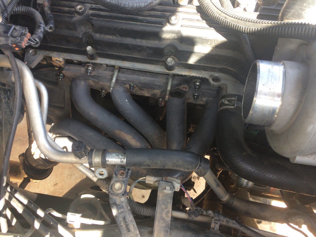

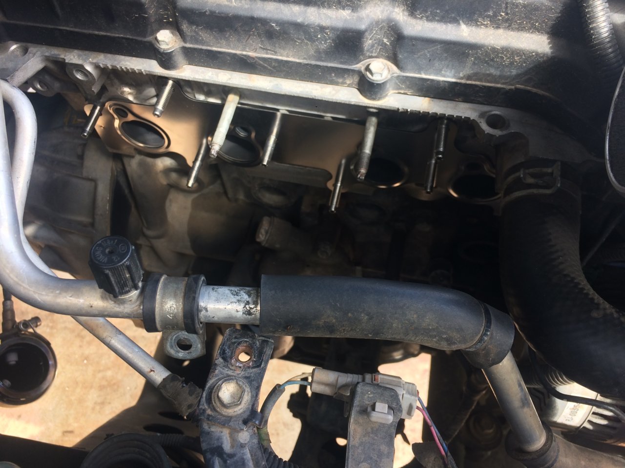

    LS1 header studs installed. They are a little longer than stock, but they worked on my 2005 motor. It looks like they bottom out before catching on the lip in the middle of the stud, but i didnt have any issues getting the header tightened down. If you buy the ARP 434-1301 header stud kit, you’ll have 4 left over as the 2TR-FE only requires 8.

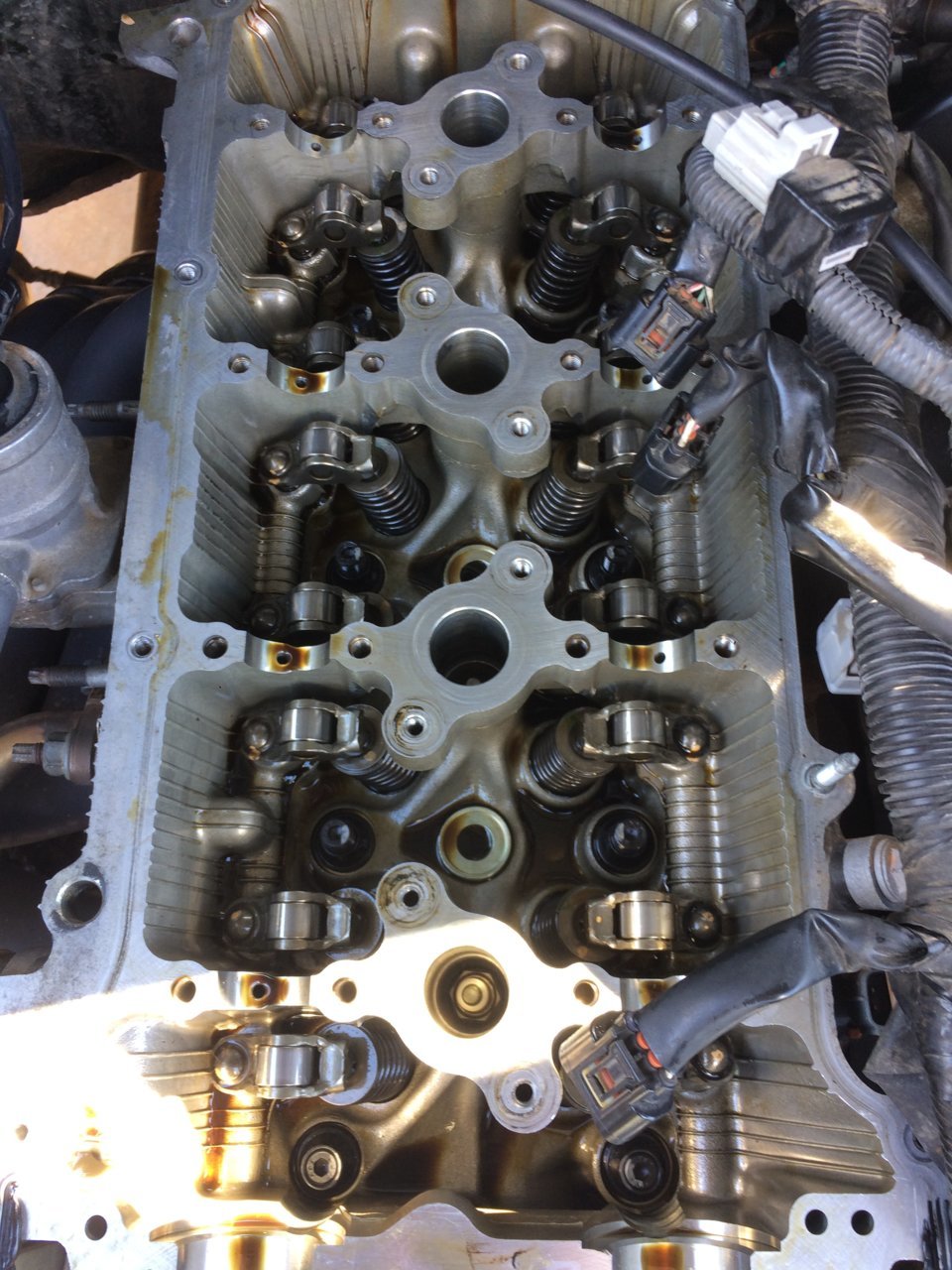

    Yes the ARP head studs are exactly the same as the 2RZ/3RZ and i bought mine through LCE. There are 8 that are the same length, and then the front 2 are slightly shorter. Heres a pic with mine installed, the instructions say to install the front two nuts flush with the top of the studs

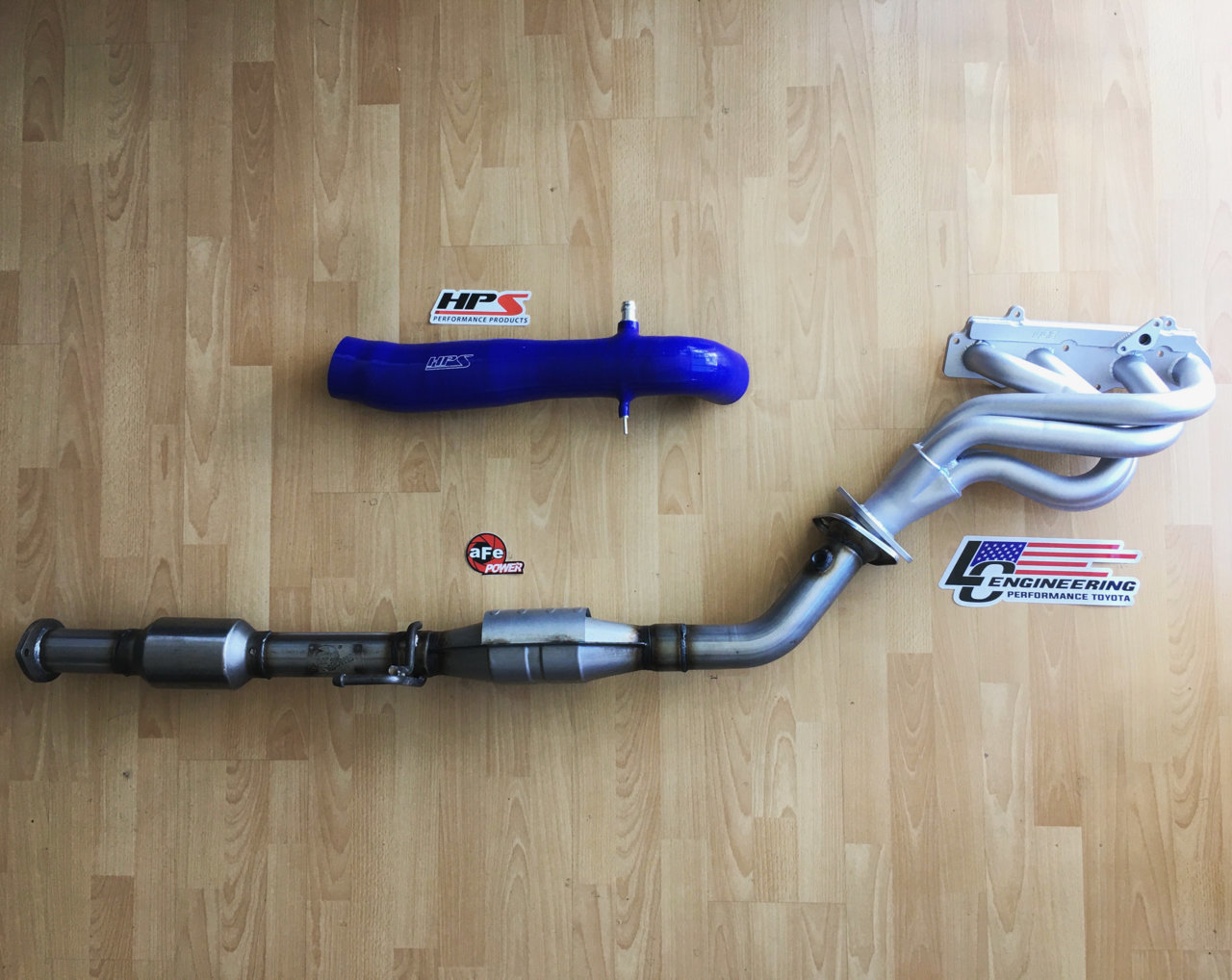

    Rays Gramlights 57s 17x9+38/245-65 Falken Wildpeak AT3/Bilstein 4600-5100/Readylift SST/Project Kics R40/LCE header/AFE mid pipe/AFE Pro Dry/HPS intake/TRD air accelerator/Tooter intake spacers/Diode Dynamics SS3 fog lamps
    Trifecta of bolt ons ready to go. Tooter intake spacer on its way… AFE Pro Dry already doin it’s thing. I wish I could experience each mod individually but it’s all going in at once

    Nice combo! Now you just need some flow matched injectors to go with it (hint, hint, check the 2nd gen for sale section). :)
