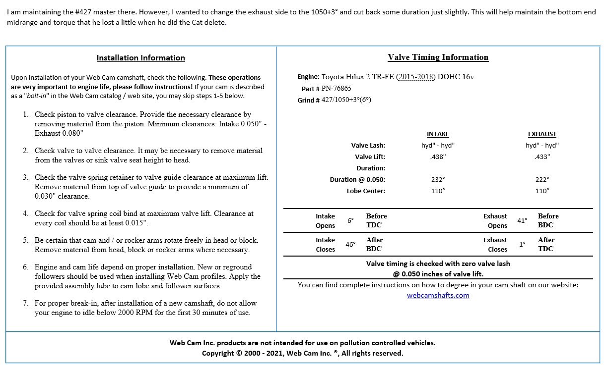

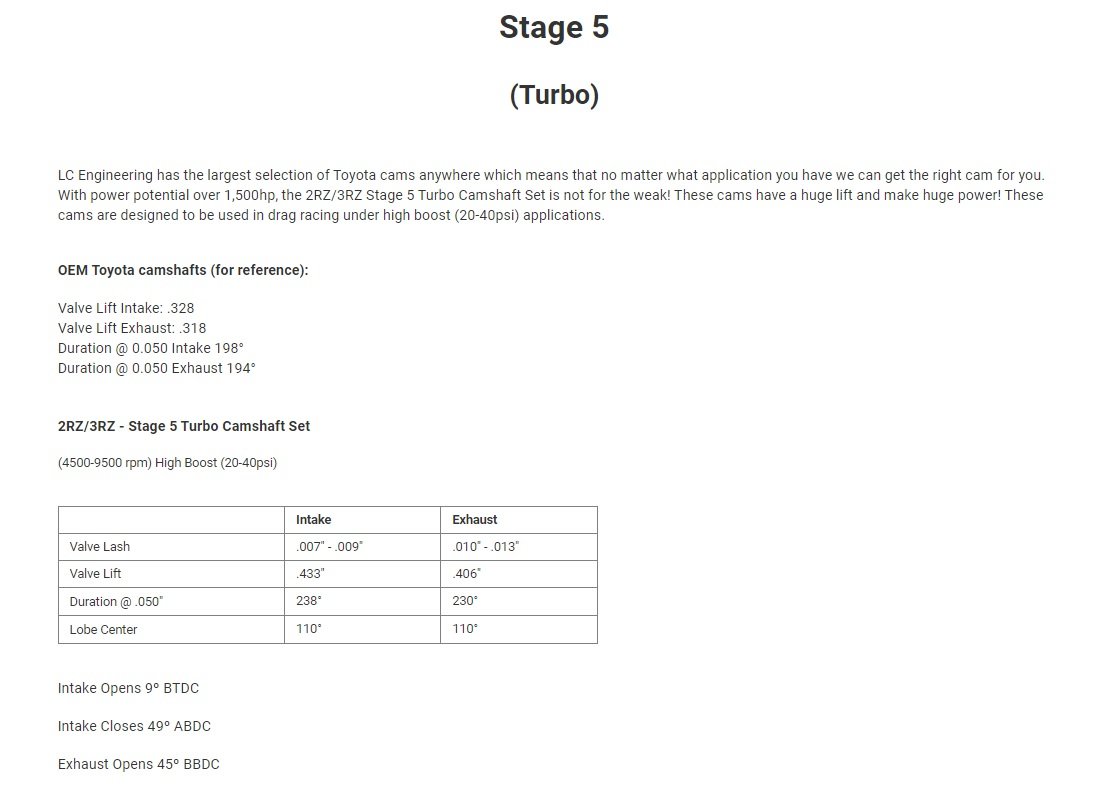

    Just in case anyone wants to see specs on the Cam from web ill attach the images. The specd cam they listed for running appx 10psi boost "supercharged" is similar to the Stage 5 Turbo RZ cam. Happily i now have my ARP head/main studs in hand and ready to be installed. Sadly i know itll still be 6 months before everything is all in one place and ready to build.
    Still waiting for verification that the stock ECU will Play nice with the new cams.
    LCE is using a company called DYNO COMP for their 2TRFE supercharger build, Dyno comp is doing something very similar to Orange virus Tuning with the OEM ecu.

    This makes me very curious to see what their profile looks like for 20+ lbs on a turbo with the LCE +1mm valves

    I believe that if there is enough injector overhead and that if the camshafts can phase without issue, then the OEM ecu will be a happy camper.
    Based off of what I have seen with my various engine size changes and operations.

    Im guessing almost identical. Im running 1mm oversized exh valve stock intake. My guess is that they add the 3degrees duration on the exhaust lobe back into the profile. You could always shoot them an email and request the cam card from web. It took about a week for web to send it to LC. But it would be nice to compare.
    What i want to see is the stock 2TR camshaft profile to compare. LCE shows the stock 2RZ/3RZ profile for comparison purposes. And they cut a lot of extra lift in. I was actually surprised how small the lift is on these cams compared to my dads 351 build, his mild cam was in the .500 range and there was availability for .600+ but thats a 2valve carb head. Who knows 2TR .433 might actually flow more than a .600 lift on old school V8 stuff.
    @Torspd i cant remember from your various builds, did you have a cam cut, do you remember the specs?
