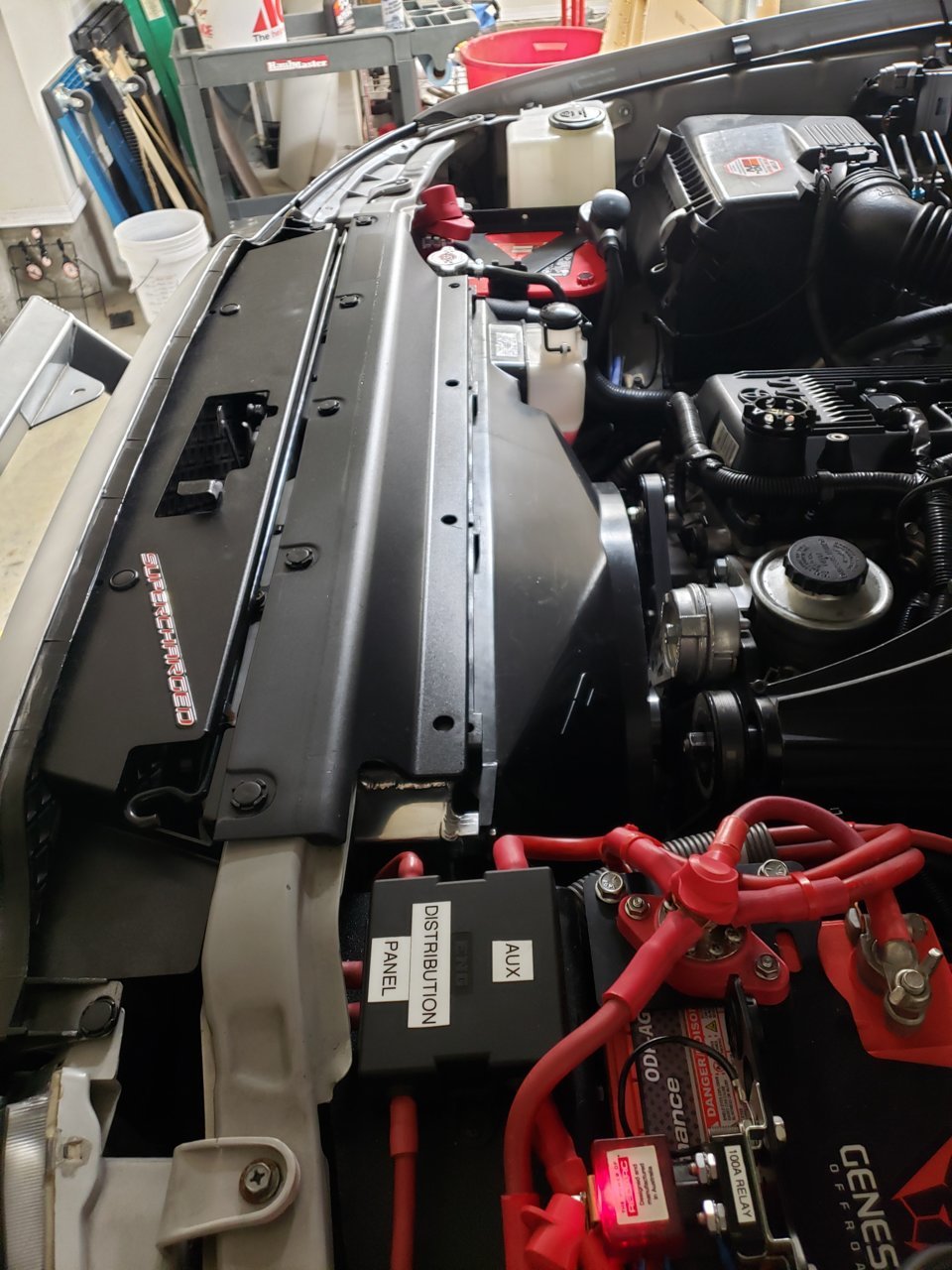

    Well I’m sure about 90% of you know what’s *hopefully* coming down the pipeline. As of 8-9-21 the truck is still at the Tuner.
    I didn’t really put the truck thru it’s paces but I did try to put it thru all types of scenarios. I’m betting they did on the Dyno. (Jesus they should have because they went thru over a half tank of fuel tuning it the first time) I mainly just did DD throttle applications. I found that the truck would stumble @ approx 4000 RPMs with steady light throttle. The tuner on the Dyno can not duplicate it but off the Dyno it rears it’s ugly head. They definitely want to get it figured out.
    One reason it’s taking so long is I told the manager of the tuning shop to take your time with it because I have another truck & I see you’re swamped with high dollar vehicles. I told him I can only Imagine how some of these owners must get if there vehicles aren’t done in time. He was very appreciative.
    @Silver_Back was the very first but his truck had electrical gremlins. So the tuner didn’t want to copy the tune. I’m pretty sure that’s why the LCE GM wanted my truck. When I told the LCE GM what I had just purchased. An unmolested 07 w/ 27k, Reg cab 5 lug w/ a stick. “He said don’t touch it I want it?” I knew about the development of the new system so I volunteered the 07 as a Guinea pig.

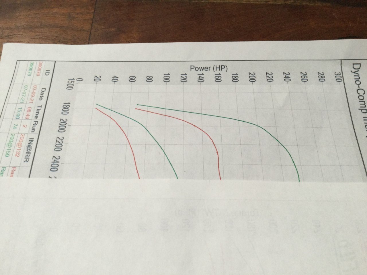

    Does or has anyone seen a Dyno of the base Rotrex system on a stock truck? We are thinking that the Rotrex with the massive intercooler is going to put out more Peak HP. Owning both I will say the Magnuson comes on a lot more linear. The torque fills like it comes on sooner. The truck that had the Rotrex had a LCE header, the 2nd cat was deleted and replaced w/ an 5 x 8 x 14 Magnaflow (for sound) w/ a 5 x 11 x 22 Magnaflow & 2.5” out the OE location. The biggest thing was the gear swap from 3.31 to 3.73 w/ 28.5” rubber. @ 70 mph I’m running an 150 more RPMs.Other then the FI and StopTech’s gears are the best bang for the buck.
    Here’s a teaser for the Magnuson and remember this on a unmolested stock truck.

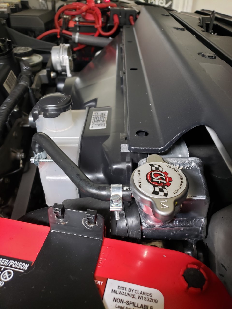

    Far as cooling for our baby motors; I know LCE offered a fan and radiator setup not too long ago, all I see know is the flex fan on their site. Been roughly a year-ish since I saw the whole kit.
    Anyone know what changed that? Can they not source the rad or was it deemed poo poo?

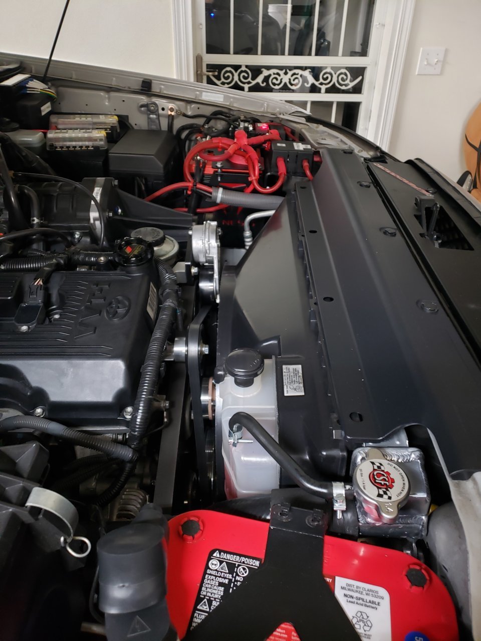

    You don’t need a bigger radiator and if you have over heating issues there’s something else wrong! Here’s a big radiator below. I’m still thinking about having an 5.3 or LS1 swap. The tuner finally concord the Toyota ECU for the Magnuson supercharger system on my 2TR. The bypass valve was acting up causing all kinds of issues for the tuner. Magnuson keeps pushing back the date to the vendor for the superchargers…
    Part No: CSF #7092 Year(s): 2005 – 2015 (2.7L & 4.0L)

    CFS makes a direct replacement for the 2TR-FE radiator and I can confirm it works with the LCE's kit. Due to the CFS radiator being closer to the engine, the top radiator cover's fasteners don't align but that's not the end of the world.

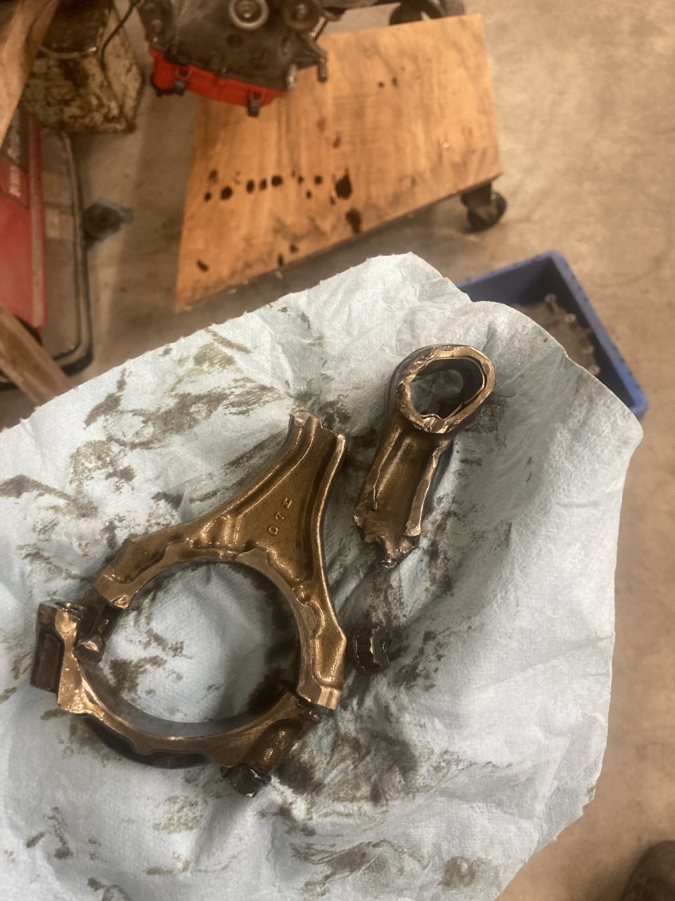

    Found it lol. This gents is what happens to a stock rod with 9 ish pounds of boost on a dead pull. No signs of oil loss or starvation. No sign of detonation on the face of the piston, legit straight up rod failure. No other rods were harmed in the making of this party favor. My guess is the rod was on the verge power wise and it had a small inclusion in the casting

    Was this on your engine? What turbo setup? Have any pictures?
    How badly damaged is the block?

    This is my personal truck. This is the Rotrex kit with 80mm pulley. Block is toast, part of it i never found. Appx 2”x 6” chunk of the cast block is missing under the drivers side engine mount. It also took out the mid pan the same 6-8” window and bent the oil pan lip. Other than the one spot the block looked ok. Still not 100% tore down. The wrist pin is apparenty on the hwy where it blew up. Its MIA. The piston was pushed down by the boost and tried to go into the meat grinder(crank) which ground all the skirts and bottom side off leaving only the top casting of the piston.
