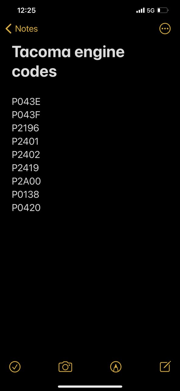

    Mightve forced my hand with haltech. Due to me not giving a shit, got rid everything evap and sais and now boom. Trucks not happy lol. Fucker starts sounds mint for a few seconds and then she shuts off. Ive been debating to go to haltech for awhile now. If anybody has any ideas due to me having to

    I have one of those im going to install it and see if that helps out. Im thinking its the evap circuits thats open causing this issue. I have a p0453 and a p0418 code( evap and sais) i the ecu controls the ground for the fuel pump and its not wanting to give me fuel. Bypassed it and got it running, but the ecu is telling me not today motherfucker.

    lol hosed bro, hopefully the trash isnt dumped yet. Im betting itll take a month or so to round up the conversion harness and ecm, wite
    my truck ran fine but threw a fault with sais disconnected. Id totally believe the evap will shut you down. It senses tank pressure and unplugged it may default to thinking it has an unsafe level of tank back pressure or vacuum making fuel injection unstable. Worse case id plug it all back in and run with the evap until you get the haltech. Or at least the sensors and zip ty it somewhere, if trash day didnt already happen

    Out of all the evap/emissions codes my truck has, those two aren't on the list yet... 5B0E86D9-73A9-4A93-AA1F-7AF963BC5D26.jpg

    Yeah if i didnt have bad luck i wouldnt have any luck lol. Like @Torspd said the hewlitt. I think its more toward the evap issue. Canister? Who needs a canister? Well this guy does. Sssssooooooo going to try the hewlitt, and then haltech probably

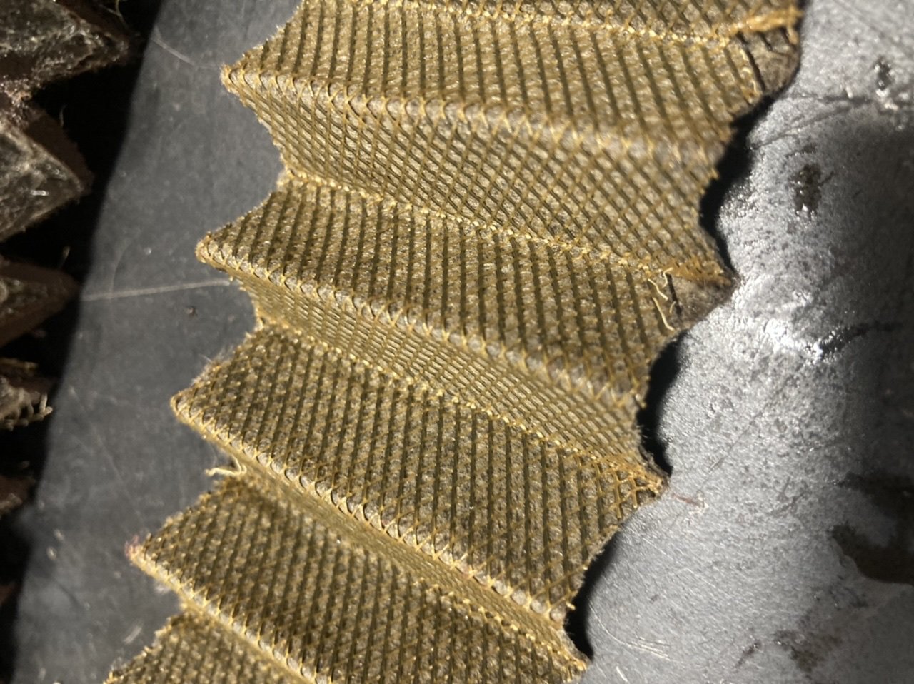

    7D78DE5B-96E6-4619-83DD-5605D725B221.jpg 0ED45E7A-8066-4052-9F78-4D7137755C88.jpg D998F16B-EE23-41EE-8D78-A87DCBC39BEB.jpg EE48DAFA-719F-4E3E-B802-8DE89F4BD39C.jpg 178118D8-982C-4E7D-A7F0-2EAFFC57C8D3.jpg Good news and bad news… dove a little deeper and cut open the oil filter that was installed during the failure. Im a life long WIX fan and it really was a high quality filter on teardown but i suspect it may not be the best option for a high performance build. Which leaves me wondering what oil filter should be used. filter pictured is a 51348XP. No particles made it through the element however this model is equipped with a bypass valve in the bottom and the element is very small! It is totally possible for particles settled in the bottom of the filter to get sucked through the bypass when the oil is cold. The metal shavings and debris on the rag were all in the bottom of the canister near the bypass valve. Only reason to bring this up is the number one main bearing and the number one rod both had debris embedded. Either it was assembled like that from the factory or these WIX bypass filters are flowing sediment in certain conditions. I disassembled the valve to make sure it wasnt stuck open with debris. Not the case. Definitely need a quality filter with a larger element and no internal bypass.

    The canister is a filter, id think you could limp it by just finding the sensors. It will atill throw pressure related codes due being exposed to open air. It logs the pressure reading and then opens a solenoid valve to purge the excess pressure into the intake to cause a neutral tank pressure. It wont see a drop or elevation in pressure which will more than likely cause a fault. But should still run fine. It routinely runs a evap test cycle monitor everytime you start the truck

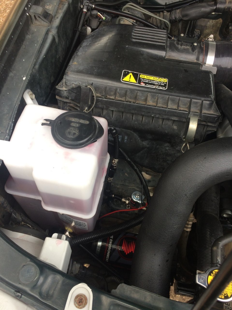

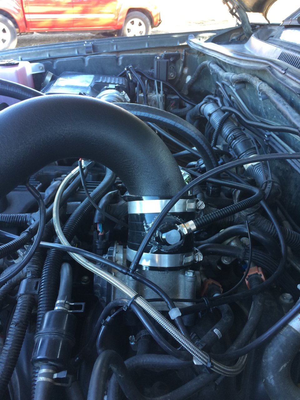

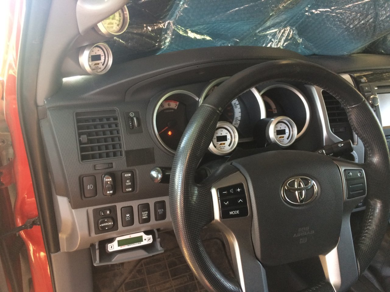

    Yes I’m running the snow stage 3 kit on my truck. I like it a lot, gives me some peace of mind. I used the stock washer reservoir and I stuck the controller in the coin tray on the driver side. The last pic is from my other truck but that’s where the controller is for reference

    @BassAckwards
    Thanks! I have a lot of questions (Sorry!)
    May I ask if you know how much the washer reservoir holds and have any idea how much fluid it uses? I was thinking the exact same thing!
    Does it evaporate any with the meth in the tank? It’s pretty Damn hot & dry here in AZ. 9-14-21 it was only 108 yesterday but we missed last year’s record of 109 for the date… But the overnight lows are sweet just in low 80’s. And yes that’s nice compared to the 115+ just about a month ago.
    Running it off the boost or RPMs? I was thinking / guessing about having it engage at a set boost level…6lbs?
    Using a braided line or the nylon? Being you have it covered in loom I’m guessing nylon?
    Love the controller in the coin tray! Being I don’t know the size of the controller did you have to modify the tray any and how’s the wiring for a guy who hates wiring.
    The tuner said he want to set it up on the Dyno.
    Again THANKS for any advice you can pass on to a dumb shit.
