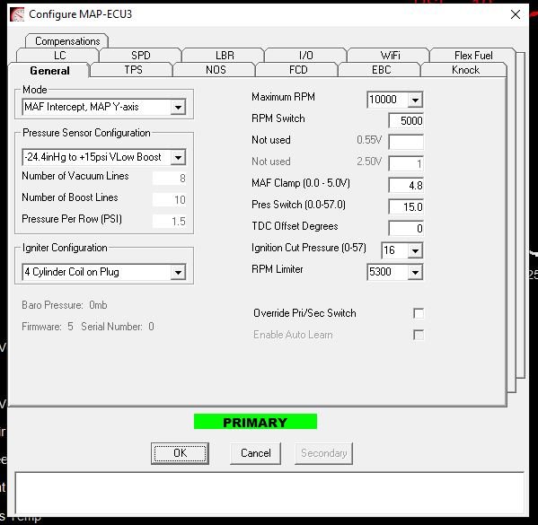

    What's our crank Trigger offset? Im jumping back into tuning and apparently that was the next thing I needed to get my motor started.
    Any info would be helpful!
  19. Jan 15, 2022 at 8:18 PM
    #1139
    BassAckwards
    BassAckwards [OP] Well-Known Member
    May 3, 2016
    #186002
    27,900
    2009 Tacoma AWD Turbo 2TR-FE
    Full-time AWD & BorgWarner EFR 6258
    Here's a screen shot from the tune on my MAPECU3. If the TDC offset degrees is what you're referring to, it looks like zero on mine.

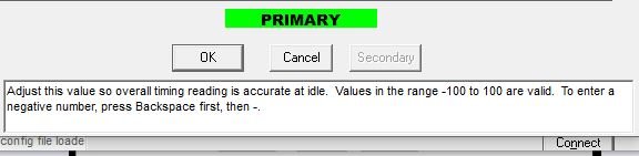

    Here's the description it gives
