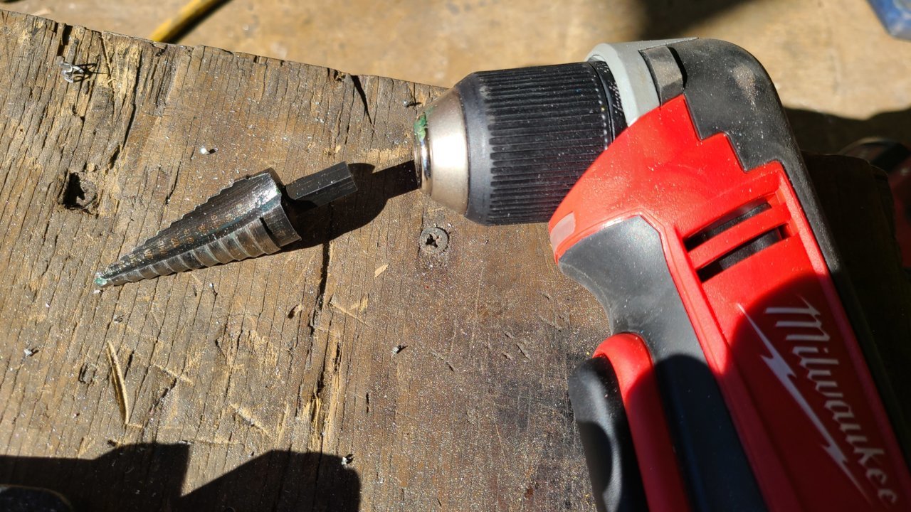

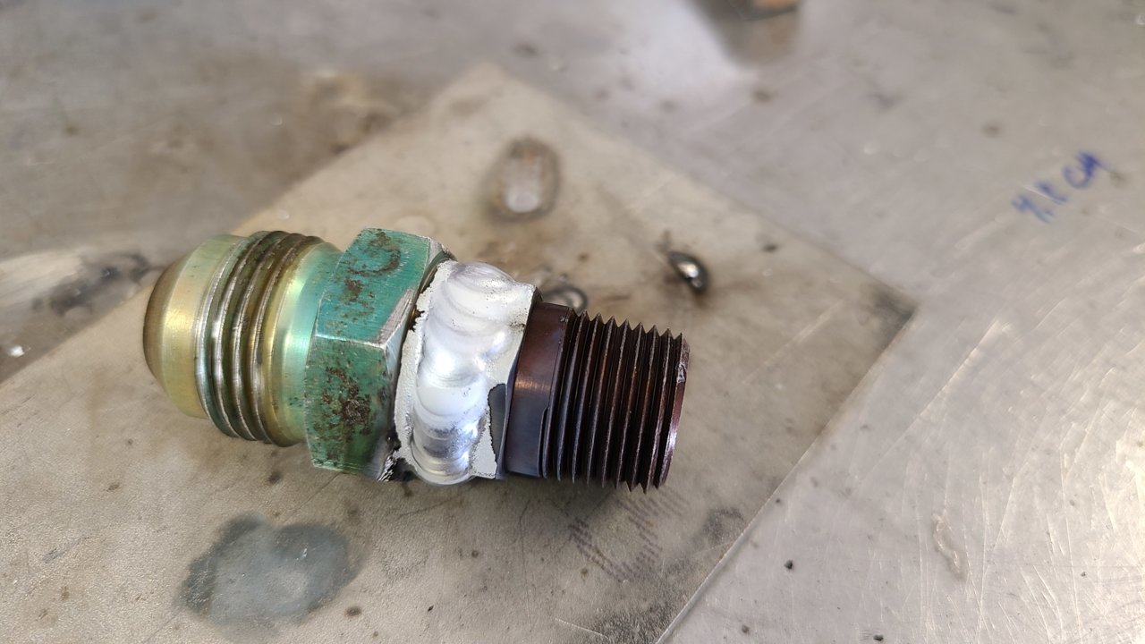

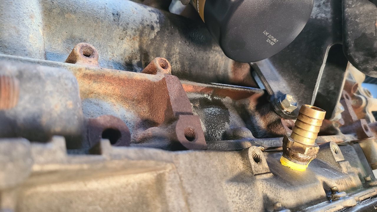

    For those doing a 2TR-FE turbo build. This is the easiest method of getting the oil drain fitting installed.
    A 90° drill, into the aluminum upper oil pan. In the sloped portion. Use a stepper bit. Going to the 9/16 step. No larger. Mark that section,, so you know where to stop. Then use the 3/8 NPT tap to cut your threads. Carefully. I put grease in the flutes of both the drill bit, and the tap. To reduce the amount of shavings that go into the block.
    This is for a -10AN to 3/8 NPT fitting. I also drilled out the tighter portion of the 3/8 section, to match that of the -10AN portion.
    *The brass fitting is going to be swapped with the AN fitting.*
    We didn't have a -10AN to 3/8 NPT fitting, so we made one. :welder:

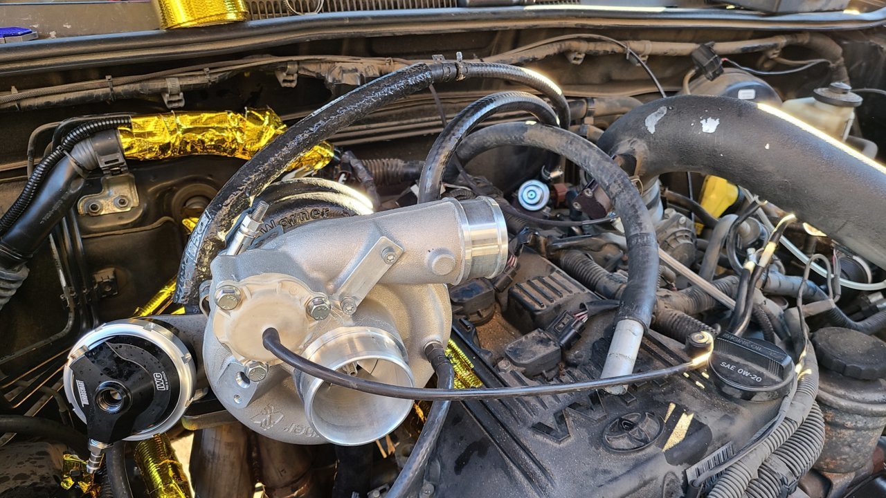

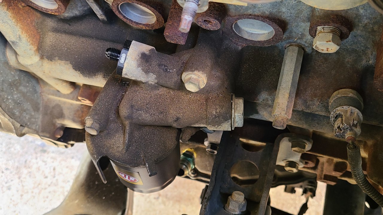

    Setrab M22 to -4AN feed (compliments of @BassAckwards) and routing.

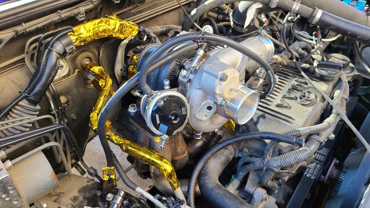

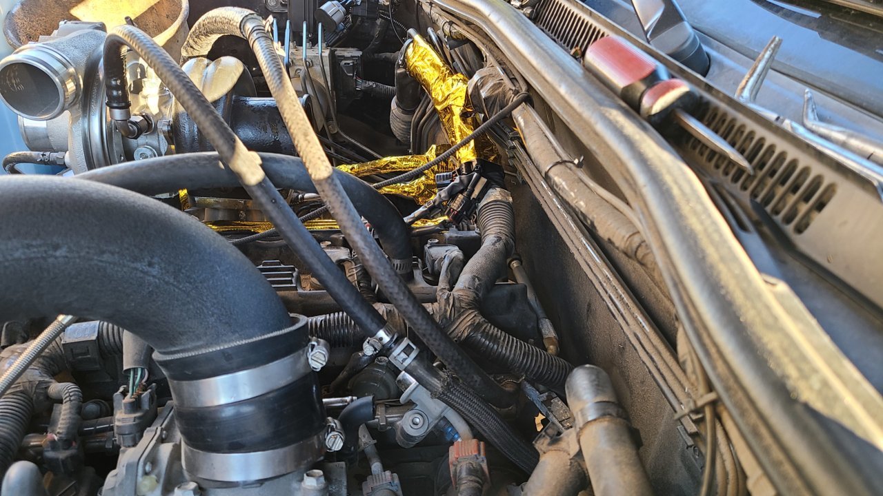

    Routing checks for the coolant and drain lines, as well as vacuum hoses.

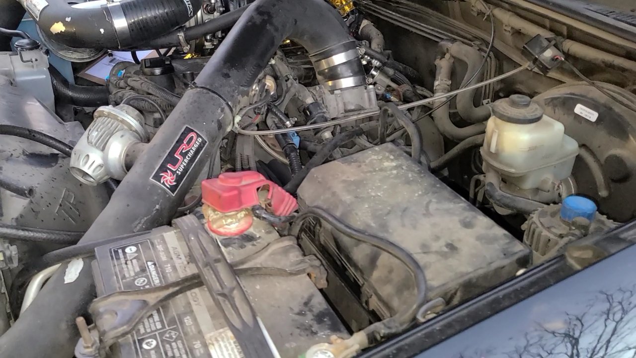

    In the photo above, the plastic wiring harness securing clamp, was flipped 180°, to locate the harness that much higher, and give a greater air gap between it and the down-pipe's heat.

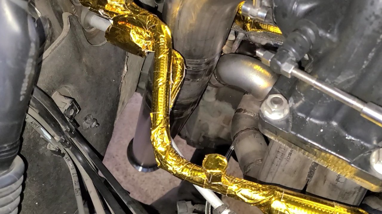

    Coolant hoses routing.

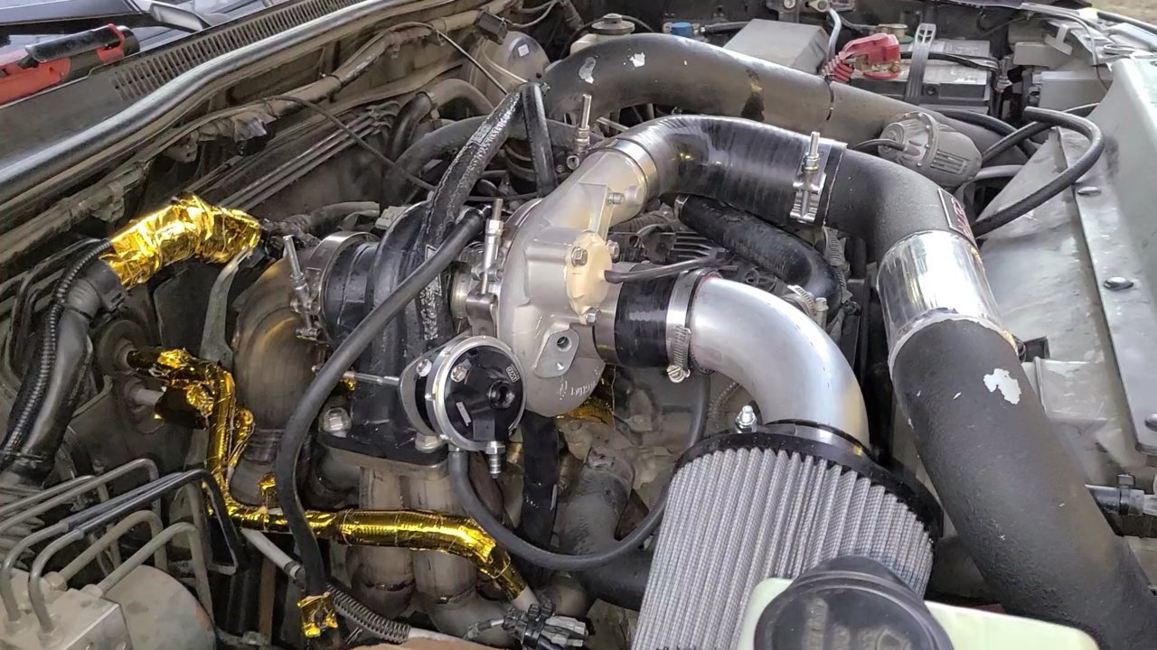

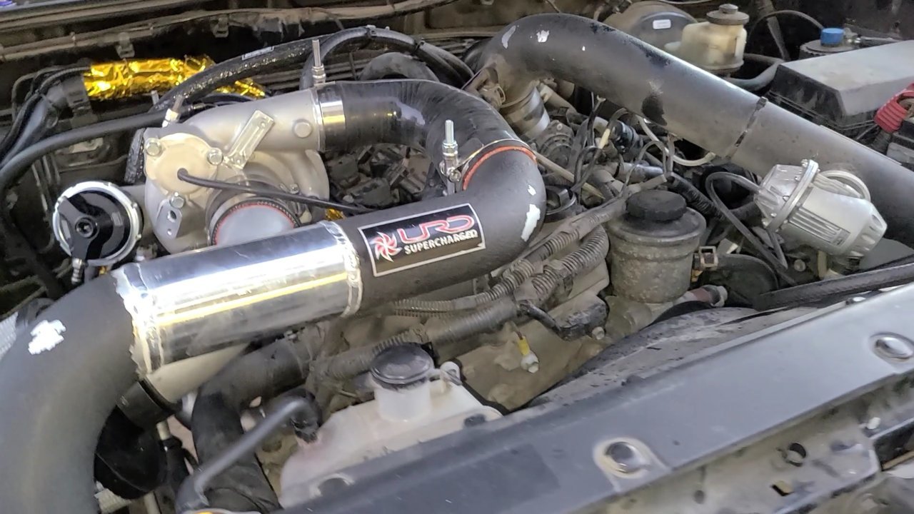

    Some more pictures of the project, prior to tying in of the exhaust.
    Had a start-up video. With the open down-pipe. Didn't take long to start having a rough idle. With no OEM WRAF sensor installed, and a massive vacuum leak from a broken hose. Working on those videos. :D
